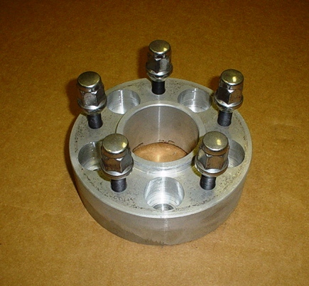

Each problem has its own solution, and its own critics! I needed a thick spacer on peg drive wheels where the car regularly changed to different wheels for different purposes. My solution is shown attached, and works very well indeed, it is secure and quick to change without compromising the original hub pegs. Frank

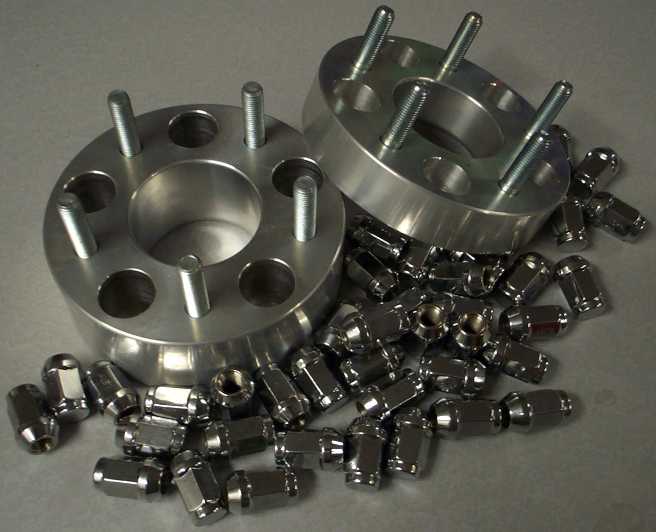

I agree with Don'w comments. In the race paddock cars are commonly have spacers. Longer replacement studs are the order of the day but most spacers are not the nice hub centric spacers built for the purpose.

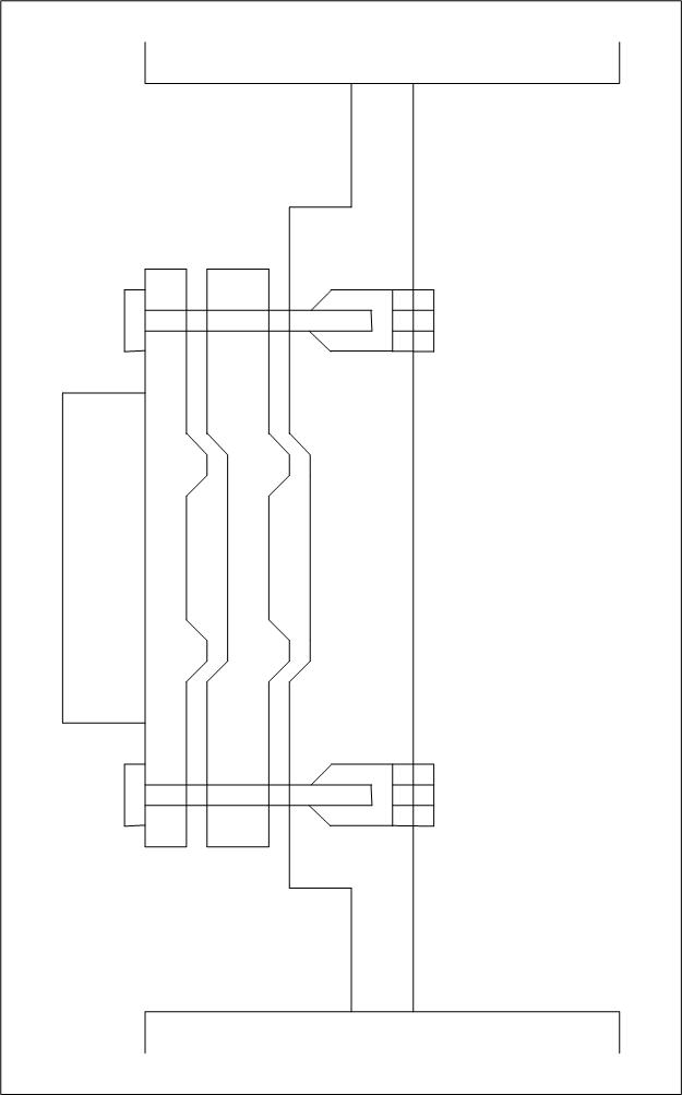

While I do agree the spacer should be made as much a part of the hub as possible, like with Frank's example, I wouldn't be scared a bit of running some thin, 1/2" or less, wheel spacers that are not like that. I run some 1/2" skeleton type spacers on my Z and it has been fine for years. Longer studs make sure I have plenty of nut engagement.
