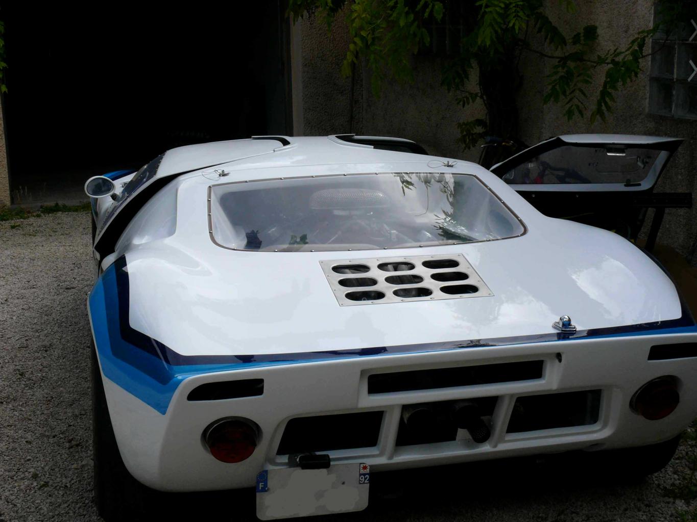

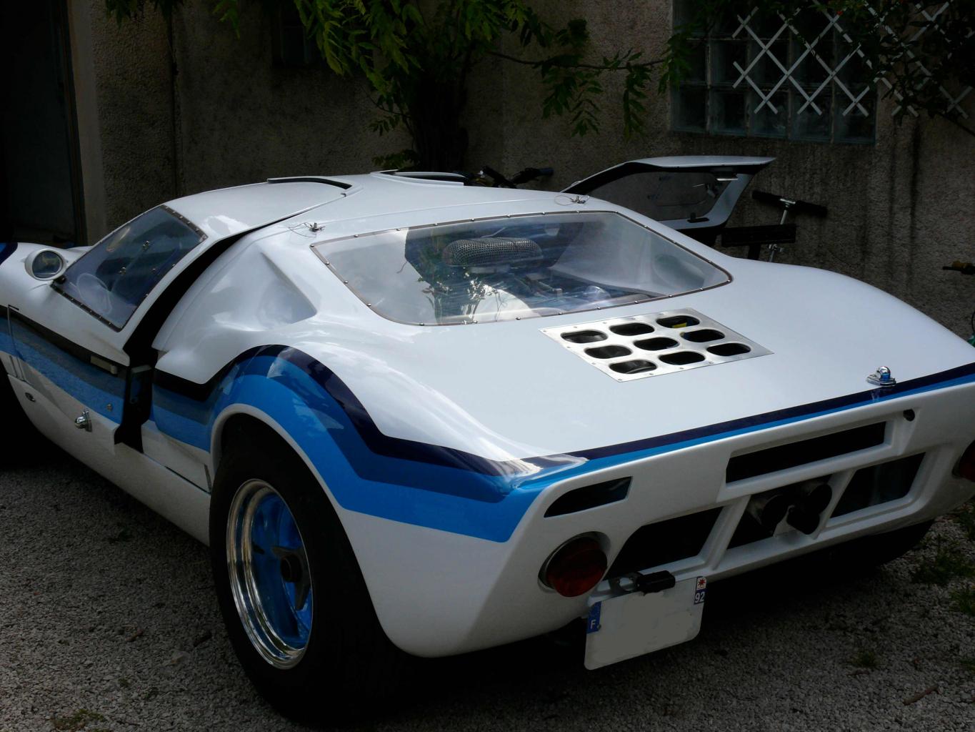

Paul,
Following my PM, here are the 2 pics of my car (not so good sorry !) Standard GTD rear clip, 10x15 Image Wheels (BRM-like) and Avon 275.

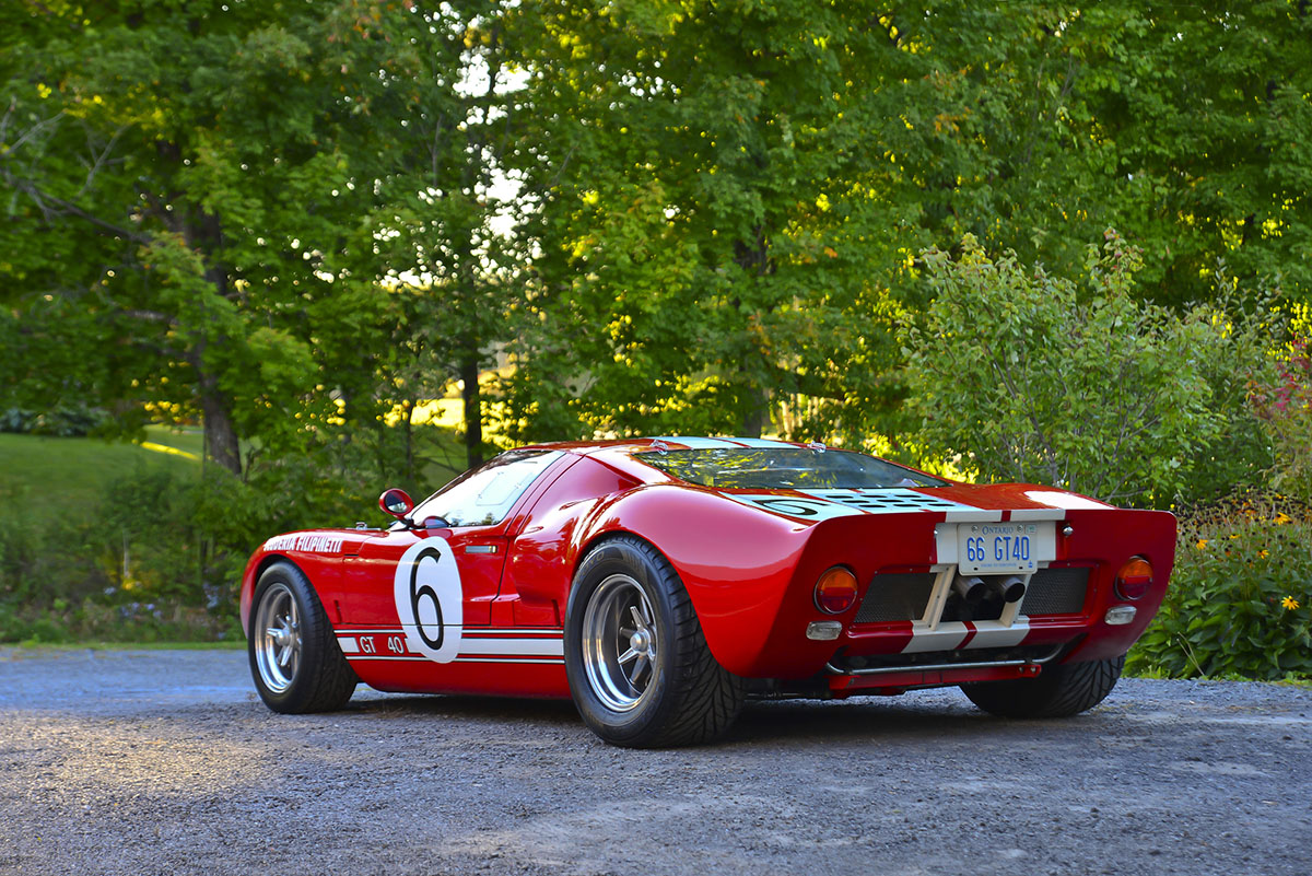

Mark Charlton
On my GTD I have the 15" Vintage Wheels BRM copies. Tires are 225-50/15 and 295-50/15 in the rear. It looks like they should rub but they don't on mine.

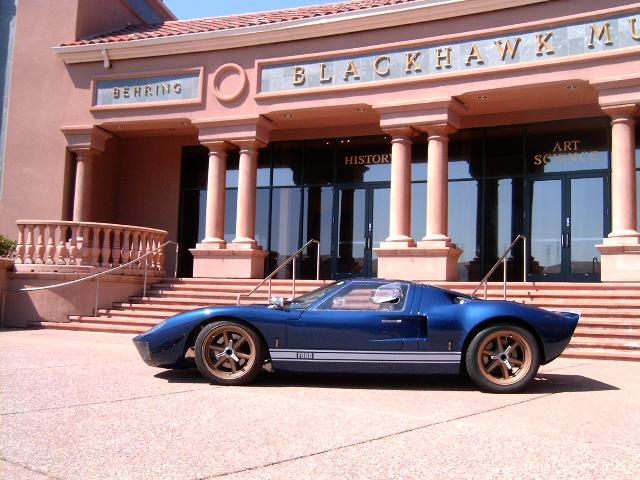

Howard Jones

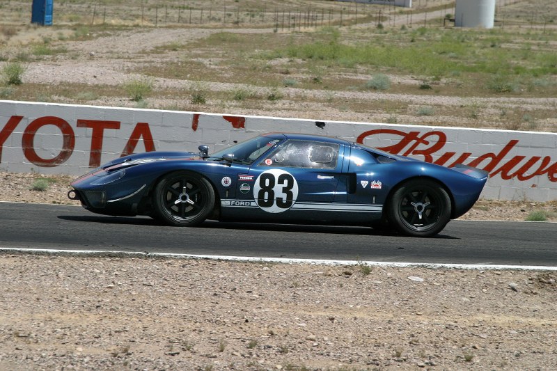

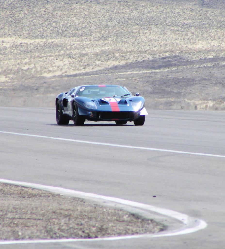

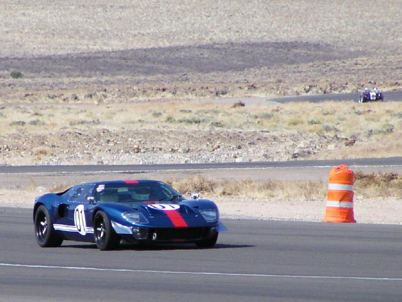

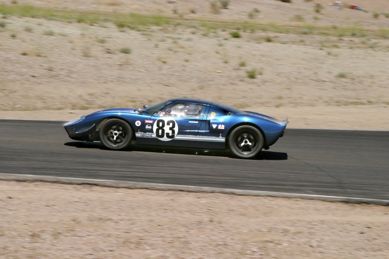

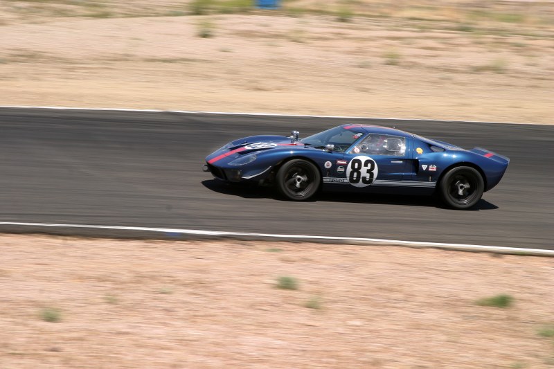

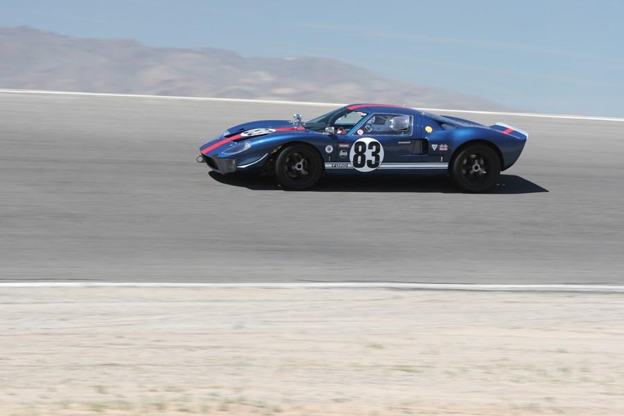

These are what 17s look like on my GTD. Tires on the 01 number and gold wheels without numbers are 225.45.17 and 285.35.17. On the 83 pictures I am running 245.40.17 and 315.35.17s. Wheels on both are 8 inches wide in front and 10.5 in the rear. All again are 17 inches in diameter.
