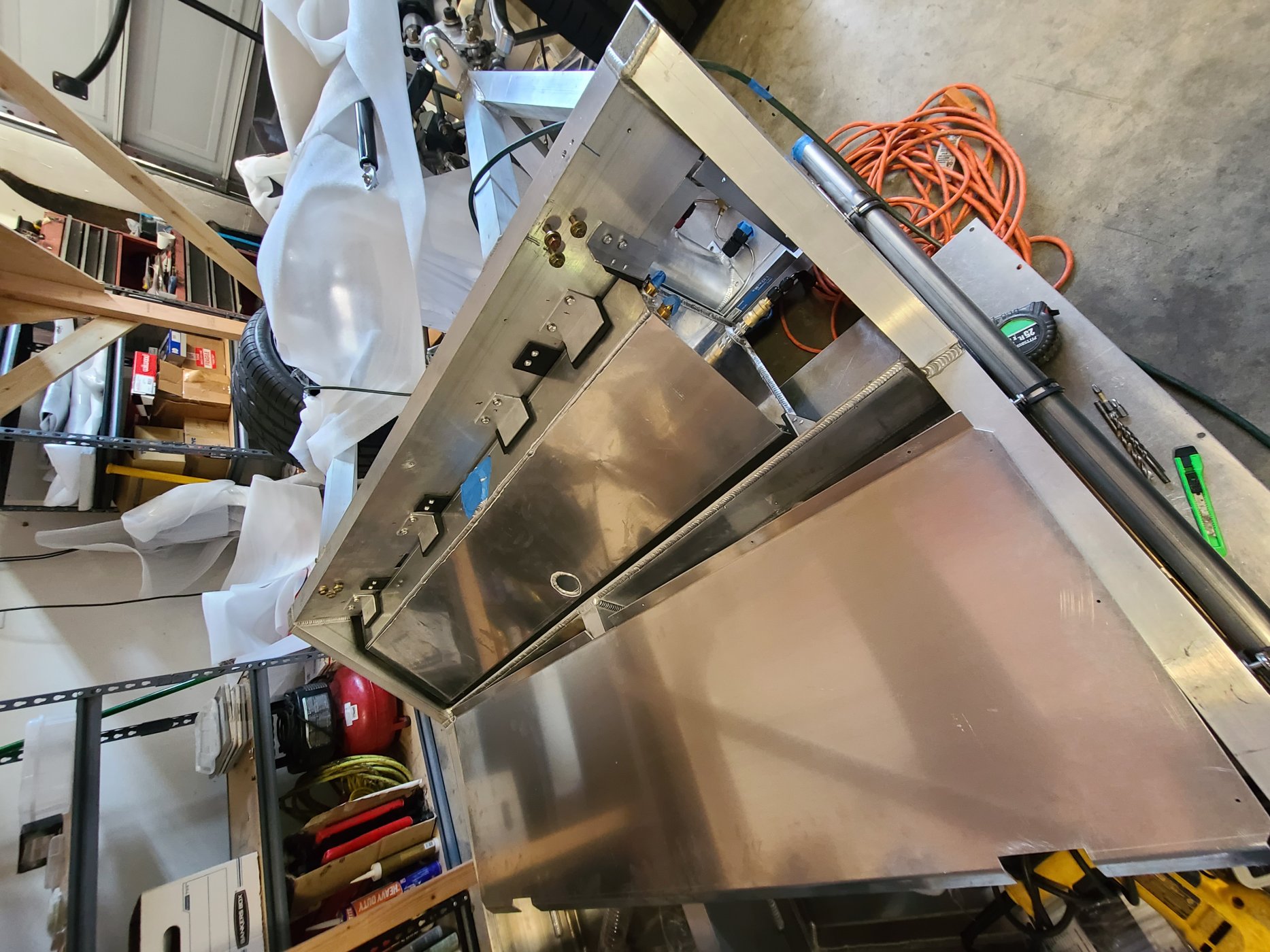

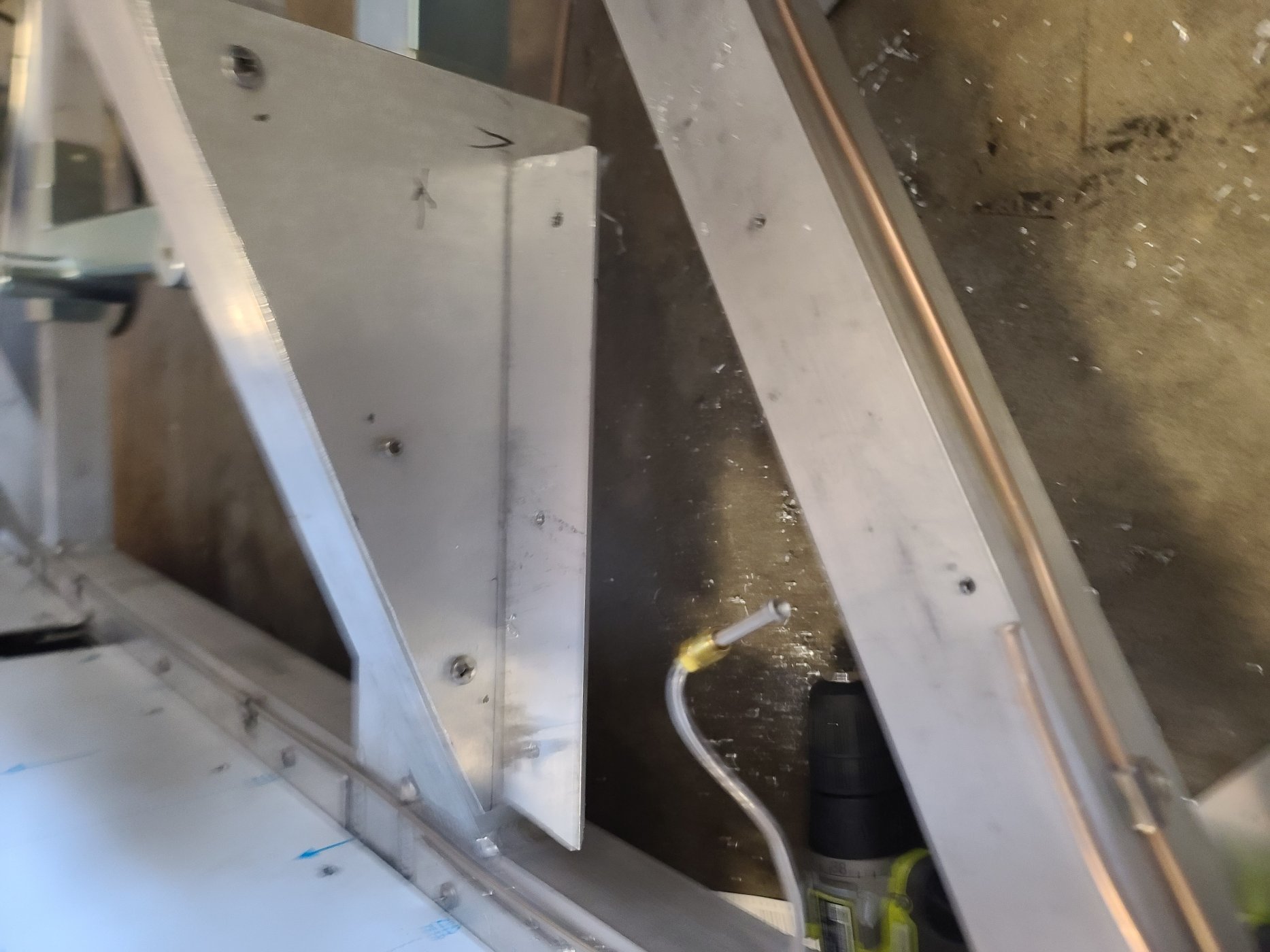

I was going to mount my fuel pumps and filters on a aluminum sheet. Should I mount on the outside frame rail..OR the inside frame..pros and cons appreciated..got the idea from Michael and Dustys post..will it be clear of cats headers etc? Thanks!! Don't want to drill into frame and have to move it later..

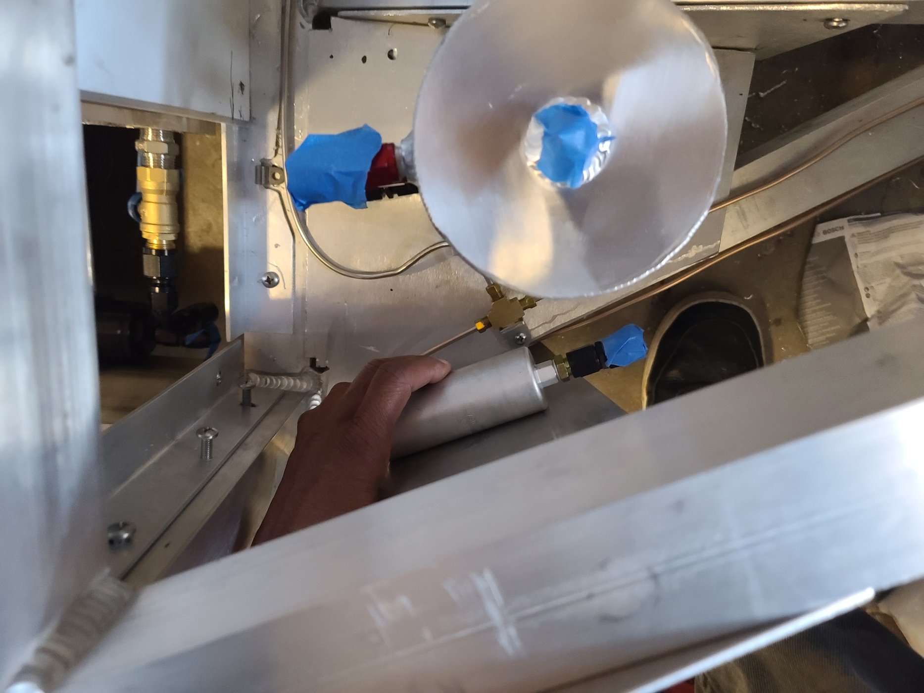

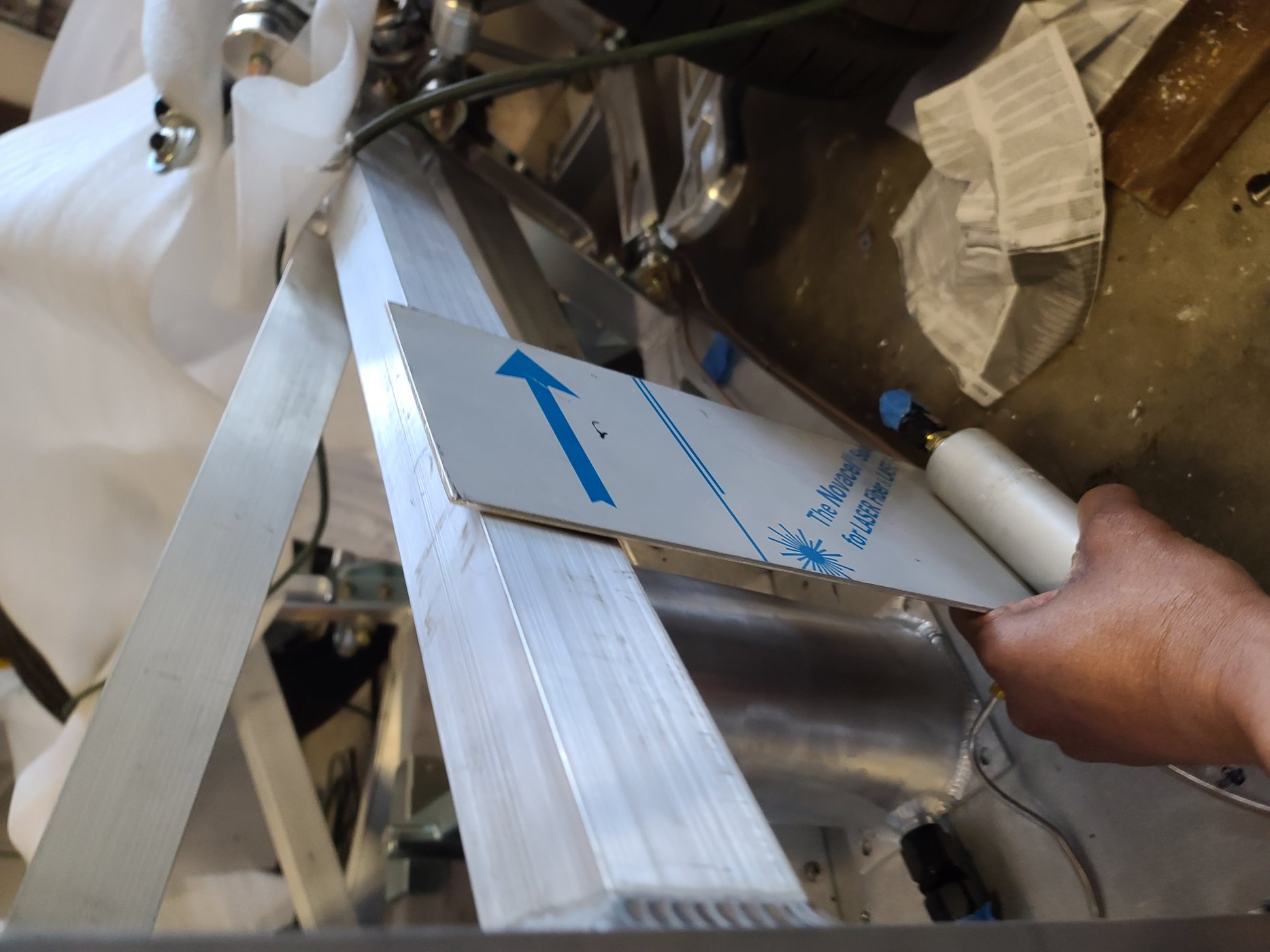

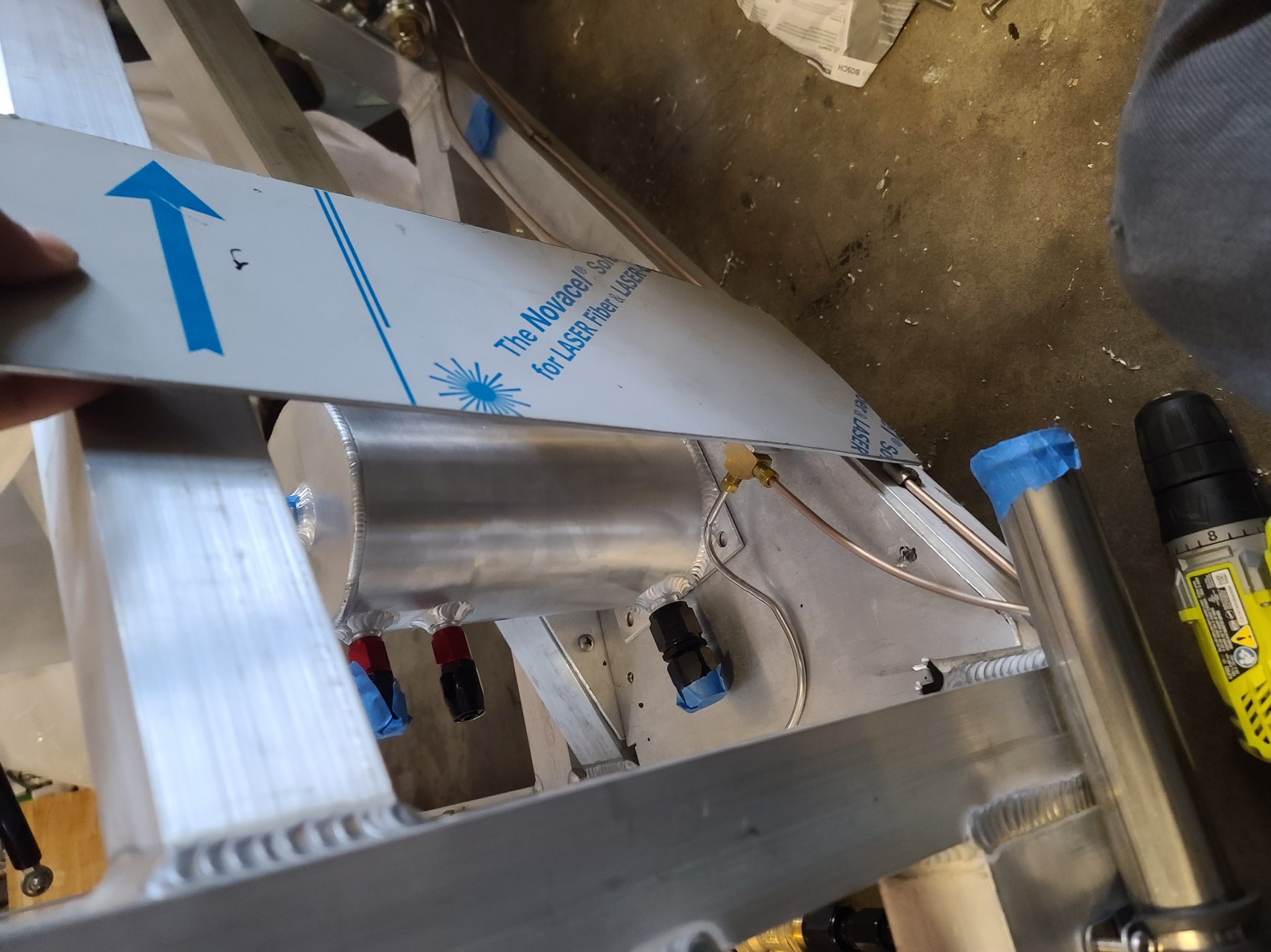

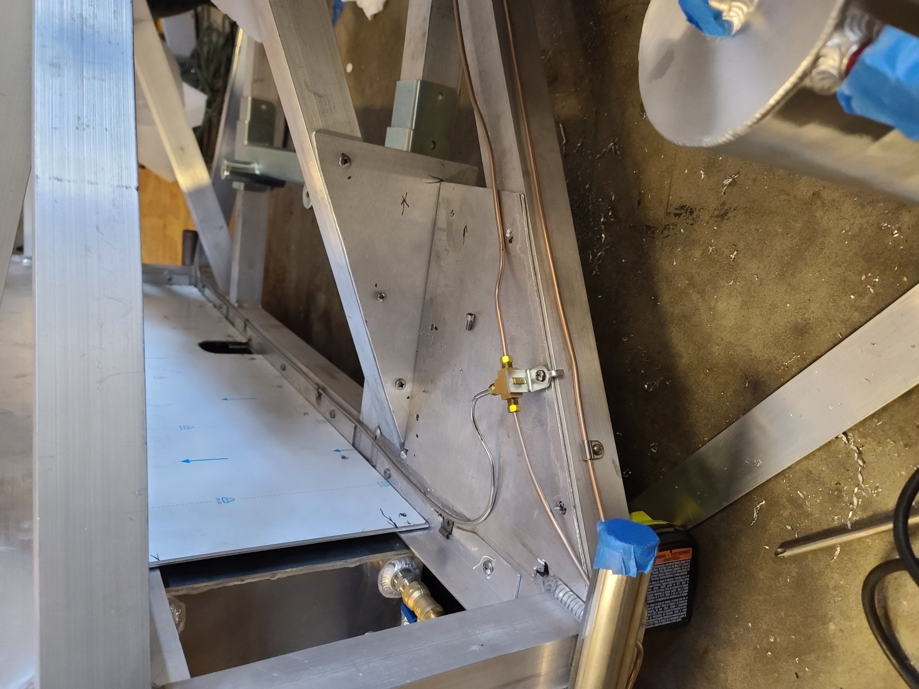

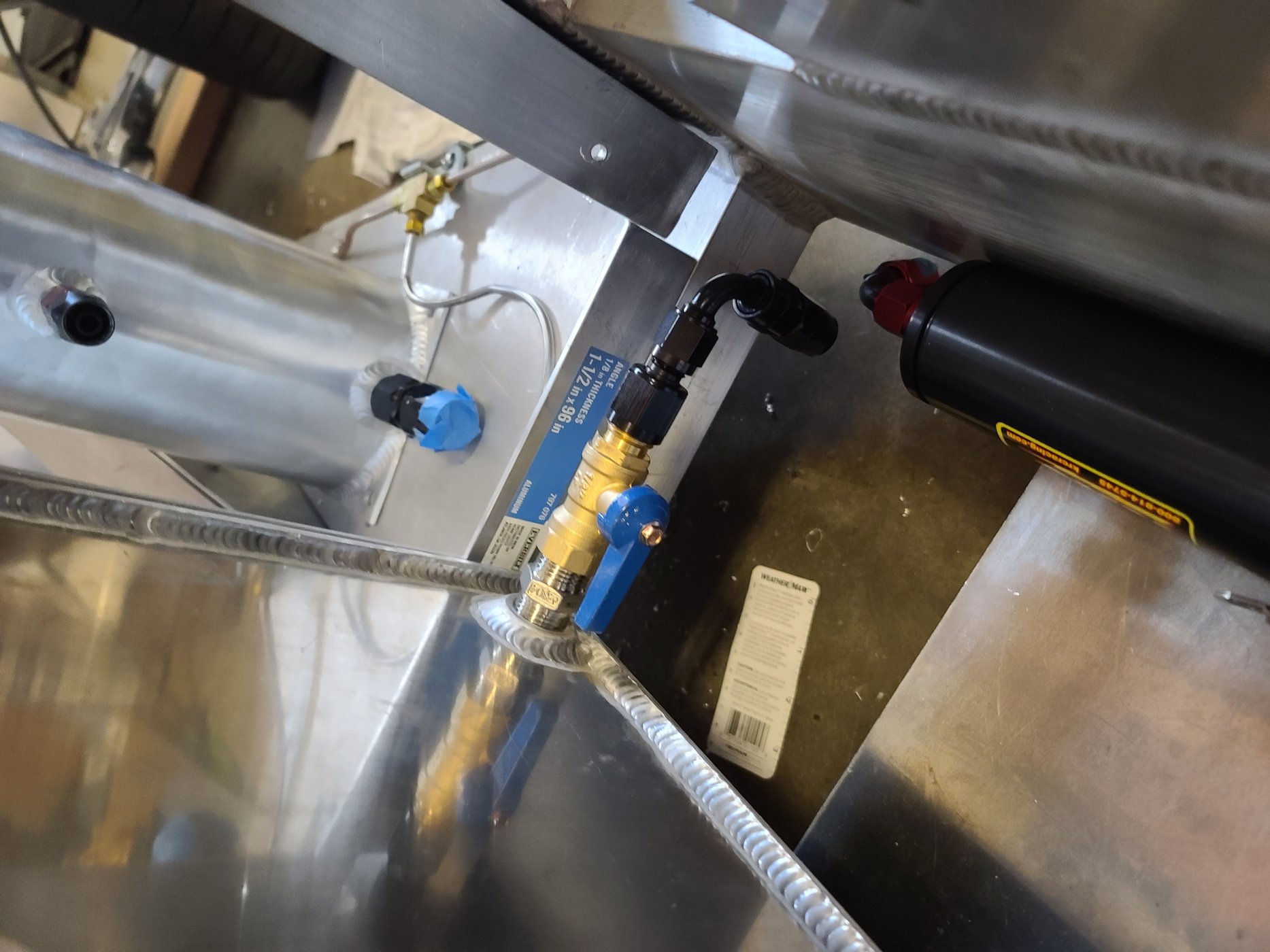

venius

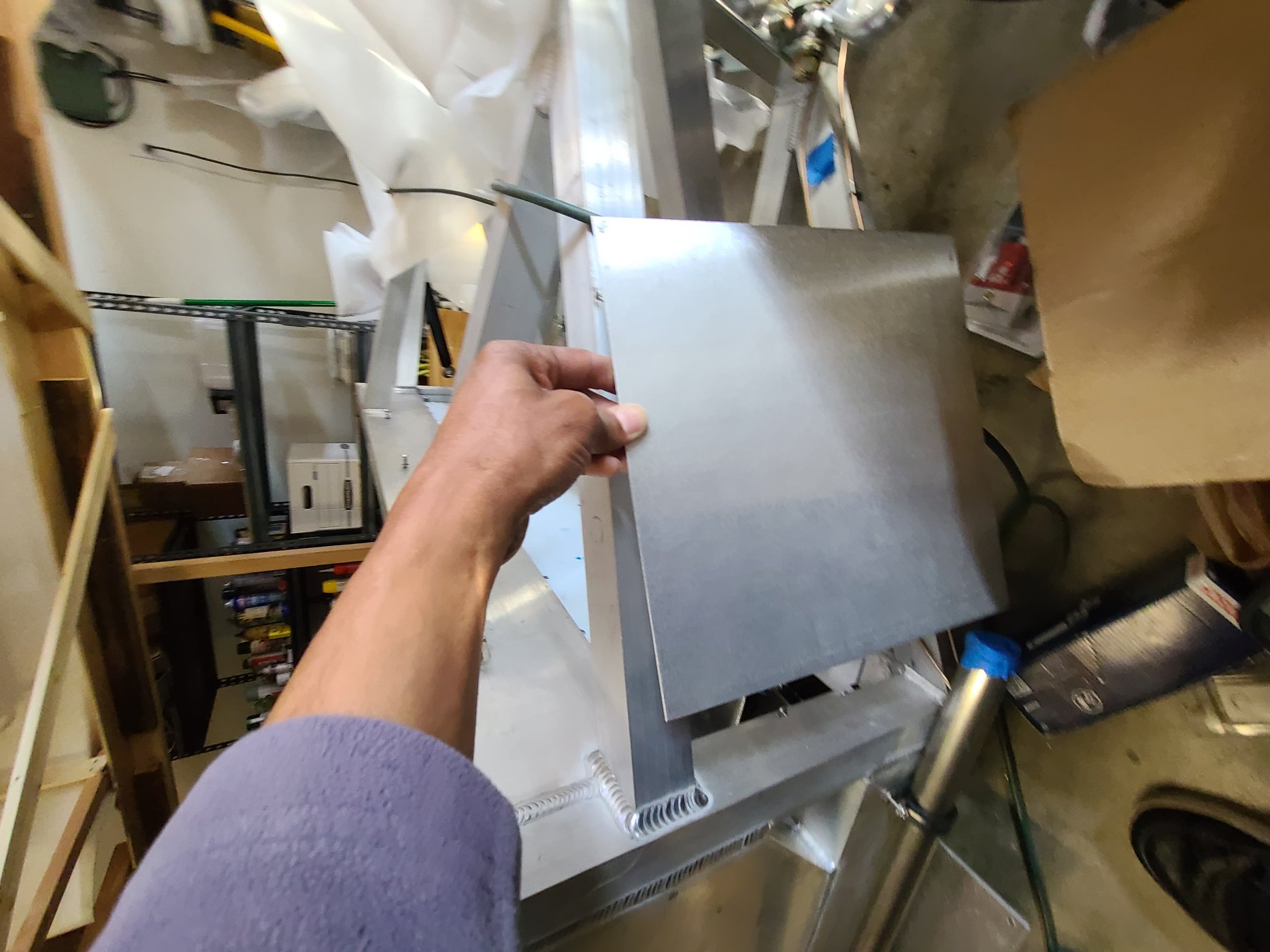

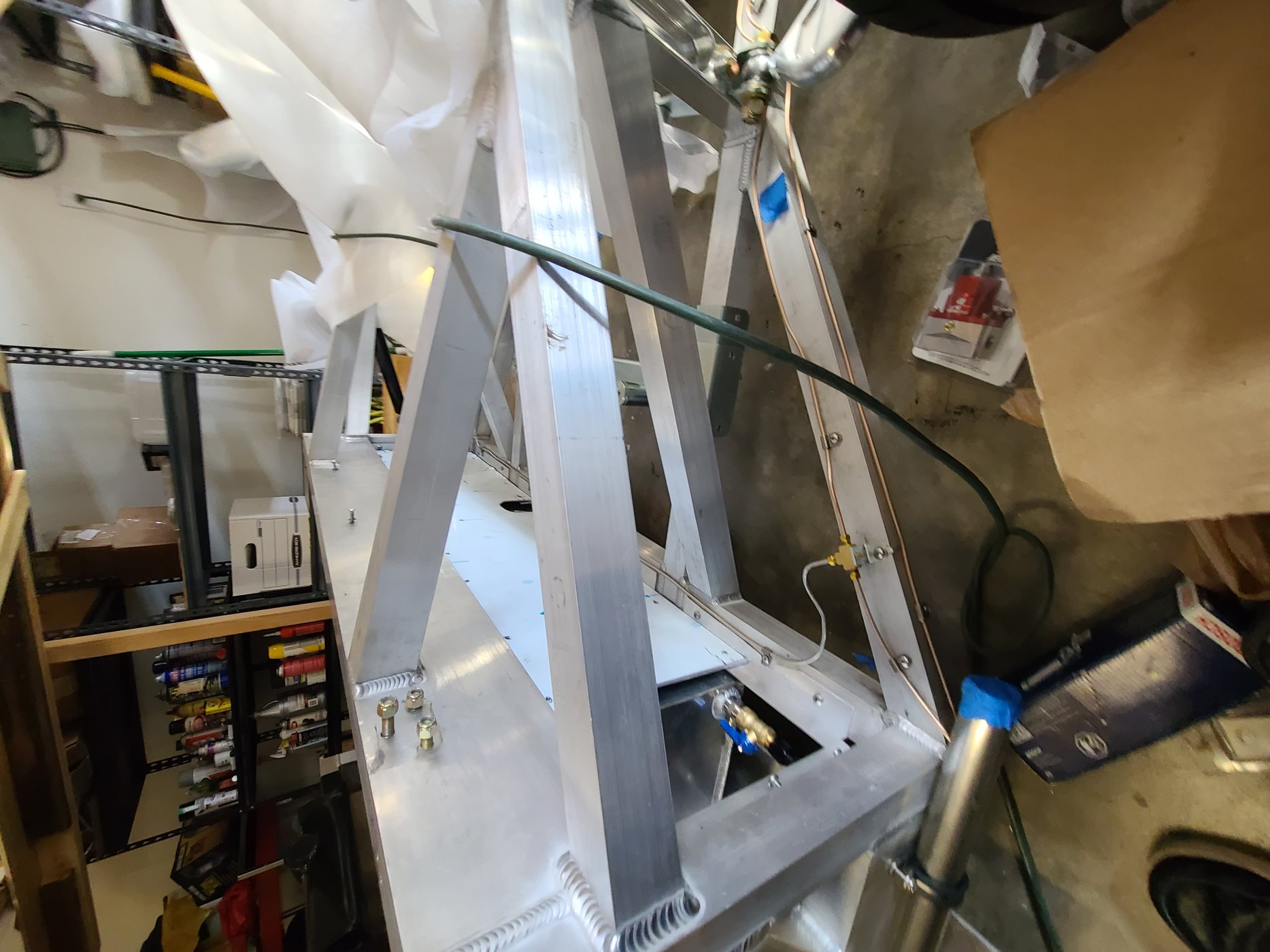

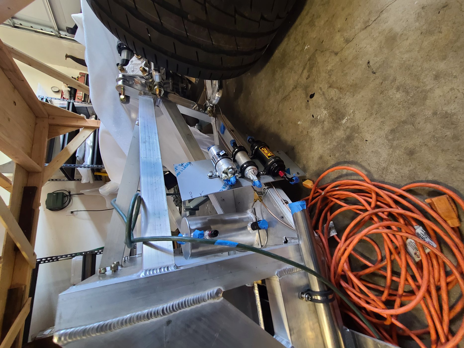

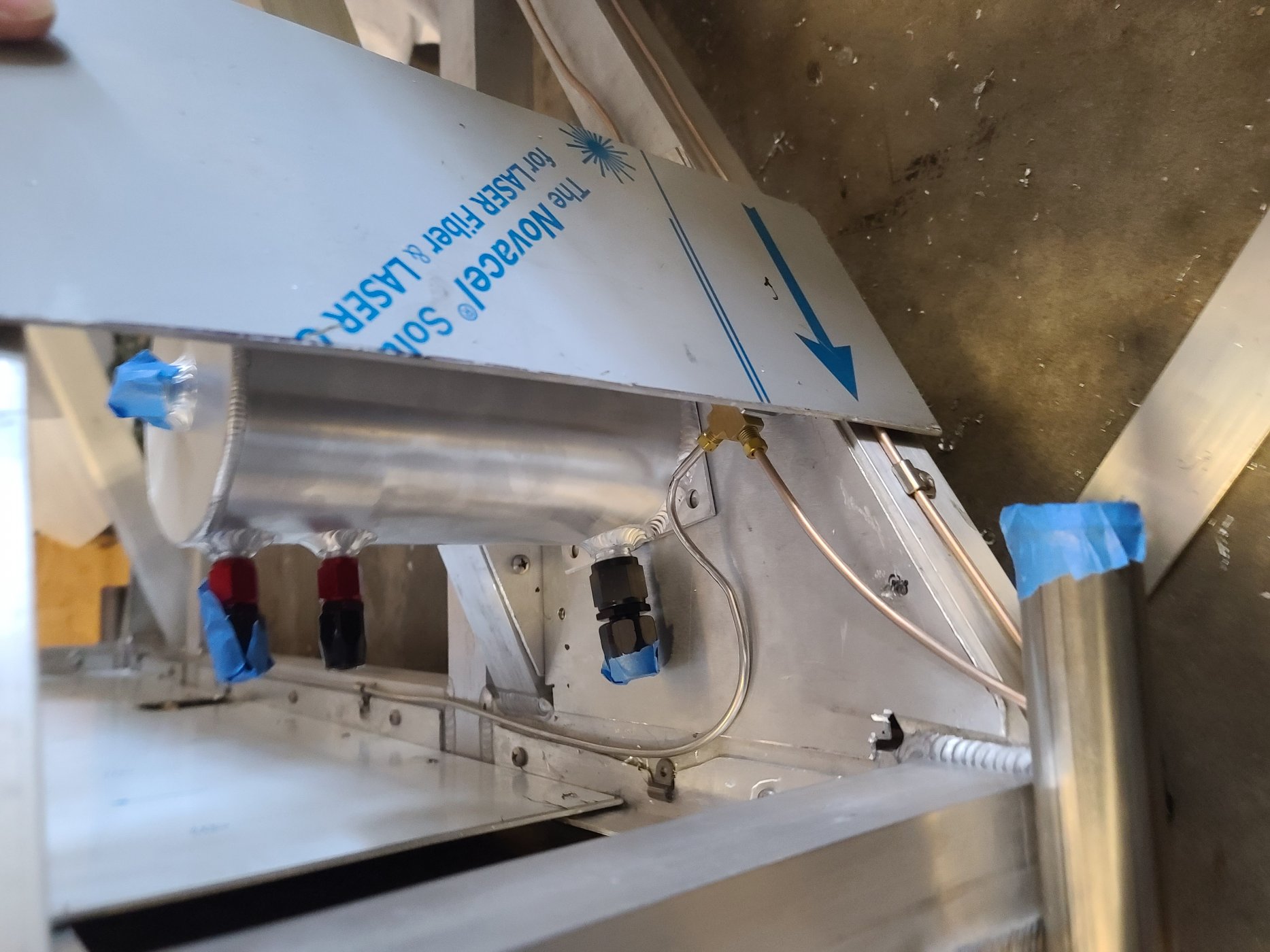

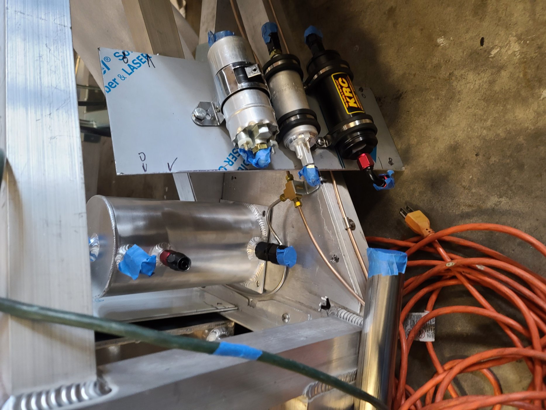

I'm going to mount my fuel pumps/filters on the outside frame using 1/8 aluminum sheeting (ebay), aluminum corner bracket( home D) and some nuts and bolts. Seems like plenty of room to mount pumps /filters inside or outside of frame time to mount fuel pumps filters and connect hoses

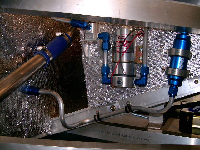

Howard Jones

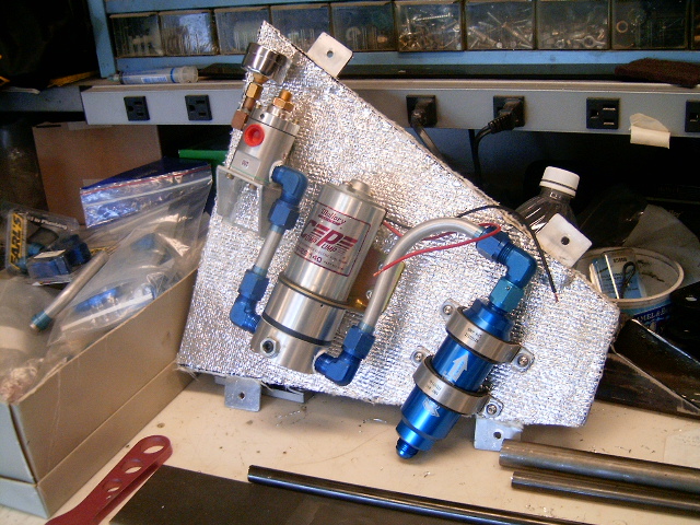

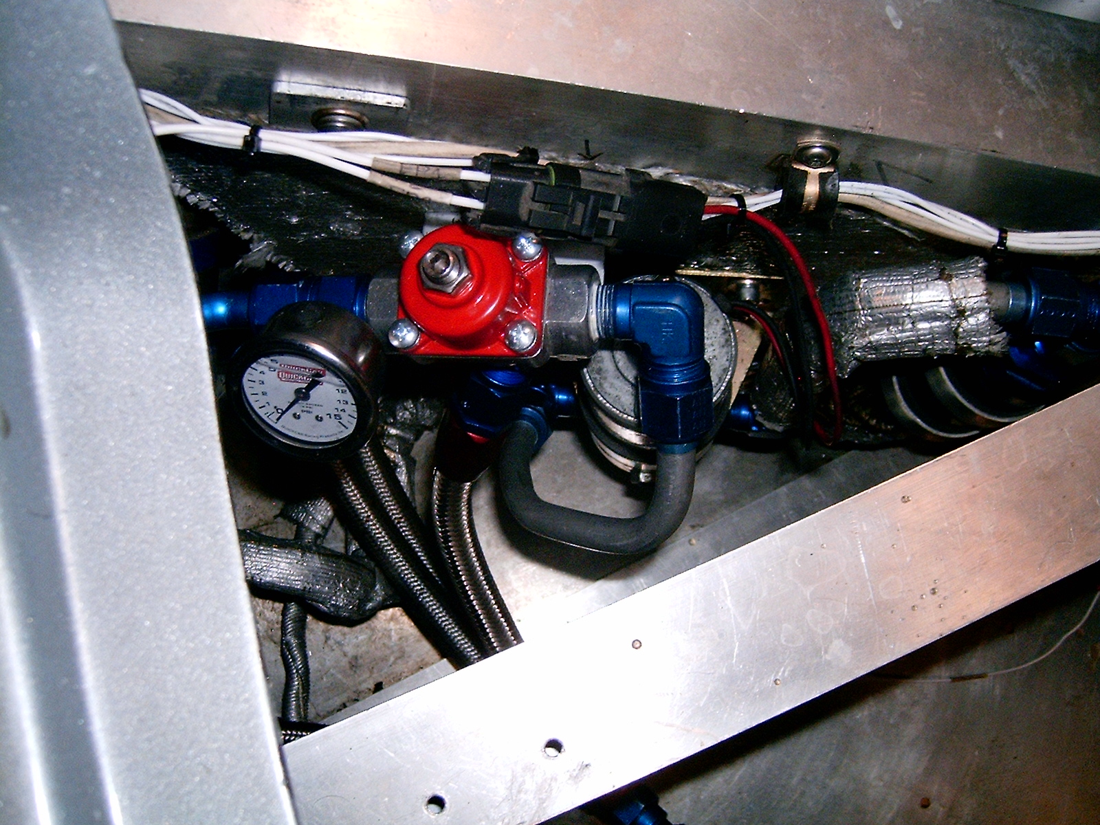

I mounted mine on the inside with a heat barrier on the back. The whole thing can be removed with four screws, undoing the hoses, and unplugging the pump. The first two are the first version without the return-type regulator and the second is the final version with the new regulator. Whatever you do make it so you can service it.

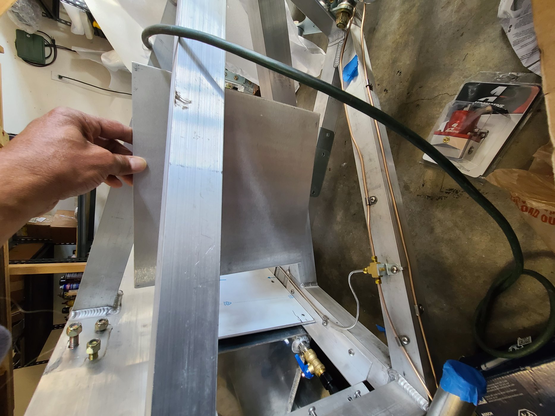

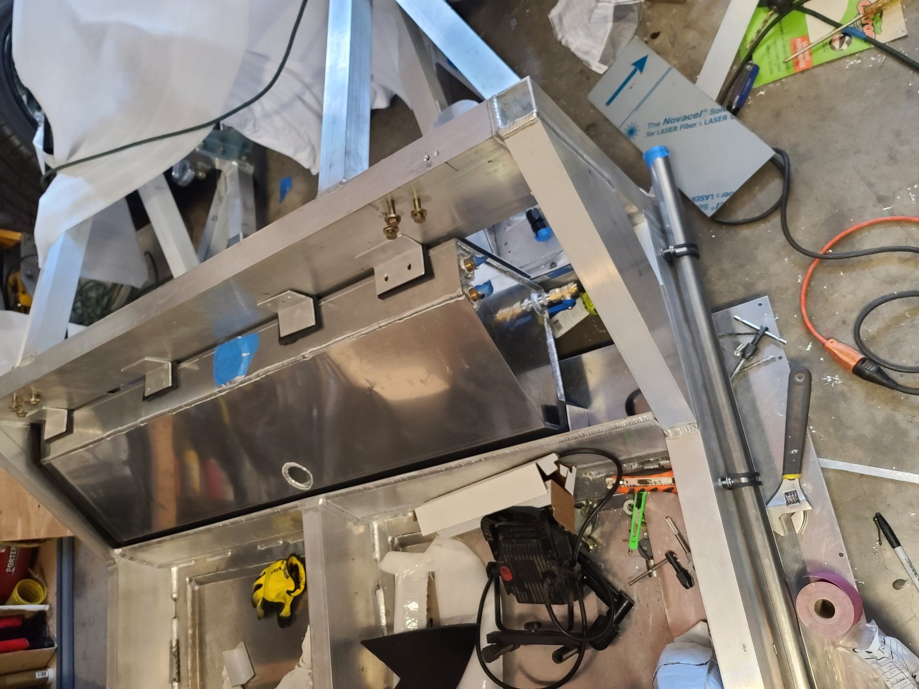

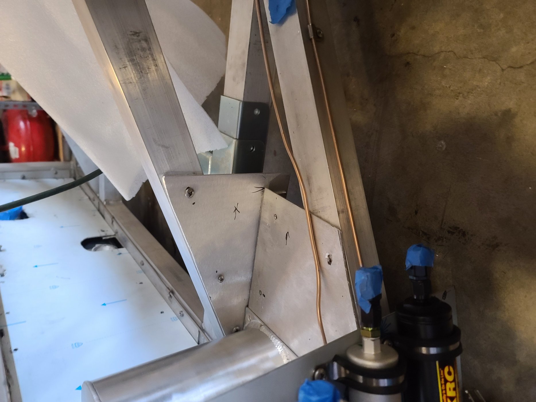

Thanks Howard!! I haven't drilled the frame yet . I'll mount my filters after I get the body on (if I can). Just in case I have to move it a couple inches..I still have room for a battery too!!
