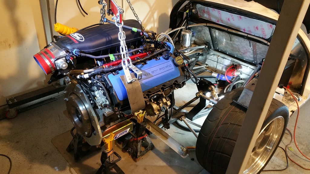

I am looking to buy a GT40. If you looked at my pics, you will see that I have a Coyote motor... very happy with this choice as my 1st Cobra was a carbed small block.

Like Peter mentioned, it's a good bit of work to fit a Coyote into one of these but I've done it using the stock slant and not the modified one that Tornado uses (they angle the thing up...which is fine too). It does require custom made mounts and headers too. Eric at KitCarChassis can help you out there as he did the mounts and helped me fabricate the headers.
If it were me though, I'd give RCR a long look and go that route here in the US. Fran's product is very good. I haven't seen a Tornado with the Coyote in person, but the regular built one Dr. Bob has is very well made as well.
Whatever you go with, feel free to ask me any Coyote related questions you want. I've put a bit of time into researching the thing for use in our cars.

Just to make things clear our engine and gearbox is NOT inclined.
The Coyote engine is much wider and the inner wheel arch mouldings are re positioned to clear the headers.
Our Coyote chassis is specially adapted and features many changes for the Coyote including engine bay, suspension pick ups and rear bulkhead.
We also have all of the other parts required to complete the installation including modified throttle pedal, engine mountings, alternator kit, exhaust system with CATs, water pipe cooling kit, bellhousing, clutch, starter and A/C kit etc.
We also have a version to suit the Ricardo gearbox.
Andy
I was referring to the angle of the seat against the rear bulkhead. I understand that your engine and transaxle are not inclined.
Having the mounts and headers would have saved me a lot of time for sure BTW.
