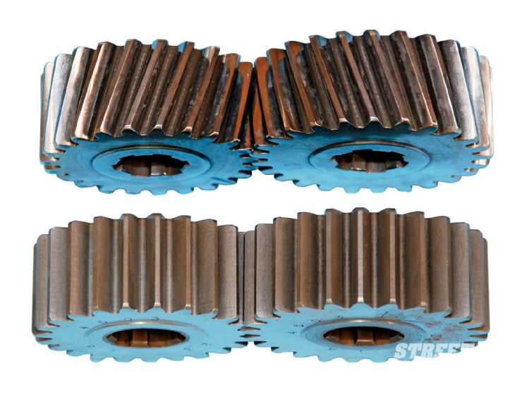

Which transaxles can be dog boxed?
I'm researching transaxles, and am wondering which, if not all, are able to be dog boxed? (straight cut gears) I'm pretty sure the ZFQ is straight cut stock, but is it sequential as well? I'm debating if I want sequential or not, but I do know I want straight cut gears. I tried searching the forum, but didn't really come up with anything during my search, so if this subject has been beaten to death already, I apologize, I'm new.
I'm open to all opinions and experiences of dog boxing and sequential shifting. And thank you all in advance for your input.

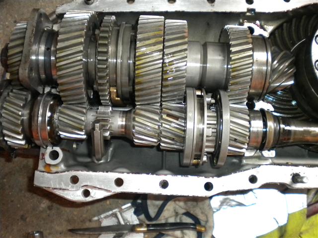

Hello,
Spur vs helical :
Very often, I read that the common belief is that spur gears are stronger than helical gears. In my opinion, this is wrong. Helical gears are superior to spur gears. Beside the quietness, the load carrying capacity is far superior with an helical assembly as the mating surface is obviously wider with an helical and also because the load distribution is progressive.
Dog engagement & UN1:
The Renault UN1 is widely used for conversion to dog engagement. he benefits are the followings :
- you have for a reasonable price a very strong housing with all the links and forks
- you have a bullet proof output shaft : basically with a breaking point of 1560 ft-lb and so, a calculated max torsion capacity of 905 ft-lb, wich is not too bad...so even taking a safety factor of 0.50 it gives you a 452 ft-lb load capacity.
- You get rid of the weak primeshaft and get it replaced with a stronger one.
- You have the benefits of a 2 parts Inputs : Input shaft & intermediate shaft, far better than a straight single shaft.
- You have access to 4 final drive : 3.44,3.89,4.11,5.86
- you can have whatever custom made gear ratio configuration allowable in a 75 mm center to center.
- a lot of manufacturers are making adaptors plates , this allowing the UN1 to be mated to whatever engine, others make even special bellhousing, sometimes better as it allows to fit wider clutch assemblies.
Discrepancies :
You have to add a lubrification system to cool oil and the Splash lubrication system is obviously less effective than a pressurized system or an every mesh being oil sprayed.
The 75 mm center to center is a bit too small and will not allow very low gears to be cutted.
This being said, if you intend to cruise with your car and just not go on a track, it could be better to think about a synchronized system as driving a dog enagemenet gearbox in traffic is a real nightmare.
Greetings
Stephane
