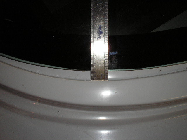

I think my only other concern will be the large gap in one area where the windshield needed to be bigger . I'm not sure if the seal will make the gap and make it look ok or maybe find a different seal. Its about 12mm and I don't think you would want to drop the windshield lower The gap would open up in other areas.I guess you could also make the fibreglass area wider below it , but that might not look right.
That is funny Dan M. that we were just discussing this.
Dan, Jim or any one else have a spot like this on their's ?
This is on the R/h lower area.

Dan,
I don't have any areas like that. My glass/spider only had tight areas. The only way to properly check clearance (my glass guy demonstrated) is to install the weatherstrip and center the glass. You may find 1/8" by doing this, it really changed mine.
