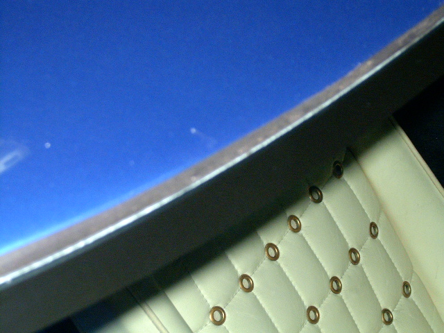

Howard Jones
1
Howard
My mistake...I should have known it was for research/scientific purposes only. But the view is nice.
Phil

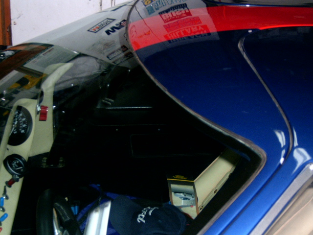

Jim Dewar

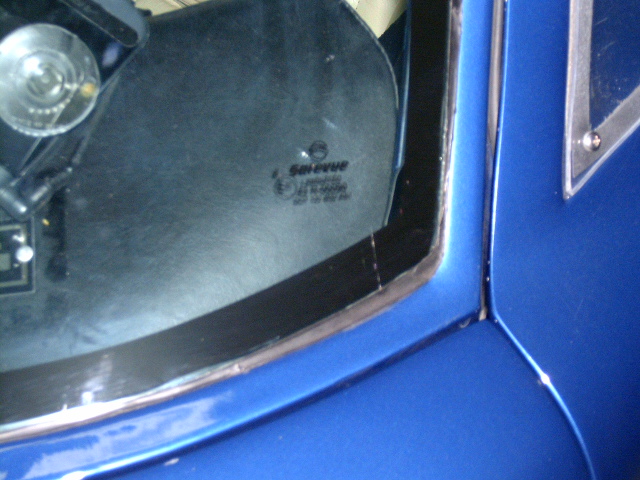

I found the answer to correct windshield fit! I called my local glass guy who stopped by and checked my clearance problem, marked the glass for correct fit in the spider opening and carried it to his shop to grind the excess glass away. The clearance is now perfect all around the windshield so my weatherstrip installed, seats perfectly in the spider opening.
Jim,
I was just talking with Dan W about this very issue while you were posting! I'm sure he will be glad to see this.
Hope all is well on the home front.
