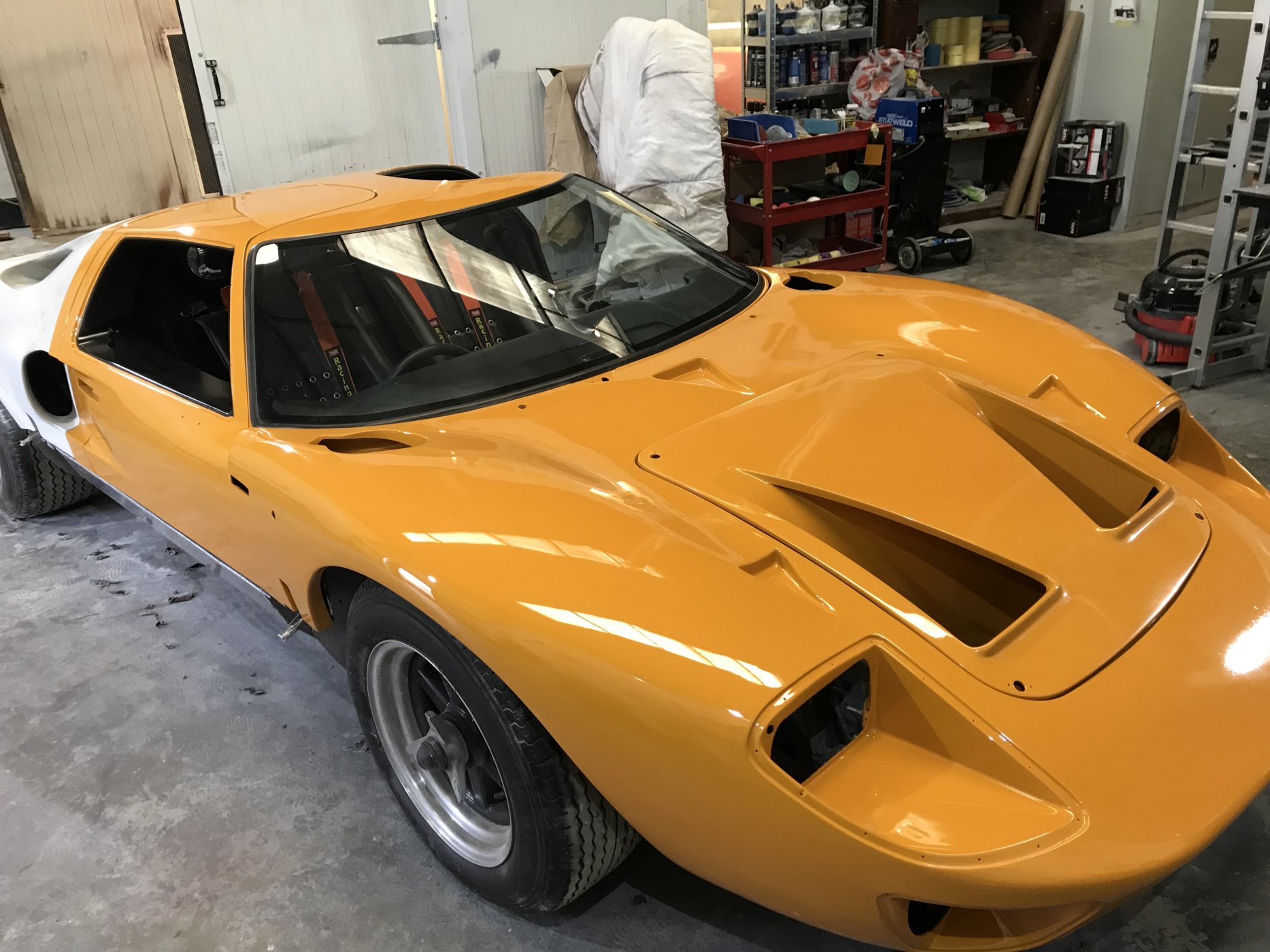

I had mine fitted before painting, my painter did a fantastic job of pealing back the rubbers, but he did say he would have preferred to paint the car without the screen in.
Good luck.
I would recommend you fit it with the gasket, then remove for paint and reinstall… Have a Glass Guy do the install. They’ll use 5he proper sealant.
