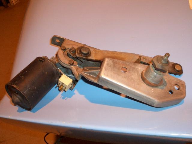

Can anybody identify this wiper motor assembly?
It is a Bosch motor marked 058 BHP 12v
0 390 346 127
The relay has 5 terminals, marked:
53 at the top
31 at the centre
53b at the bottom
31b on the LHS
53a on the RHS
Any help would be appreciated.

Now then dad.
Its off a old Citroen CX.
This is your motor>>>>>CX-Basis :: Online-Shop
and this is your mechanism>>>>>CX-Basis :: Online-Shop
Your relay terminals are the following:
53 at the top = wiper motor + in
31 at the centre = return to battery- or direct to ground
53b at the bottom = limit stop field
31b on the LHS = return to battery- or ground through switch
53a on the RHS = limit stop+
Hope this helps dad.
