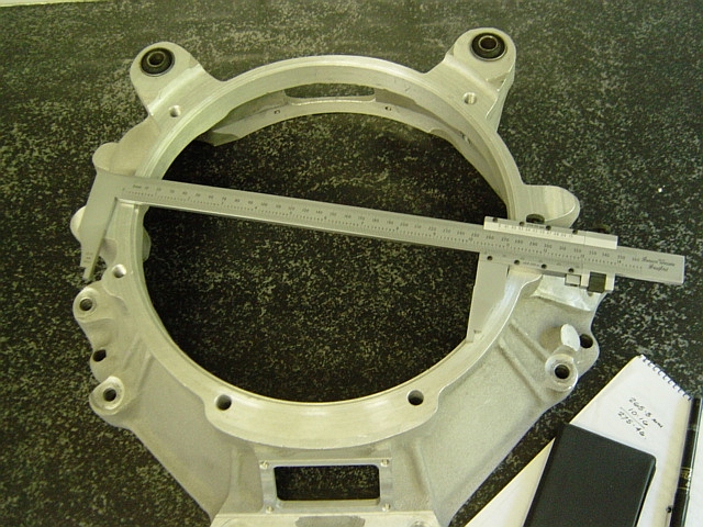

I will try to help but I'm confused with your "four bolt" statement.
Below is a bell where I have just measured the inner counterbored register diameter as 275.46mm with good verniers.
If you need any other dimensions from it just send me a pm.
I will also try to get the data verified by the ZF professional I know for you.

Hi Ross,
JimmyMac has given me the dimension for -2 recess dia as above in post# 2 and Roy is going to fwd the same dimension off a -0. Only other dimension I will require is length of bellhousing-[rear face of motor to front face of T/Axle ]. These two dimensions will be enough to get me on the way. Just want to make sure I put enough material in the casting to cover either trans option.

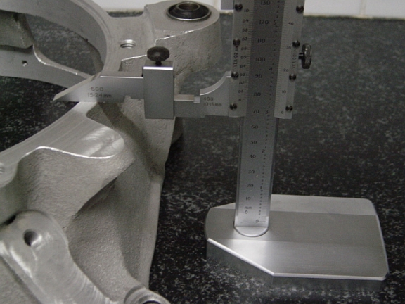

Jac Mac,
This one is 100mm long face to face.
The worktop is pretty level and I don't have my machinist's table so I took six datums.
I double checked the vernier height on a glass table afterward with a Rabone Chesterman rule.

Thanks very much James,
You will do well in the race car scene with measurements like these.

I haven't got James' fancy measuring equipment but I can confirm the 100mm face to face measurement. I'll be in sunny Southland next week Jac Mac but won't have time to go fishing.
