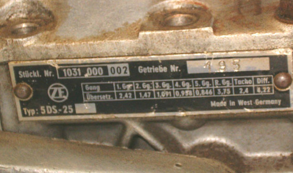

It assumes 'standard' ZF gear ratios, with a 4.22 ring and pinion, and a 26.5 inch tall tire (BFG says their 295/50-15 is 26.7 inches tall, so that's a good starting point). The spreadsheet allows you to change any number of variables, including tire diameter, each gear ratio, and the ring and pinion ratio. It is actually set up to display data for a ZF six-speed; the first five gear ratios displayed are the standard ratios for the standard five-speed.

Once properly formatted for human viewing, the results are quite illustrative. Lloyd Butfoy told me that unless otherwise ordered, the new gearboxes that he is quasi-mass-producing are fitted with 3.77 ring and pinions, which is different from the 'standard' 4.22 ratio fitted to Panteras and (most) Mangustas. Although that is great for top-speed bragging purposes (assuming a 26.5 inch tire, 6500 rpm equates to 193 mph), it has been my experience driving 3.77-equipped Panteras that the taller rear end ratio really blunts acceleration.

It seems to me that if low rpm freeway cruising combined with electrifying back roads and racetrack performance is the goal, the ideal combination would therefore be a 4.22 ring and pinion coupled with a taller 5th gear. Lloyd sells both .655 and .642 5th gears to replace the stock .705 ratio; the .642 ratio gives about a 1000 rpm drop when shifting from 4th to fifth at freeway speeds.
The spreadsheet shows a gearbox so-equipped would deliver 144 mph in 4th gear at 6500 rpm, which is about all you could expect on an American track, yet 5th gear would allow a top speed of 189 mph at the same rpm. More importantly, it would allow you to cruise at a mere 2500 mph at 70-ish (actually 73) mph.
