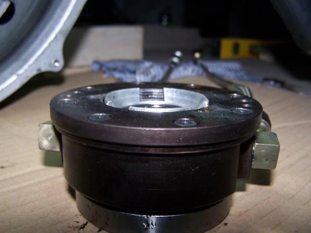

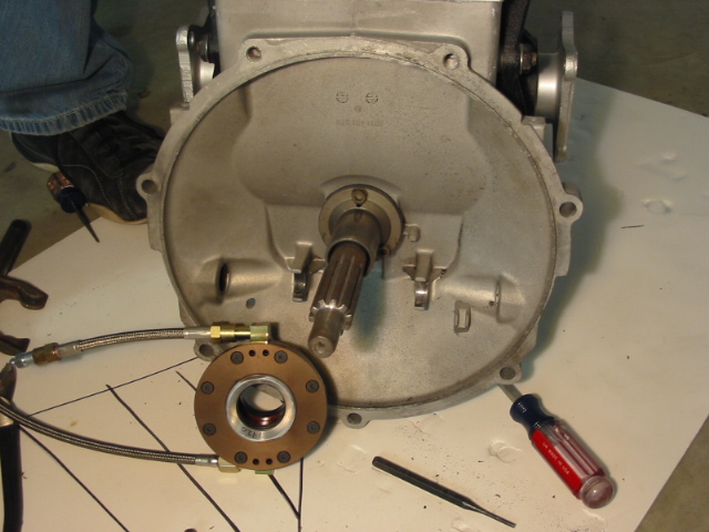

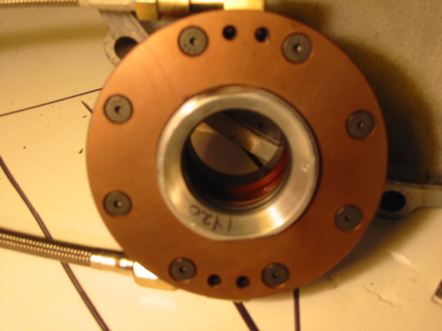

We are in the process of installing a McLeod hydralic clutch release bearing on our ZF.
The back of the bearing is beveled to fit nicely over the input shaft bearing cover. But there are three bolts securing the bearing cover, so the nice beveled surface is not longer a proper fit. ( I may not be using the right terminology. Hopefully the pictures will make the issue clear).
I am guessing I could replace the bolts with a recessed screw and bevel the opening so they are flush, but before doing anything I would like to see if anyone has dealt with this issue.

Chuck your missing part of it, there is another piece that slides on first with slots cut out for the bolts THEN the hydraulic part goes on.
Markus
SPRF40

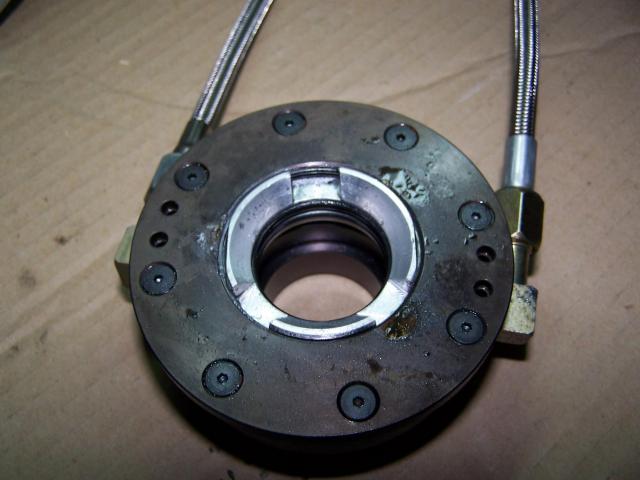

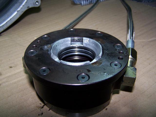

Chuck,
you need to "mill out" some slots for the bolt heads (see pictures below). When you put everything together, make sure the bolt heads reside in the slots....
With my bellhousing (quick time) the distance on the pics was correct.
I hope this helps,
Markus

Chuck
Markus:
Excellent idea. I was debating about whether that was the best approach, and you just answered the question. Sure beats trying to counter sink those bolts.
I am still about 3/4" short with the KEP bell housing, but a space should solve that issue.
Of course still considering the external slave option . . . .
Thanks.
Chuck
Markus:
Another question. The slots resting over the bolt heads will prevent the insert from turning, but the bearing could still rotate on the threads of the insert. What keeps it from turning on the threads? Or is that not an issue.
Markus
SPRF40
Chuck,
there is nothing which prevents it from turning.
So far it is not a problem but I could imagine that it could become a problem so please take a close look to Frank Catt's suggestion: http://www.gt40s.com/forum/gt40-tec...lutch-hose-routing-pedal-stop.html#post280656
If you are 3/4" short you should have plenty of space left to come up whith a solution.
FYI, I'm currently collection all the components to convert to an exernal slave.... The internal solution work great right know but when it fails again I will kick it out.
Markus
Chuck-as Jack says you are missing the beveled part with bolt clearances. I believe that is also the spacer you need to machine for proper bearing to clutch clearance. DO NOT machine the bolts on the transmission. The release bearing will not turn because of the internal o rings. I've got 4 thousand miles on mine with no problems.
