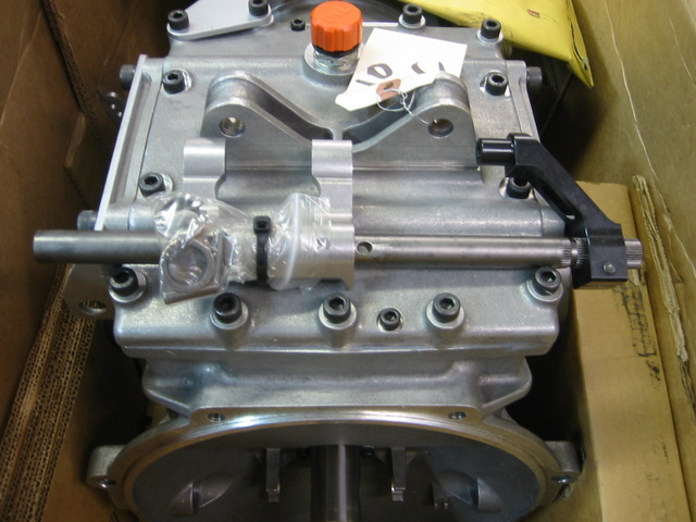

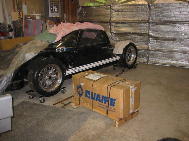

John, too give you an idea of how rare these are check out the date on the first post of this thread (2-8-07). I was one of the first 10 to order and it arrived home yesterday thanks to a lot of help from Chris Melia and Dennis Olthoff. 40 were made in the first production run of which I think I have serial # 12. If I were you I would talk with Chris and get your name on his list. You just have to ask yourself if you have been bad or good, because I think his last name is really Cringle?

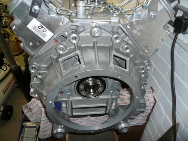

ZFQ with bellhousing in UK Superformance.

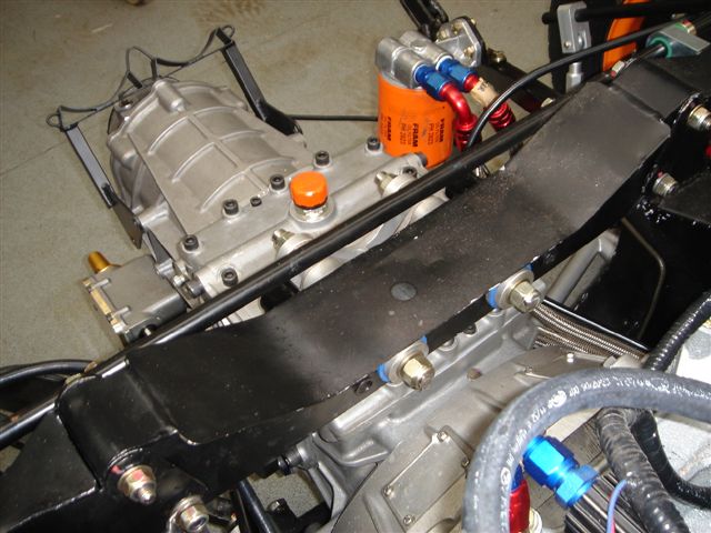

Couple moore

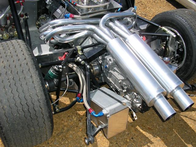

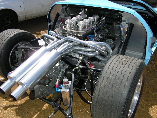

ZFQ Installed in a great Southern Gt owned by Glen Mason

Also posted on build thread. Quaife ZF-Q bell housing to LS7, slight fettling of one of the two holes for the LS7 location dowels, took just a few minutes with a dremel (Actually it was a force fit as delivered but Mr Melia suggested I eased it just a tad:idea:) but for those of you looking to go down bowtie and Quaife route thought the pics might be of interest.
