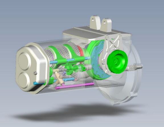

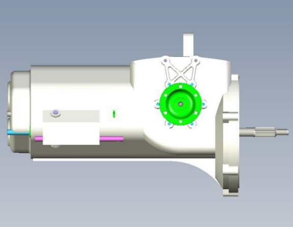

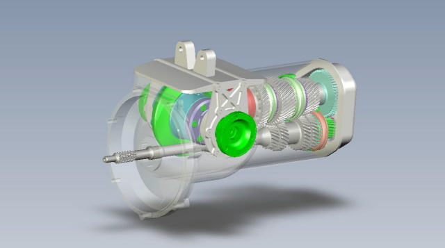

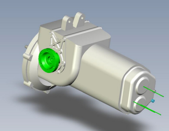

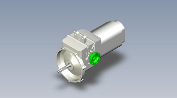

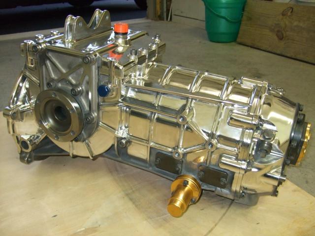

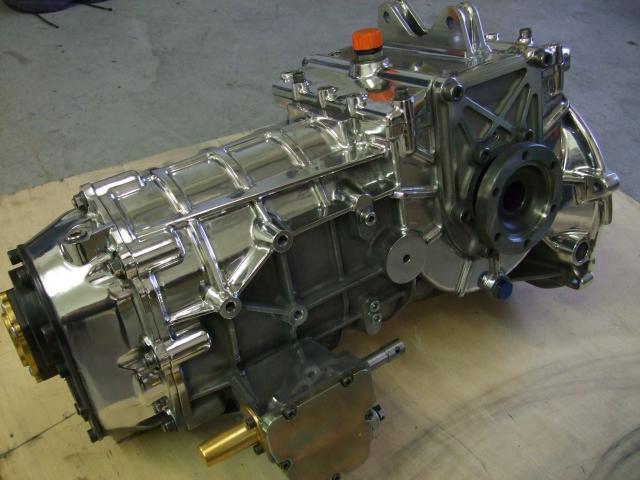

Hi Guys
We require your constructive opinions on a brand new proposed GT40 transaxle to be known as the ZFQ. The new transaxle is dimensionally the same as a ZF and will be able to be directly bolted in place of a ZF unit in a GT40. It will bolt to the GT40 ZF bellhousing and have CV output shafts as standard in exactly the same dimensional position as the ZF. The transaxle will be fitted with a Quaife ATB differential and will be rated at 550 Ft lbs of torque with a maximum of 600BHP. at 7500 RPM.
This new 5 speed full synchromesh transaxle will have a H pattern gate and will have both solid and cable shift options.
The proposed gearing is shown in the chart below but however custom gear sets and final drive ratios will be made available.
Differential: 4.22
Tire Diam: 26.9 PERCENT DROP FROM
1st Gear: 2.30 DROP 6500 RPM
2nd Gear: 1.54 0.670 4352.2
3rd Gear: 1.14 0.740 4811.7
4th Gear: 0.90 0.789 5131.6
5th Gear: 0.73 0.811 5272.2
Transparent image
Gregg
Gregg
Chris it looks nice. What are the dimensions from the center of the cv flange to the bottom of the bell housing and the center of the cv flange to the top of the main box not including the mounting ears?

What sort of time scale is on this and as everyone will want to know is the price range that is likely for this box. I was talking to Quaife at the Motorsport show at the NEC and they are in the process of updating their MK1 transaxle at the moment which is a H pattern syncro 6 speed and similar HP rating.
Hi Bruce
We are working with Mike Quaife on this transaxle hence the name ZFQ, the intention is to have a modern clean quick shifting transaxle that will take the extra loading produced from modern day large capacity powerplants.
We are trying to keep the price for this new generation ZFQ transaxle in line with the RBT Pantera unit.
regards
Chris.
P.S. Greg I will get back to you on your dimension question.
Hi Bill
As we are still in the design stage an external pump and cooler fittings can and will be included, thanks for the input Bill.
One good thing about this transaxle is that it was designed to run in the GT40 configuration from the start i.e. no flipping of the crown wheel and pinion and no requirement for internal oil drainage modifications. The ATB differential (Automatic Torque Biasing) not only optimises traction irrespective of conditions but operates without generating the heat normally associated with limited slip differentials, therefore reducing the heat transferred to the gearbox oil.

Gregg
Gregg
Hey Chris, No rush on the dimensions. After taking another look at the pictures, having the dimensions really wouldn't affect what I was thinking this morning. How difficult would it be for you guys to build some type of quick change of the gears into the box. I think the box would be more appealing to the guys who track their cars and would also give you an edge over zf as that option is not available. Just a thought.
