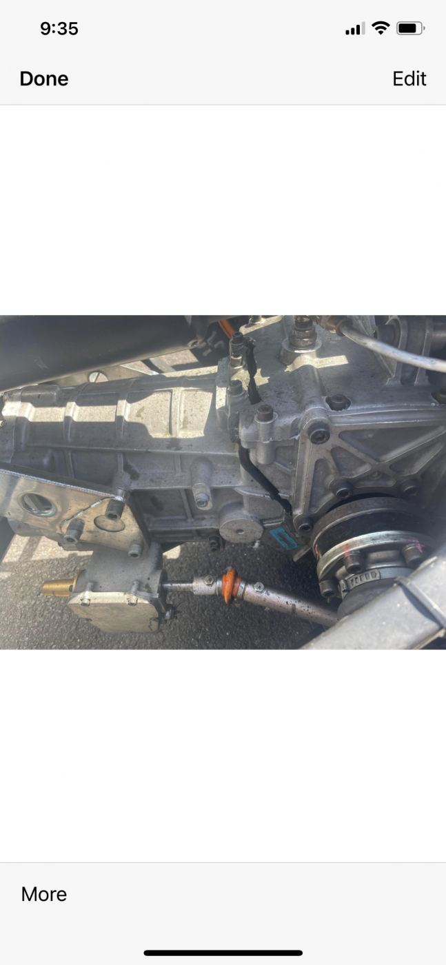

flatchat(Chris)
At a recent meeting in Bathurst (mount panorama Australia)
A GT 40s competition came to an abrupt ending

That looks like the ZFQ that I used data from on the recent transaxle thread on here, apparently a repeat offender.
There was not much oil released there ?.
I think it bled fairly well (most of track) and was cleaned up for photo presentation :cool:
looks like smashing 3 rd gear must have pushed the gearbox off

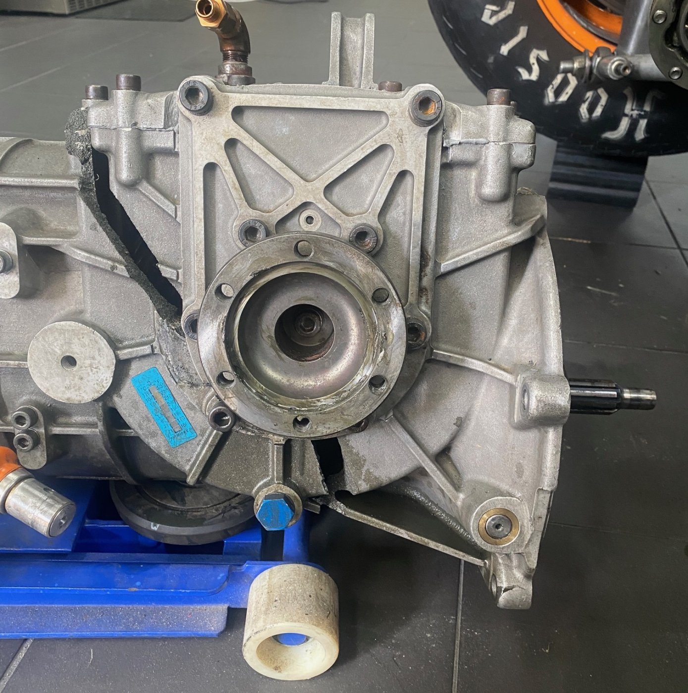

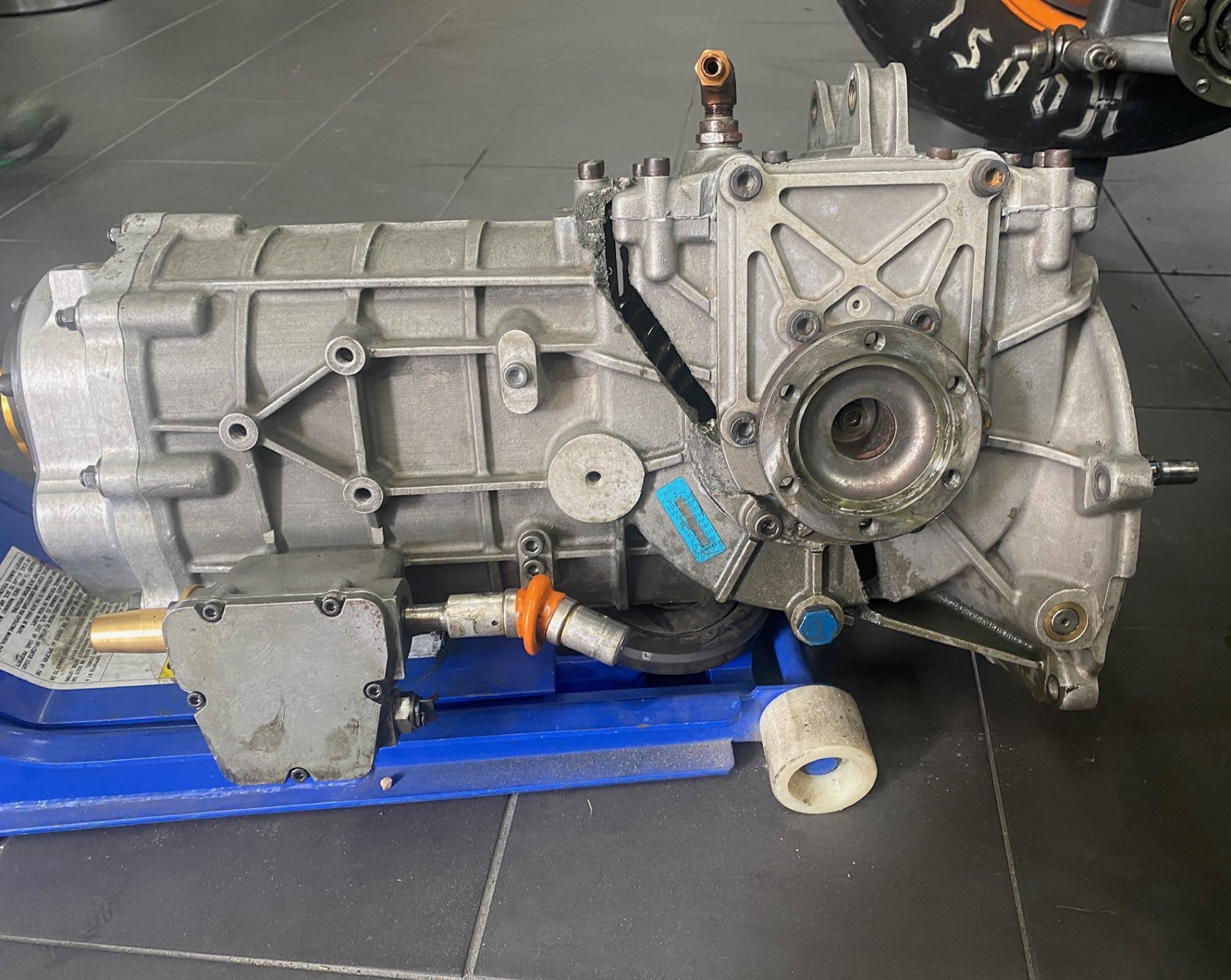

Yep its my GT40, the ZFQ broke in half as it had just been rebuilt diff and gearbox. The gearbox has been rebuilt several times as it is a track car. I have had a discussion with Olthoff Racing in the US who have had experienced similar stories unfortunately. We are going to investigate the box to find out what has happened. I'll let you know.

Ha was getting into it, 250+ Conrod and smooth changes at 6800rpm and pulled 3rd then out of Hell Corner and the party was over….
