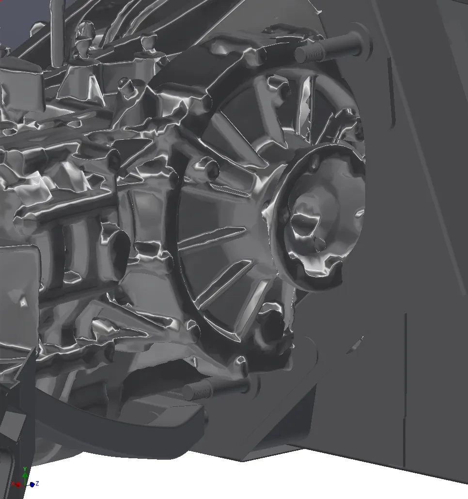

If you are willing to relocate the engine slightly and ideally modifying the "horsecollar" it should be possible to fit a graziano. The picture is with the engine in its original position (if i recall right) and no steel modifications.
