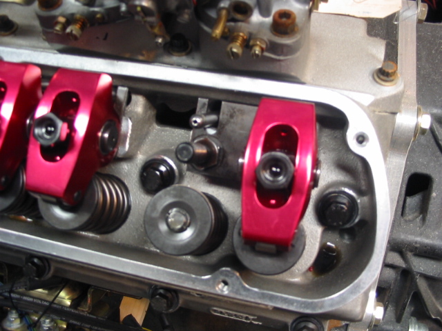

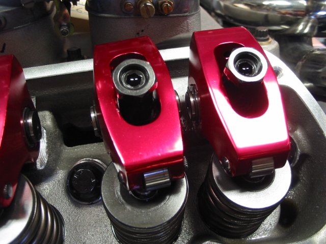

When we pulled the "Ford Racing" valve covers to fit the Guerney Weslake covers we noticed that a couple of the rocker arms were not centered on the valve stems. Turns out the wrong push rod guides had been used on one cylinder which had a wider opening than appropriate. The problem was obvious even to my inexperienced eye. (Not sure how that happened, since they come in sets. Indeed the offending piece was even marked differently). We contacted Lloyd and he was most helpful, promptly sending a replacement guide plate and detailed instructions on installing it.
One of the sentances in the directions noted that if one places a straightedge across the boltes securing the rocker arms they should all line up fairly close. Tried that. They don't. So that is another issue we will have to explore. I don't know how much variation would be deemed appropriate, but it looks like as much as 1/8 inch variation.

The first picture shows the mis alignment, the second taken while we were replacing the guide.

Chuck, those are the same rockers on my motor,replace them! they are poor.Hold one in your hand and feel how sloppy they are! They look pretty all red but, looking carefully 3 of mine the nuts have rubbed the red off and is eating the inside of the slot.

Chuck, Have you loosened the rocker studs and tried moving guide plate around?The hole is over sized just for this. Several of mine looked just like yours that I readjusted with good result. Thats all yours may need!! But I would also replace those rockers! It was while doing my readjustment that I noticed the other rocker ploblems.

I did replace the guide plate. It had a measurably wider opening than the others. The fit appears appropriate with the replacement - which now matches the others.
I am interested in what rocker arms you will select to replace the red ones. Based on what I saw when we replaced that plate, I had some concerns about the quality of those rocker arms and/or the quality of the assembly and you have confirmed my concerns.

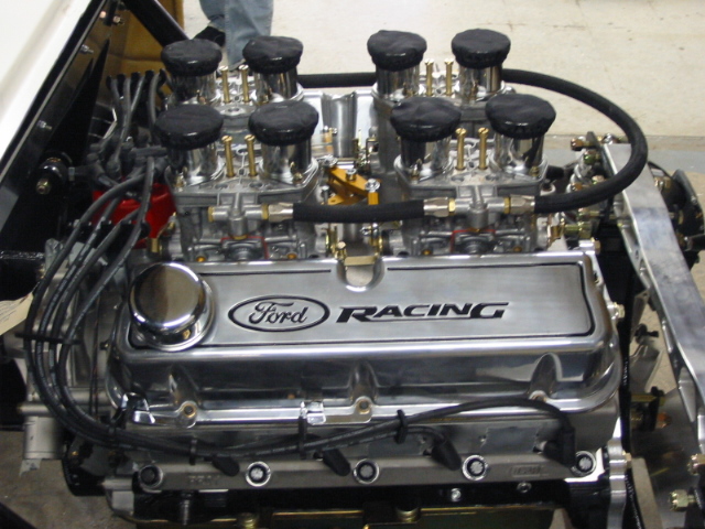

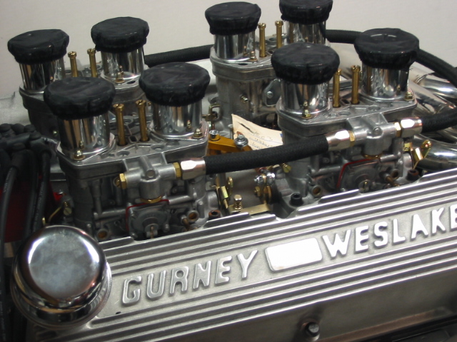

A couple of pics are attached. One as delivered with the Ford Racing covers and the second with the GW covers.
Chuck
