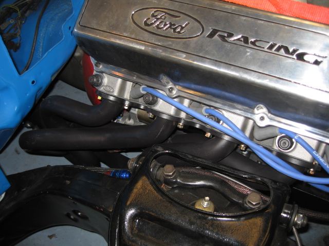

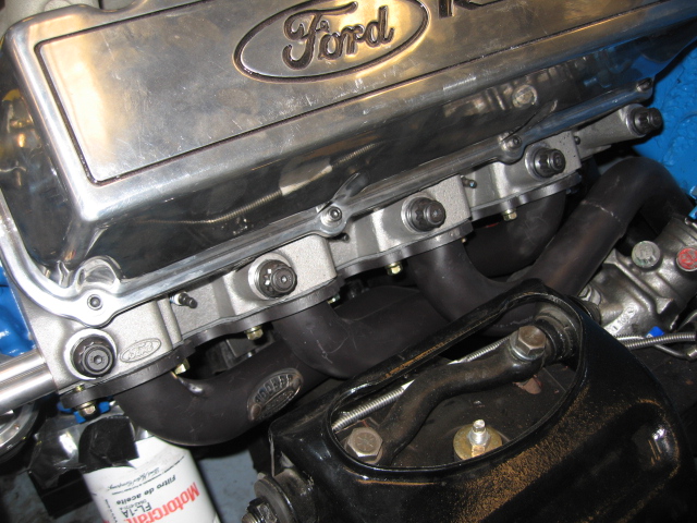

A lot of work got done in the last ten days or so. Back in put together, tank in, front clip on, Z bar in, and the car went to the shop for headers. Headers were a big deal as there is scant room in there for large primaries and collectors. Have pictures of them tomorrow when the car comes back.

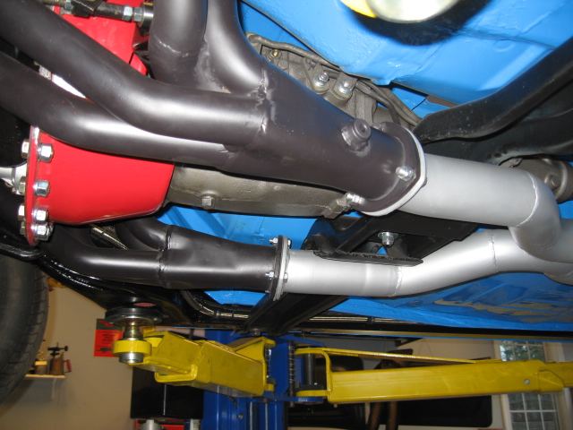

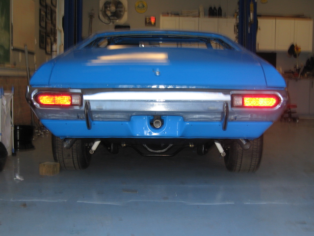

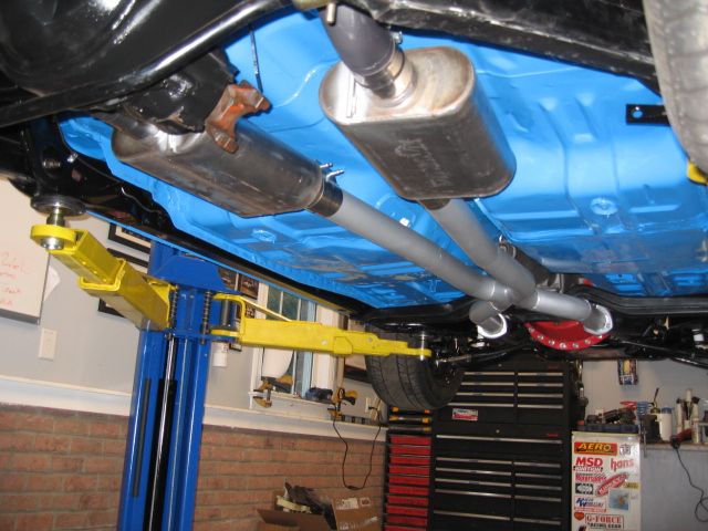

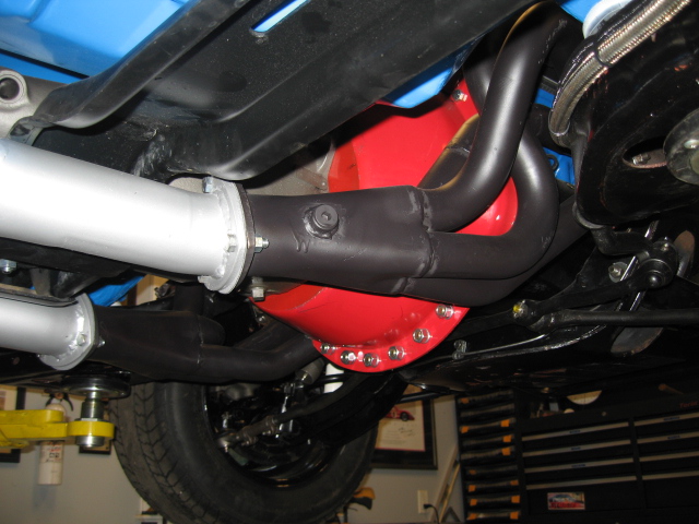

Well, a lot more progress was made over the last few days. My exhaust gurus at R&J Welding in Apex did a fabulous job on the exhaust (a Camaro they did the exhaust for is going across BJ today). They had to make a lot of modifications to the headers but they are on the car and look great. 3" duals, X pipe, and using the Dynomax Ultraflo Welded mufflers which have been shown to have the flow needed per side that the calculations predict (> 750 cfm per muffler). Everything fits, but it is extremely tight, especially around the Z bar.
Nice job with the system. Tucked up tight and isn't visible at all from the side, even with the current 4x4 righe height. I'm really looking forward to hearing how this engine will sound.

If those headers are not Ceramic Coated - I would urge you to have this done now rather than pay the price later... The paint, regardless of how good the preparation and application, never holds for long...
