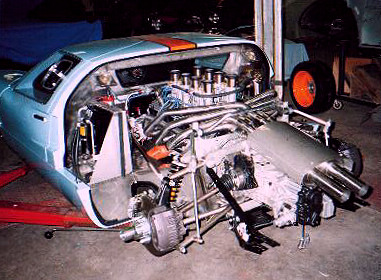

The complete drivetrain is in!! Headers are on (good thing CAV numbered them). Should have its first start up today. Next few days will be fine tuning, adjustments, bleeding of lines etc. I hope to take it out around the block a few times this weekend. Also have made a stainless steel heat shield over intake and in the process of making a heat shield around weber carbs and carb deflector over the top of the carbs. Next week it will be titled and plated. For now using a dealer plate.

We have had to make a number of adjustments/improvements to get this car pretty much perfect. A lot of work on the clutch to ensure it's smooth as silk and with minimal leg fatigue, pedal adjustments to get more room between the brake and clutch pedals, quick release steering wheel for easy access, better pads for front and rear hoods to protect body work, to name a few. This car according to the mechanics is set up to race LeMans. Maybe 1 day.
What did you do to get a better clutch feel? Mine seems overly stiff, at least compared to what I've driven before (which does include Skip Barber's Formula Fords. I'll get used to it eventually, but I would prefer a little less pedal effort...

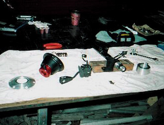

Where did you get the parts for the Quick release steering wheel. What are the part nimbers.

We've put a lot of effort into making the ZF application work as smoothly as possible. I can send a list of parts and methodology to you. Please email me back on your own email.
Although CAV has been turning out GT40s for quite a while, the first car for any Distributor or Dealer is the biggest challenge. I have to thank Frknfast for being so patient.
That said, the build quality and materials in the CAV GT are absolutely top shelf. We had to be sure the drive train met those standards.
The real excitement will come from the driving experience (after you recover from the visual impact and sound!). I'm sure Frknfast will keep you posted:)

Hi Vic,
The Quick Release Hub & Steering Colume Shaft End are all race car parts you should be able to buy from any local racer supply. We have chosen an anodized, push button type with a hex drive.
I wouldn't recommend a spline drive for the street. With a six sided post to slide the wheel onto you'll always end up with the steering wheel strait. Since this picture was taken the end of the hub has been painted black and an "UP" indicator arrow added.
The aluminium collar with turn signal trip post must be discarded plus there is welding and machining required to make it all work. It's handy to have a lathe and mill in your shop, saved us a lot of gurking around.
We can modify your colume for you if you like. Let me know at: [email protected]
Enjoy your ride, hope we can all meet up some day:)

Well guys the trials and tribulations continue. After getting the car to the local show and shine (see show time post) there was trouble with the clutch. Took the engine/tranny out of car and disassembled. Found out that the brand new throw out bearing was shot. The clutch line was replaced to a hard pipe system with only a little bit of flex pipe and the ends only. The factory flex line is no good, too much expansion. Also did a bunch of work to the gear selector linkages and rods to get a better alignment and less play /slop. This car is so well engineered now specifically for a larger engine and ZF tranny that I think we will be able to solve most of others people's issues that CAV has not done. Being the first car in Canada we are going over everything and doing it right the first time.
Next week the ac will be charged, alignment, toe settings, clam shell,hood and door alignments, ride height and hopefully titled/plated.
Well guys I finally got to actually drive this incredable machine on the road for the first time last night. WOW!! This sure is different than my cobra. It takes a little getting used to with the set up that I have especially the twin plate clutch-- no feathering here. Also with the webers I'm finding that the revs drop very very fast when shifting causing a reverse chirp when re-engaging the gear.
