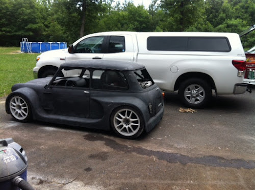

Nothing really to report. Custom JE pistons ordered. LS3 block decided. 3.0" stroke decided. I let him push me back on the crank a month or two to get other customers that needs where higher than mine done as I do not plan to finish it until the summer. I still have not touched the SLC yet and just sits in my wifes garage, which I get remined about often since it is winter. I am still working hard on the mini. I had a race at Road Atlanta for Chumpcar in Feb and that went well, but all racing takes time to fix and maintance so that is in there also. I am hoping to get most of the mini items done this week and then send it off to the body shop for the final prep and paint. Blog is below if interested, but here are some pics. MR2 Mini

It's messy as all hell to do the foam, bondo psrt forming....but FUN! (rewarding) in a sick sort of way. That is one cool mini you are building.
Messy does not even being to sum it up. It is take off all clothes before entering house messy or wife will kill you. The sanding it is the really messy part. Then when I was all done I sounded it away from underneath. Lesson learned, take more time making the buck you are going to pour the foam on closer the final part so you do not have to sand as much away later. The bondo filler is put and take off and put on and take off and repeat until you have it close to where you want. Then you want to change it all around for something else you have in your head and final just agree that it is what you want. I am 95% happy with how it has come out so far. Finishing that up soon.

I also pretty much finished the mini and it is going to the body shop for final work and paint here next week. Then I finish up a few little things and start on the SLC, finally.
MR2mini pics and more info. MR2 Mini
Awesome.
