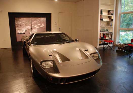

I have the Vitaloni mirrors. As long as you mount them close to the windscreen you can adjust them for zero blindspot. (There is plenty of period documentation to justify this location, including both of the Ford "Would you let your daughter marry a Ford owner" posters.) I left mine in black, as it goes with my color scheme and draws less attention to the mirrors.

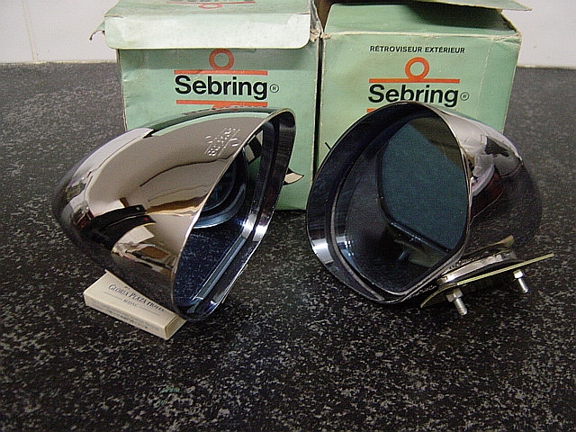

There are a few various sizes of original Sebring mirrors. The pair in the shot are the largest. (same as Victors)

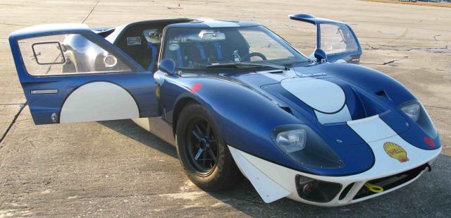

For P/2192 I went with twin Vitaloni mirrors. They're made of some sort of high impact plastic and arrive in flat black. I elected to color match them to the Guardsman Blue body color, also with the intent of minimizing attention drawn to them.
If they used them at all, many race teams mounted their mirrors well forward on the fenders so they wouldn't interfere with the gas filler caps during fast pit lane refueling. I mounted mine close to the windshield to 1) decrease any blind spot; and, 2) not interfere with the clean lines of the hood. No problems with refueling, by the way.

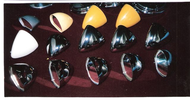

Attached a period picture

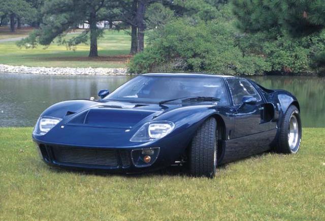

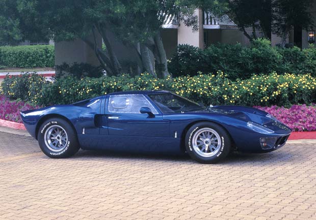

I put 1987 Mazda electric mirrors off of an RX7 on my CAV which I had painted to match the color of the car. Works very well and I think they are the best looking mirrors for a GT-40 bar none. They look like they were made for the car and they looked like they came from the factory IMHO.
JOSEPH
Sorry about the clarity of the picture, but I took a picture of a picture. Oh, if you don't have electric mirrors that you can adjust while sitting in the car it is a real bummer.
JOSEPH

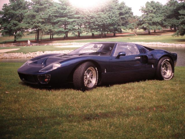

Here are some more pictures of my mirrors. They cost me $50 including the inside control switch and wiring from the junk yard. $85 for painting and I installed everything myself. They work perfectly.
JOSEPH
PS: Jeff. Your mirrors are very similar to mine. They look very good also.

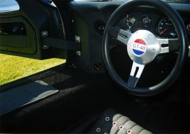

Thought you guys might like to see where I put my control switch for the "87 Mazda mirrors. I originally wanted to place it higher up and to the left, but the panel was to thick so I moved it down and over where it is only about 1/8" thick. I kept it low because I rest my left knee above it. As it turned out the position is very convient to use without having to take your eyes off the road to find it. It is located at about 8 o'clock just outside the steering wheel. What a convience not having to get in and out to make adjustments. Joe
