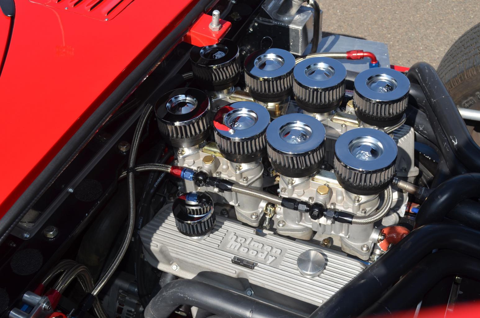

Robert - Dennis Olthoff installed these K&N filters on my Eight Stack EFI. To accomplish that, however, Dennis had to replace the Eight Stack trumpets with another type so that the filters would fit properly. Since I run mostly on the street, I'll accept the reduction in horsepower for the clean air entering my engine.

That is a nice looking setup Dave. I think your car was at Dennis' shop for some TLC when I picked mine up last fall.

Robert are those carb look a likes? sure looked like webers to me.
Yes, they are wanna be's Jack, and they have much more detail than many, and even my engine installer thought they were Webers after I sent him the first still picts.
