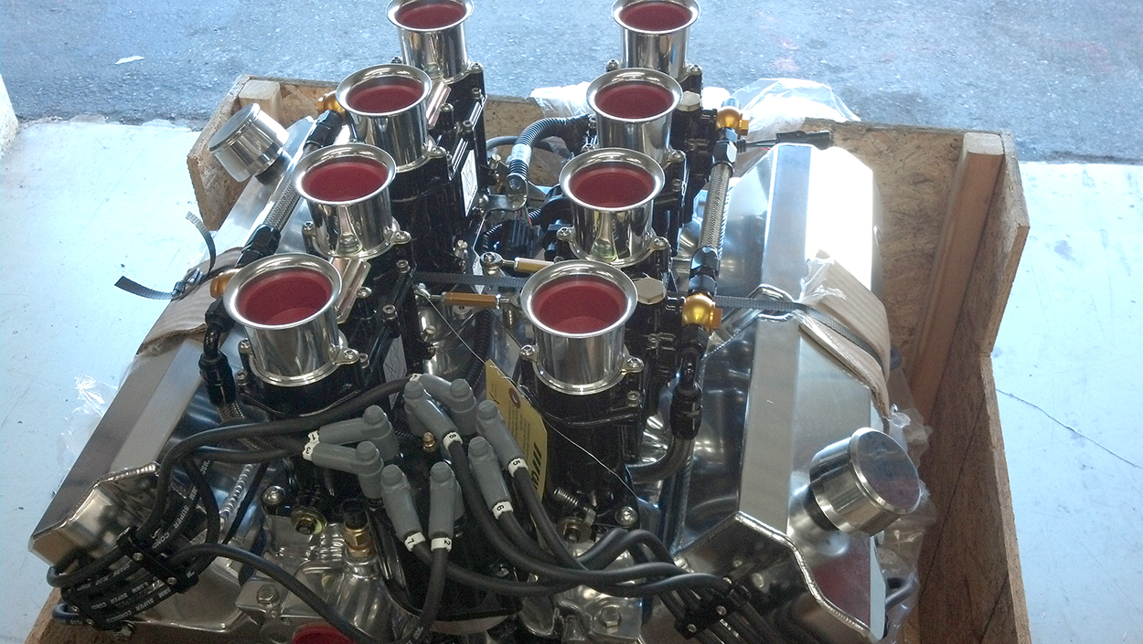

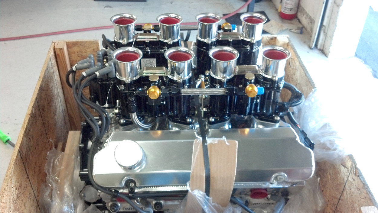

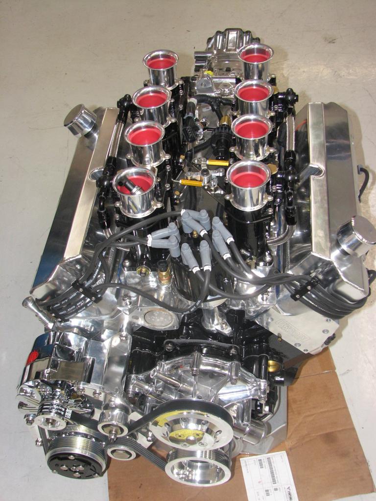

Clamshell Engine Opening Update & Engine Delivery

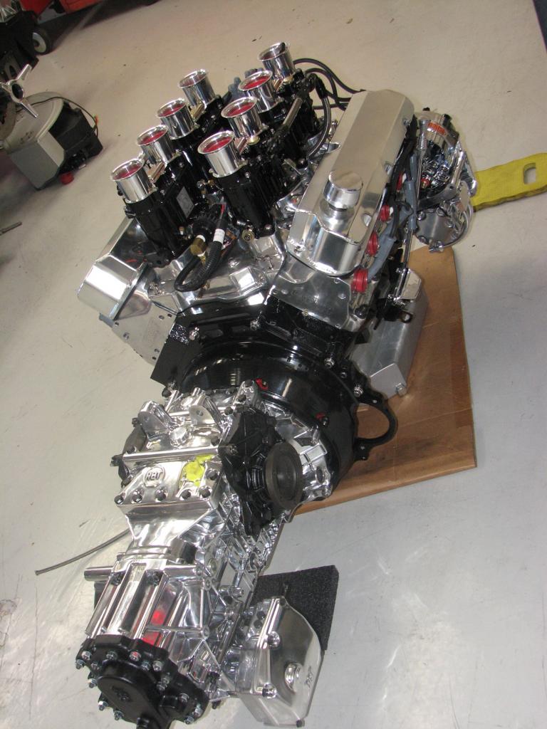

Referring back a couple of pages to several posts concerning intake fitment, I measured the width of the engine opening on the extra wide-body ('69 vintage) clamshell: 13 ¾.” We also verified the opening is in the center of the clamshell and not shifted to one side or the other.
The engine arrived yesterday 17 October, and upon measuring the width of the eight-stack at the widest point it was 13 1/2." The widest point is from the out-side banjo fuel fitting to the other outside banjo fuel fitting, so there may be an opportunity to change from banjo fittings to less wide fittings to reduce intake width.
In reviewing other posts that mentioned the possibility that the fiberglass portion of the engine opening may have to be cut, in looking at it again in person I could not help but ponder, so what. The lip along the edge is nicely rounded, but the subject cantilevered horizontal fiberglass section is well supported and cutting the lip would not make it sag or flimsy, and it should be easy enough to make it aesthetically pleasing. Is there another con I am failing to consider, if indeed, that engine surround sheet needs to be reduced by 1/2" on both sides?
Any additional worthy thoughts are encouraged. Thanks, Robert

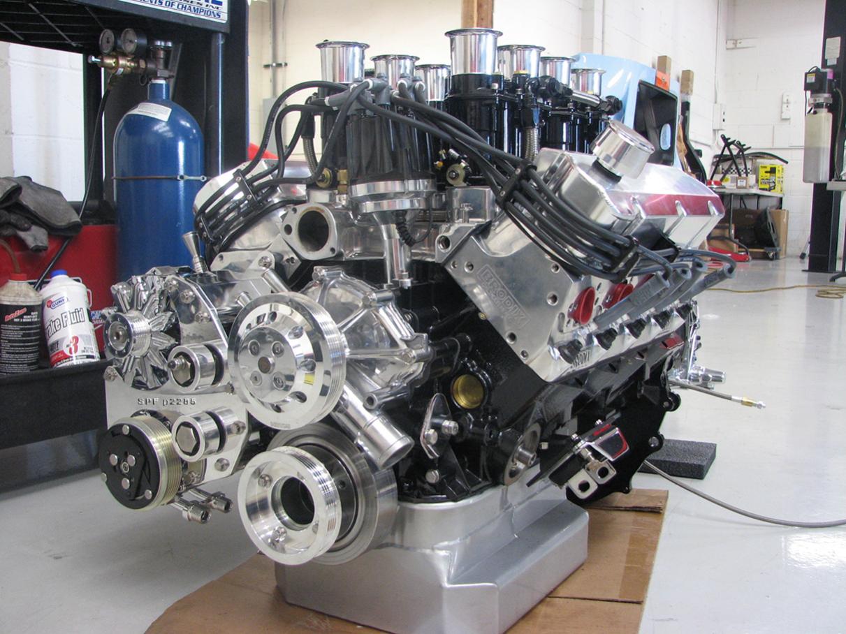

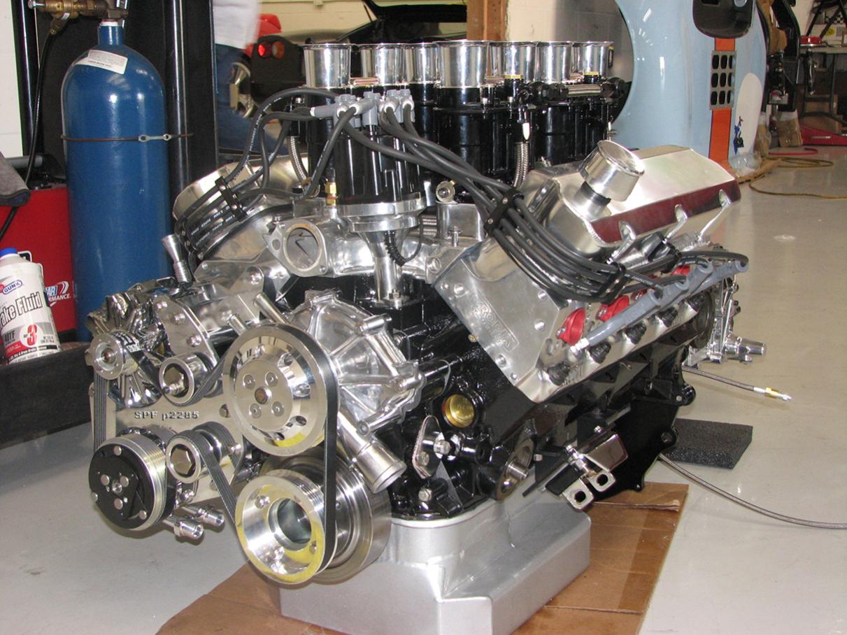

Engine Build - High End Components
Several curious souls have contacted me privately to ask: Did I desire to buy those very extreme engine components, or did someone sell me on the idea I needed them? I was surprised, but once I thought it over the question seemed reasonable. The answer is neither.
Following one particular 14-week time-wasting adventure with an engine builder, I spent another three weeks attempting to locate another engine builder. My original target was 600 to 640 H.P., with a Dart block, and a few criticized that H.P. rating as overkill.
I did stumble onto an engine builder that had a 351w/427 640 H.P. crate engine package at the right price. However, like most things concerning these vehicles they wanted six weeks or so to build the engine and another week for shipping. I said I would consider it.
A few days later they contacted me and said they just had a custom engine build cancellation. The customer was in Australia, and the build ordered was for a 1200 H.P. twin turbo 351w/427. So, they said they kept his deposit and would make me a really special deal on the subject engine, which could be made ready in two weeks or less. I said I wanted the big Brodix heads polished, and they said they would have to change the cam grind.
I ended up with a World Man-O-War race engine block and all components engineered for 1200 H.P., for a song and dance, and that was an offer I could not refuse.
The engine was made ready and dynoed within three weeks - it took a week for head polishing - and shipping required only four week-days, just as promised.

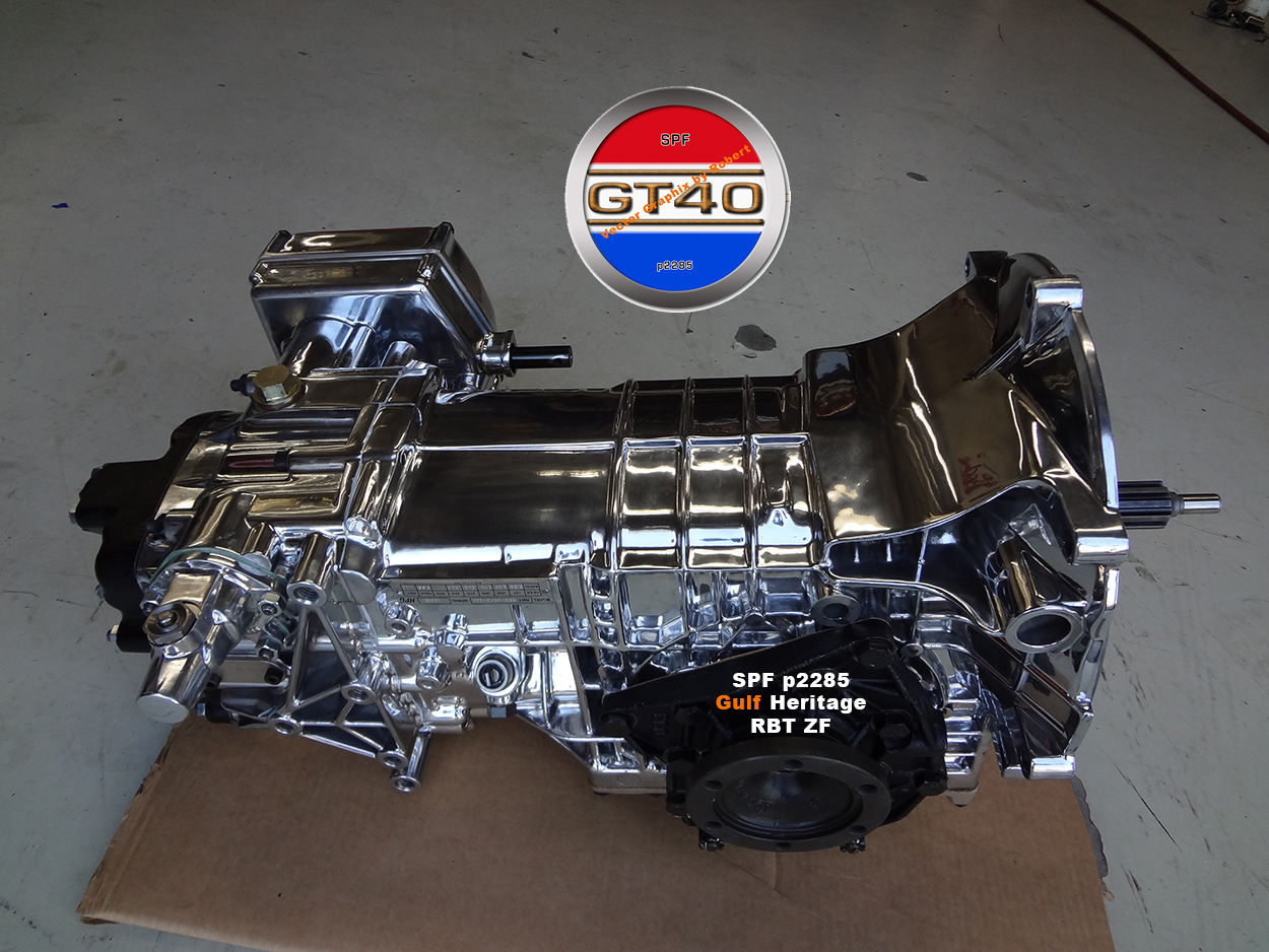

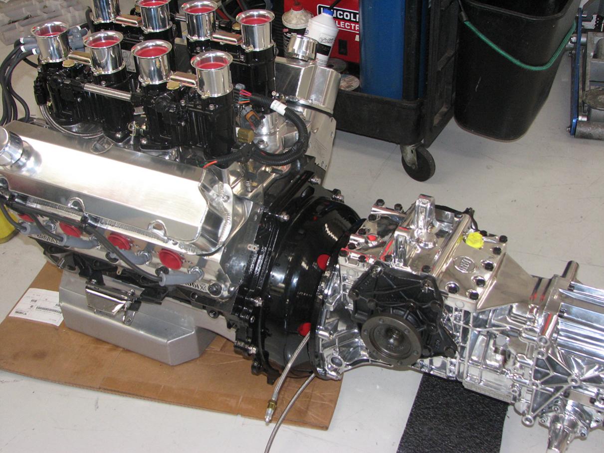

RBT ZF Trans
Trans being reassembled following lengthy difficult polishing project. I can't imagine how they accomplished this due to some grate-like surface areas.
Robert S.
Very nice. What did they charge for the polish work?
Thanks. Haven't heard a word on that subject yet. But, it was a friend of a friend circumstance. I'm confident it will be a good experience.
