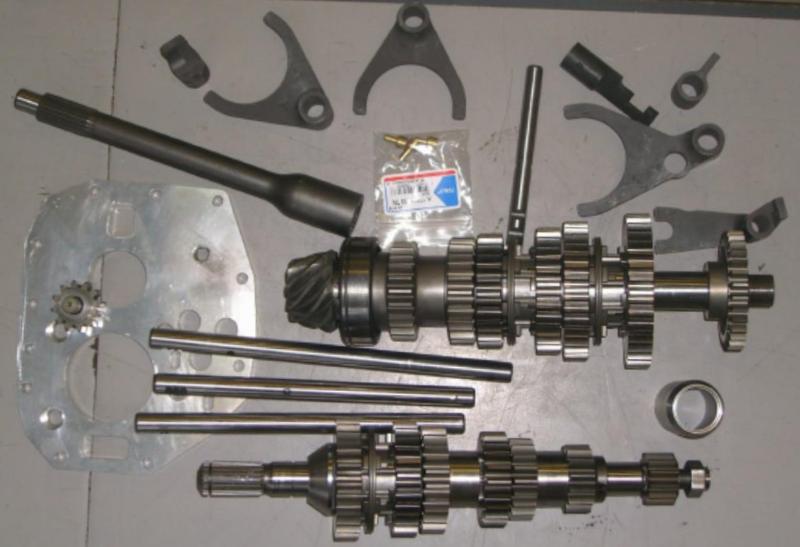

Anyone fancy a 6-speed UN1?
Pic below shows a 'close ratio 6-speed dog gear' conversion that 'drops' into a standard UN1 Casing using a UN1 diff/pinion.
Torque capacity reportedly exceeds 'DOUBLE' the normal UN1 so might be of use to the more powerfull cars...

Yes. How much? That looks awesome. Is it a one-off, or is someone going to give RBT some competition? /ubbthreads/images/graemlins/blush.gif
hi Paul
It would be incredible with a one piece input shaft to finish off the conversion.
Is there a reason that it has the standard style split shaft?
Regards
Chris.

Chris - I suspect the conversion has a two piece shaft as it is available with either a standard renault spline, or a a standard 1"(23) Ford spline. By making it available with two (or more) versions of input shaft, the conversion becomes more compatible - I guess..
Also - looking at the joiner, it looks far more secure than the normal UN1/Renault item and primary input shaft does not neck down as small as the normal item.

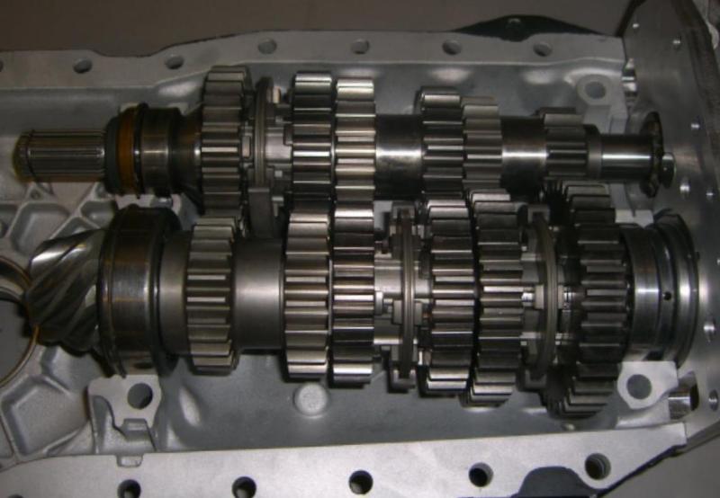

One of the features I like is the short path for the highest torque load (6th) - with 6th gear right up behind the pinion gear, just inside the geabox casing. The reverse idler fits in the rear cover section where 5th gear used to be. (presumably Renault stuck 5th there as it was cheaper to modify an existing 4-speed design that re-design the lot)
I am informed that the conversion has been designed by an F1 experinced engineer and IMHO looks great !!

In the meantime - a view of the 'bits' is seen below.

If I remember correctly the Renault way that the input shaft stub connected to the main shaft was left hand threads into a loosely pinned coller. This new six speed method looks like a splined shaft into a splined housing. Would this be better? I think so.
The pictures I've seen of broken UN1 input shafts all failed at the stress riser caused by the change in material diameter of the shaft itself. This was at a point right after the threads on the gearbox side of the shaft.
A similar sort of thing is at the same location on the "new" shaft right after the splines. The "new" shaft does looks the same diameter as the splines so maybe this isn't an issue as in the original Renault. This would be my bet of where a failure would occur if it did, never the less. I would have liked to see a one piece shaft. Now don't think I know enough about materials or gearbox design to have anything other than an opinion on this. I am only pointing out the little information I am aware of.
The fact is, the "new" stuff is nearly 30 years on in design, and taking into account for better materials and that the spline arrangement looks better than the threaded Renault method all may be well.
The other thing is the diameter of the shaft itself. I would assume that like other replacement/ upgrade shafts increasing the diameter would also make the "new" parts stronger as well.
Lastly I believe that straight cut gears are less stressful on the cases themselves than the original design. Straight cut gears have less of a tendency to force themselves apart under load. This produces less load on the bearings and their housings in the cases. The straight cut gears themselves do have higher stress loadings, stress risers at the gear face root, but can be accounted for in design.
The best part seams to be the full gear-set 1st-6th inside the cases with bearings on both ends and reverse hanging out back. This in itself would be worth the effort.
I think I agree with the idea that the location of the gears on the shaft in relation to the pinion gear being of the least important design points discussed here, although valid in concept.
I should say that I'm not trained in gearbox design. I have fixed a lot of bike gearboxes in my time thought so my opinion is worth what it cost.
