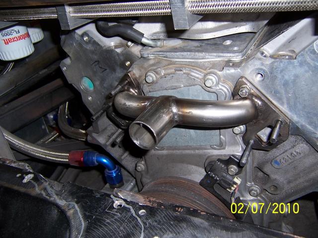

Welding stainless is a little easier if your "ability" is related to skill versus welding equipment. I tried to do a complicated version of this in aluminum, and eventually completed it in stainless after repeated failures and learning.
