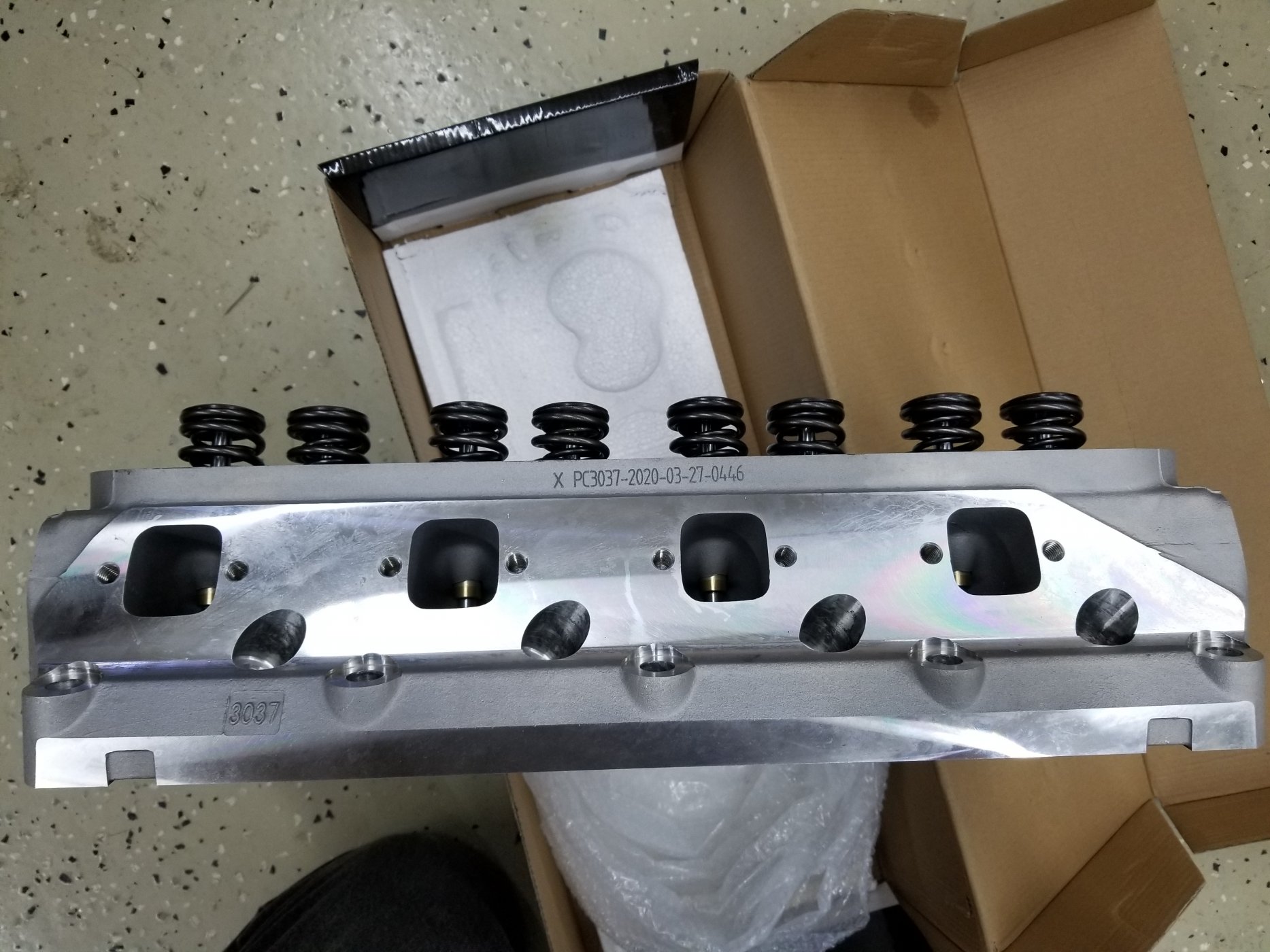

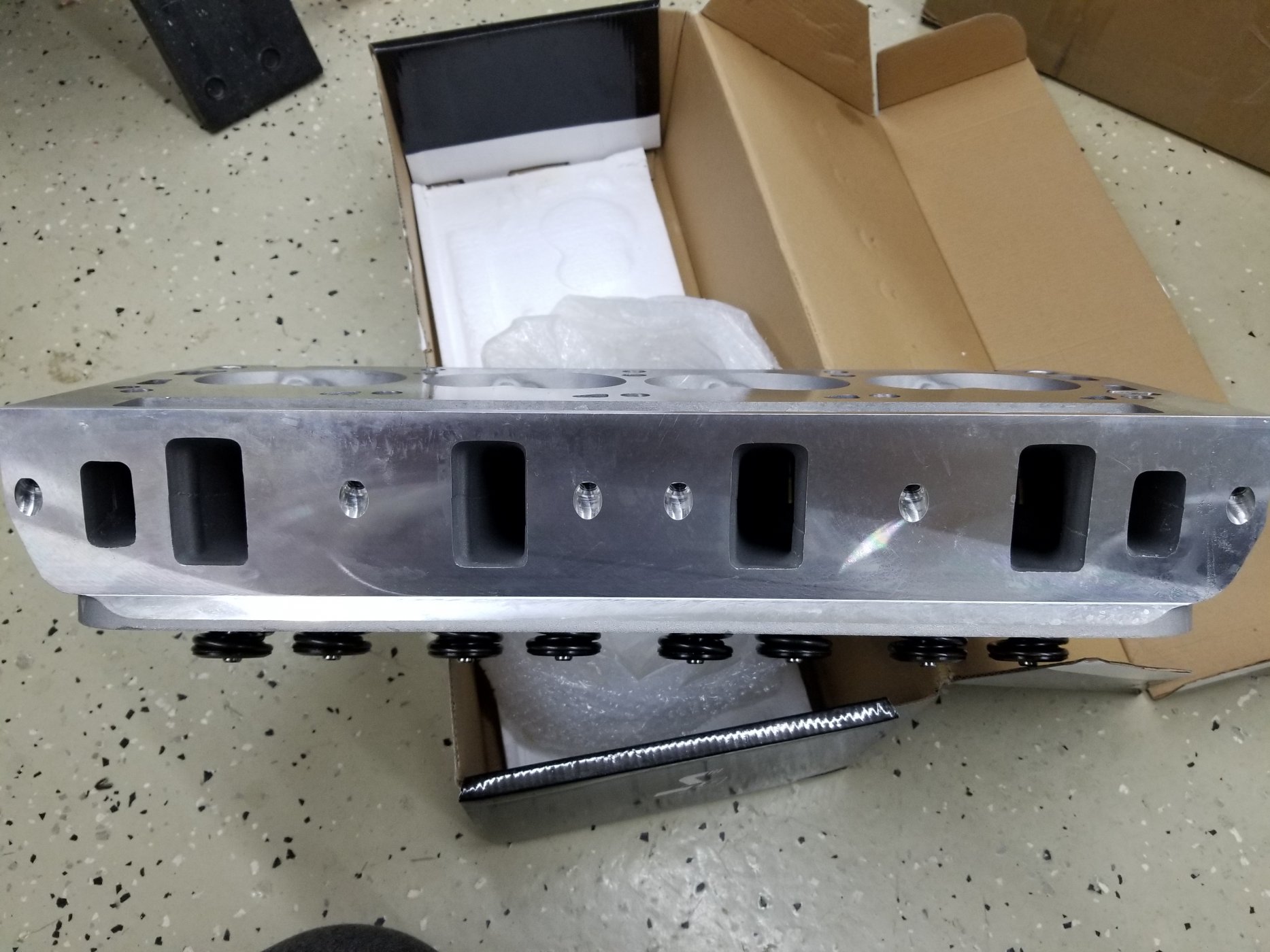

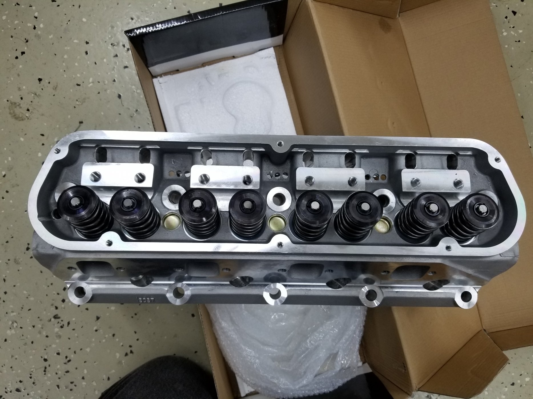

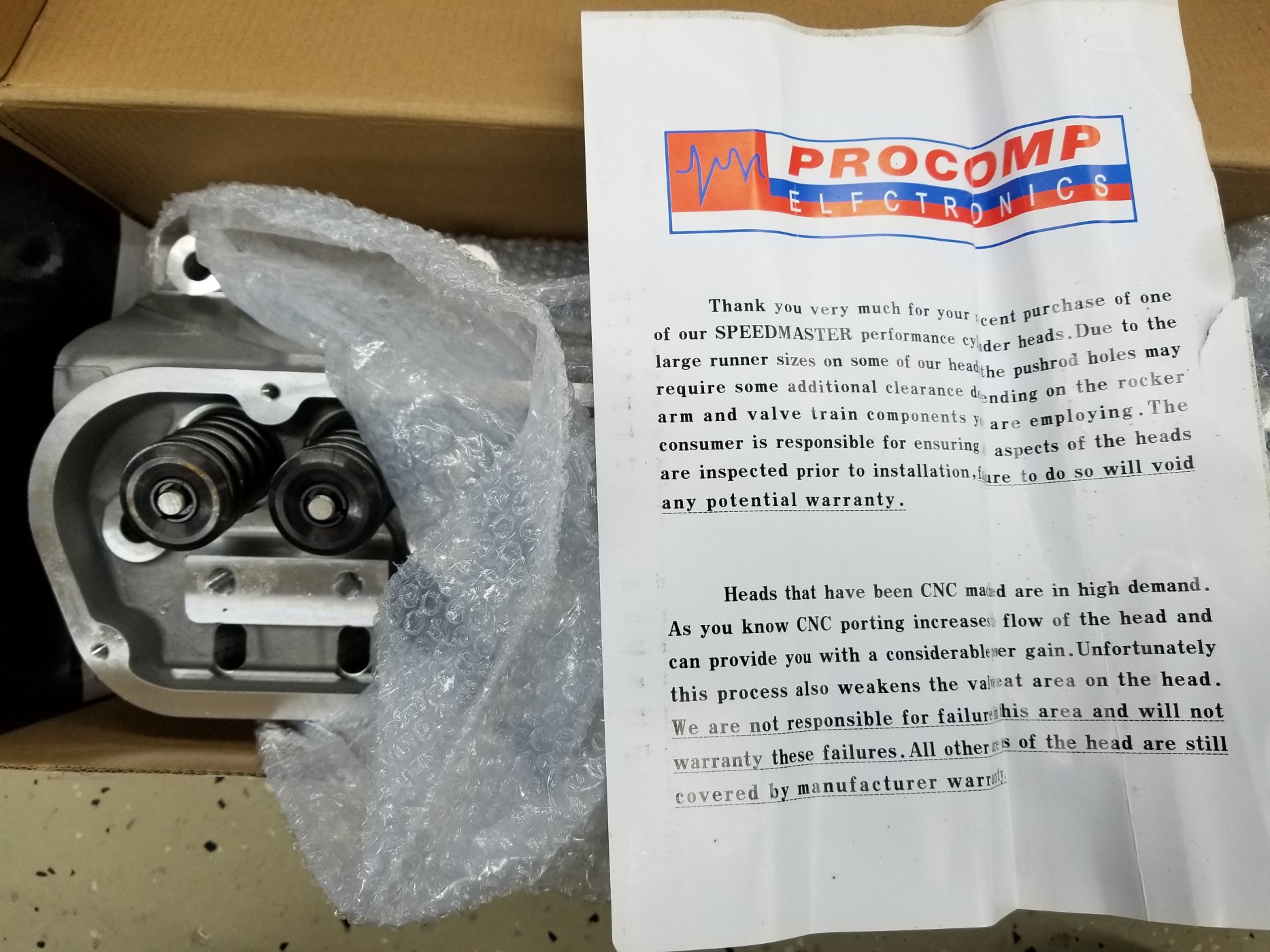

I just built a SCAT 10:1 CR 331 (no dyno yet) for my street rod and I used the 190cc Procomp heads packaged by SpeedMaster.
Other than the heads needing a deburring and cleaning, I can find no fault with them. Also, there were no markings on the heads nor in the packaging that indicated country of origin. At one point I thought I had read that the Procomp heads were cast in Australia. That was a few years back though..

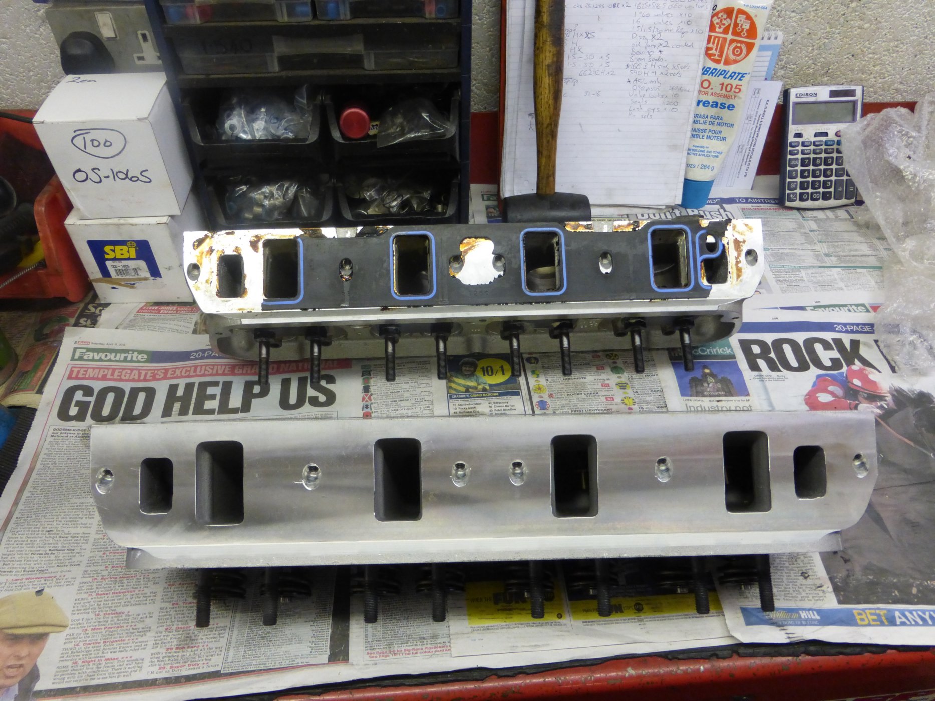

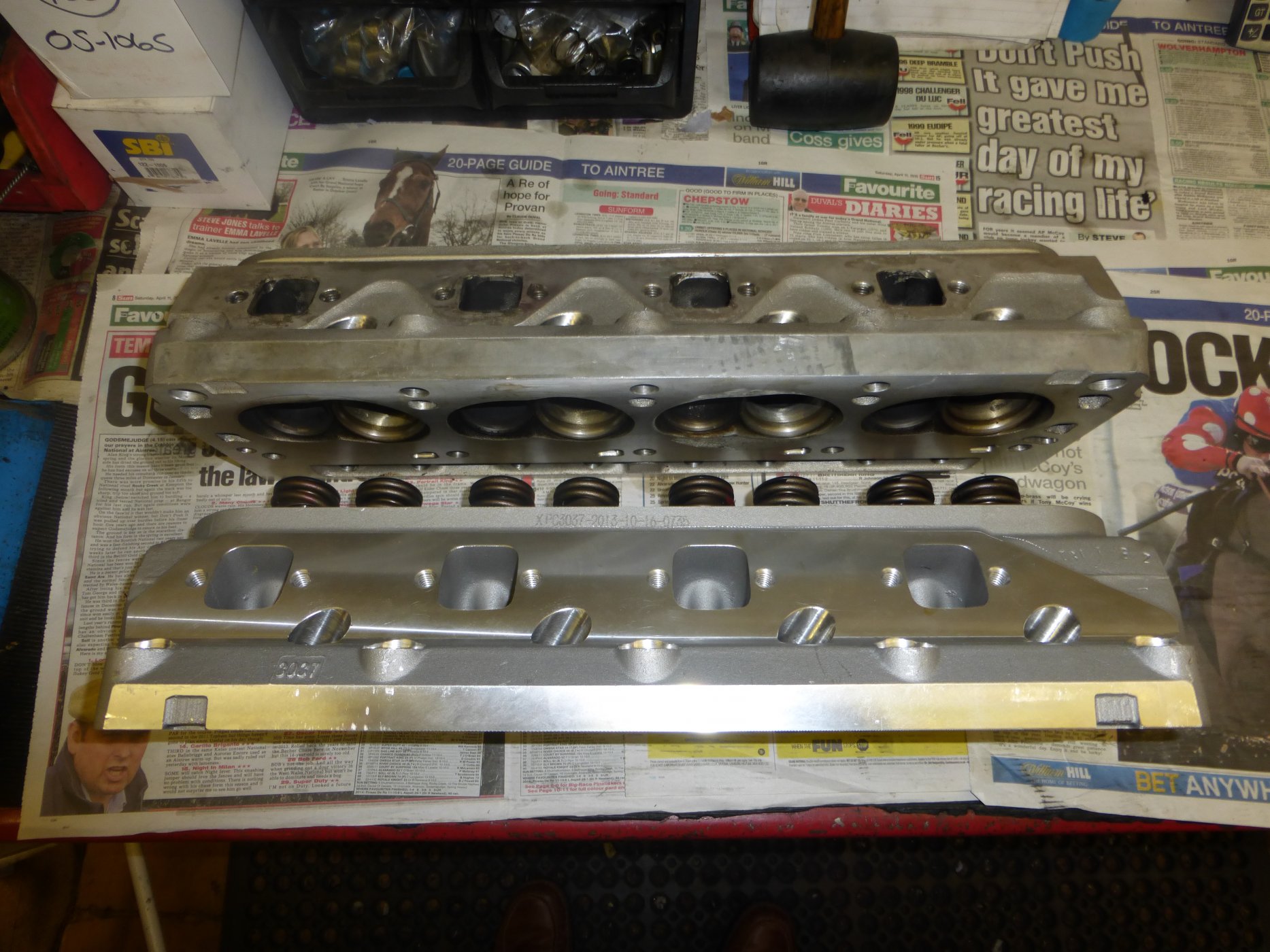

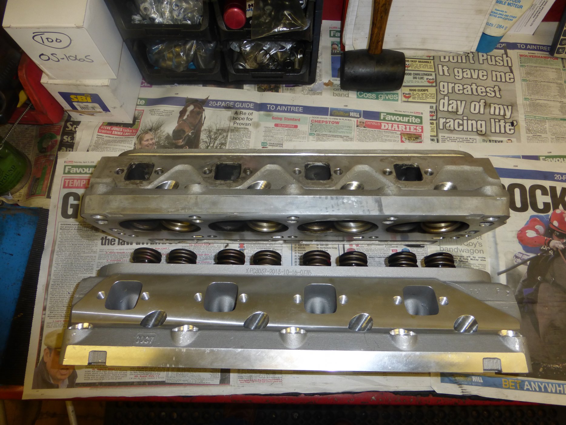

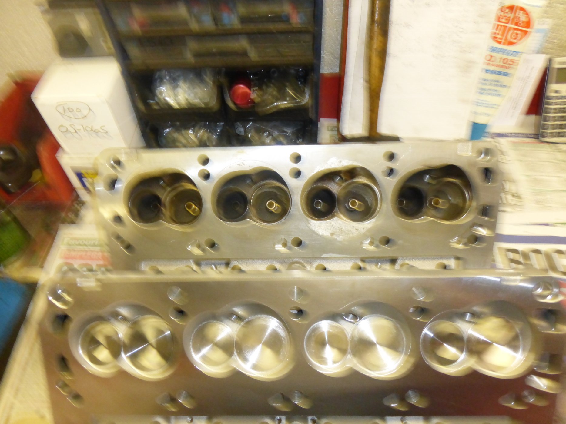

I had pair of these chinese heads a while back. They were "very similar' to the Dart Pro 1 heads. The castings looked good and on a par with the Edelbrocks. However because the valves, springs etc were not the best they were all replaced by Manley parts. I took some pics of them next to some used Edelbrock Performer RPMs. The main difference was that the Edelbrock had much smaller exhaust ports. I did not get chance to try them as i sold them on with some other bits. The engine builder i got them from had not run the SBF ones on the dyne but he had run a couple of sets of the Chevvy ones and said they were as good as the Edelbrocks. They were half the price of the Edelbrocks even with with the Manley parts fitted.
