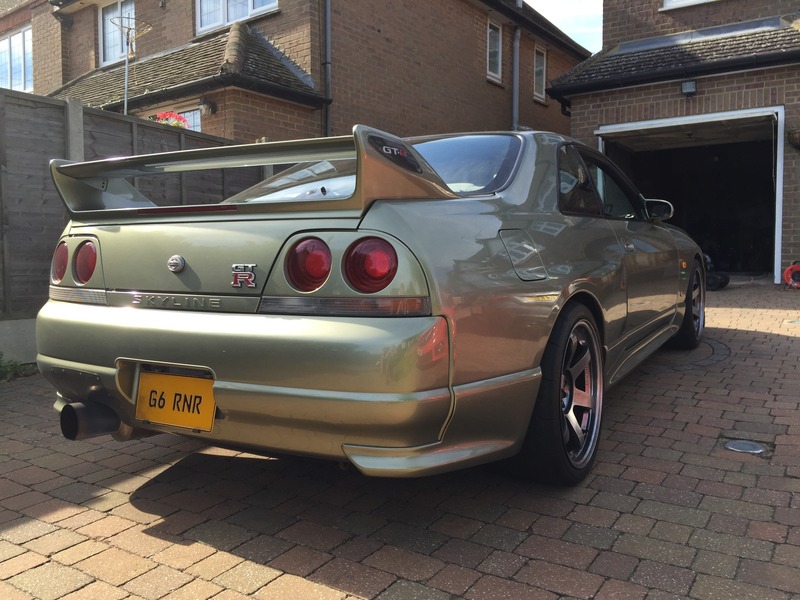

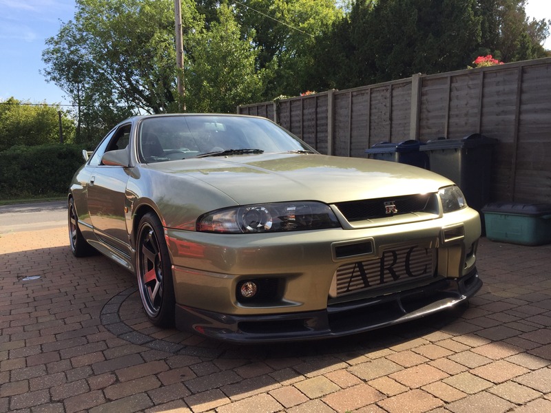

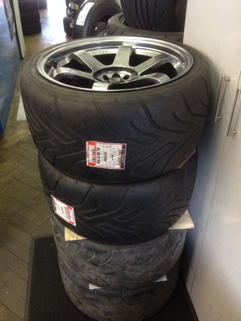

I ran 285/30 on 10.5J 18” and they were flush.
