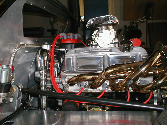

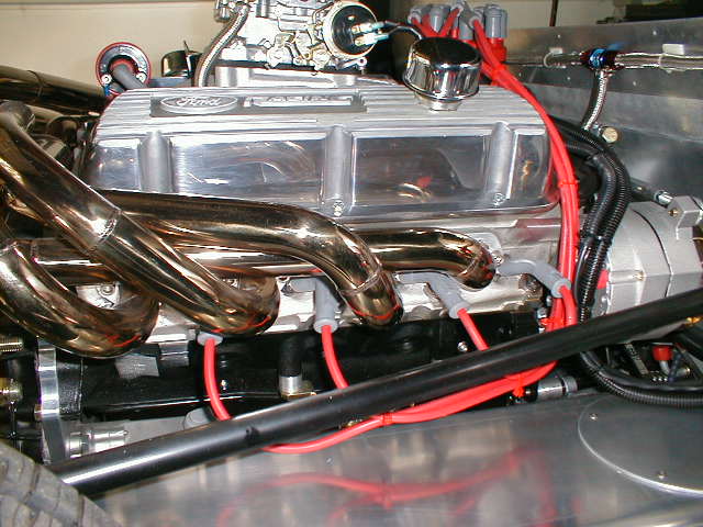

What Transmission are you using?
Are those RCR Headers?

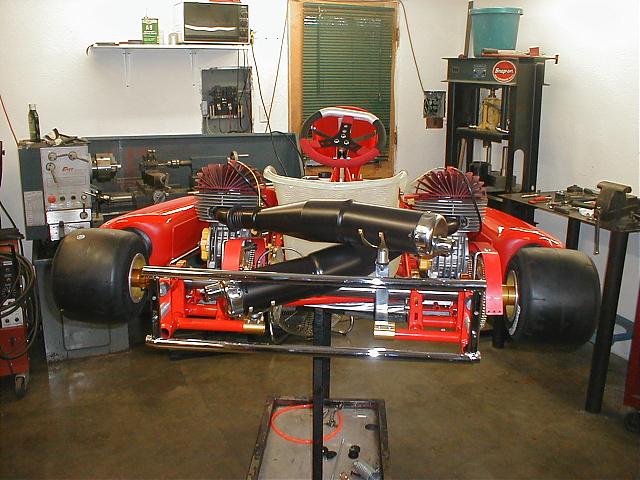

Bill the RCR looks great, but the "real" kart is what caught my eye; is that a pair of B-bomb's or Parillas on there? I raced Komets on Margays back in the late 60's. Do you know if Linda Emmick is still in business? She and I raced the same class and were friends back then, along with Lake Speed and a few others who I can't remember.

John,The Kart engines are 125cc PCR's. I know Linda and they are still in business.Boy are we giving are age away.

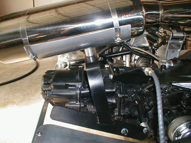

Bill, I used a Ford racing short water pump. Since Audi output shafts sit low on transaxle,the engine sits back further than a ZF.
Since I'm using a G50 trans - I'm wondering where my engine will be located in reference to the ZF and Audi? I understood that the Audi trans made it necessary to mount the engine 1.5" higher in the chassis. Given the angle of the bulkhead, that would move the water pump pulley closer to the bulkhead.
Hmmmmmmmmm......
Watching and reading carefully between the lines... :)
BTW - I raced Karts back in the late 60's. McCulloughs usually. Had a pair of MAC-6's and then 6A's then stepped up to some really weird Enduro Class for a couple of races where we ran a pair of MAC-101's screeching along at roughly 20,000 RPM.. My hearing has been bad ever since..

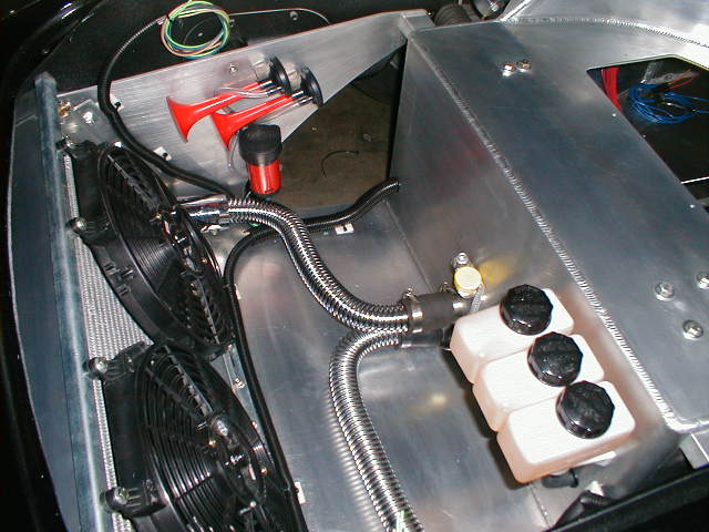

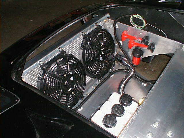

looks incredible in black!!
what do you have mounted above your coolant tubes in the front? i spy a little yellow cap.
Bill, could you post a photo looking straight down at your half shafts. I am fitting the engine and trans right now and I am curious how far forward you have mounted yours. It would also be helpful to know how long the spacers you used to mount the trans adaptor to the frame are.
