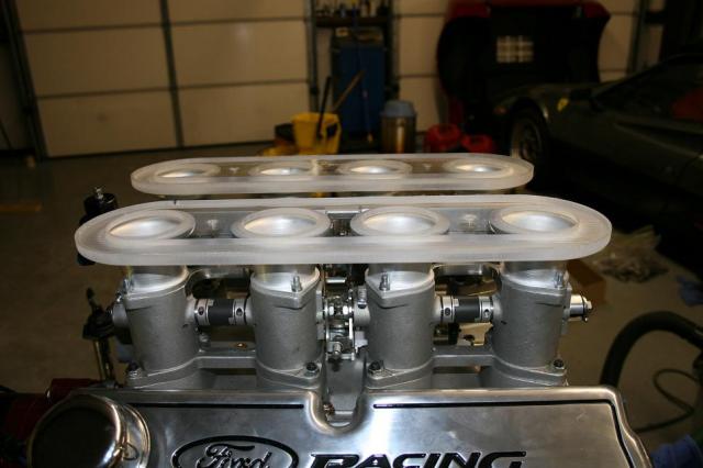

If you ever want a set of clear lexan air cleaners let me know I have a used set. I like your P number, its eazy to remember.

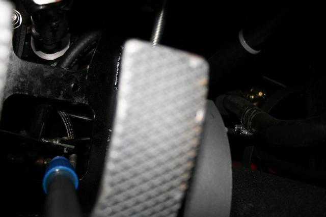

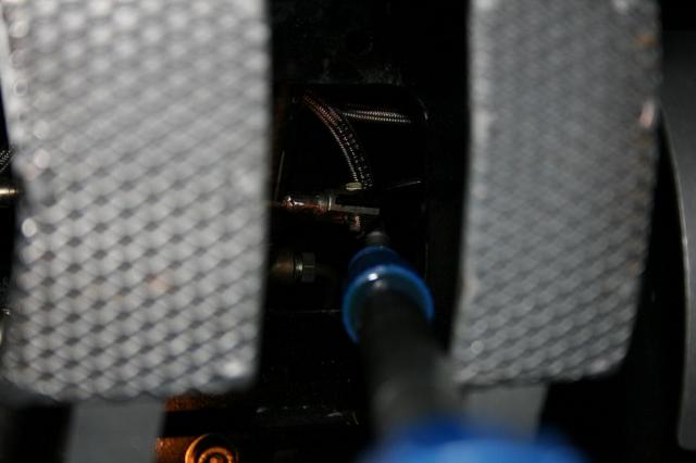

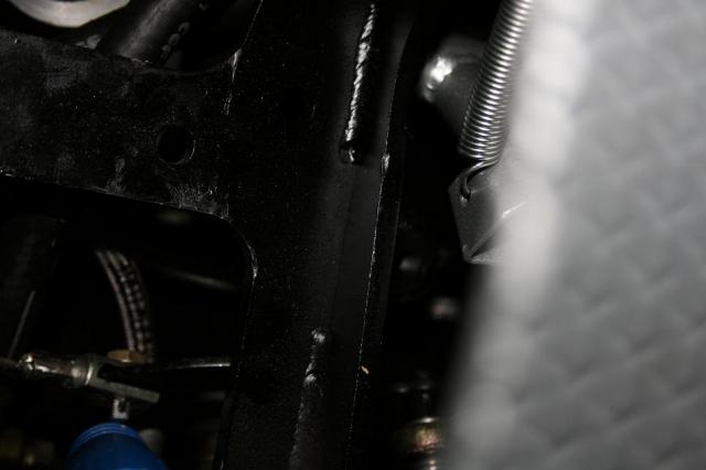

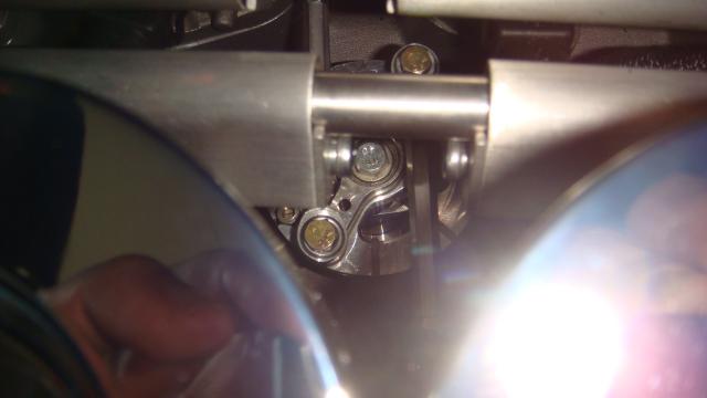

I forgot how hard it was to get to that area, even for taking pictures. I used a mop handle, follow it to the end and you will see the clevis. If its hard to turn on the throttle bodies then thats where the problem is. The main question is "what is hard?" Could be different for different people.

Mike, could you post some pictures of your throttle bodies and linkage? I know many people that have had horrible problems with Weber throttle linkage, it seems they are not all created equal.

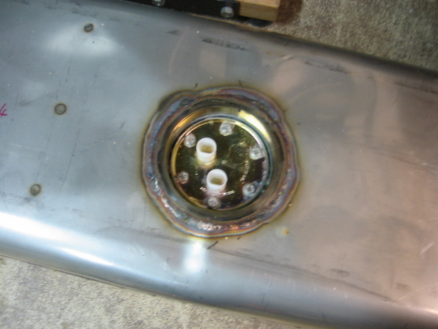

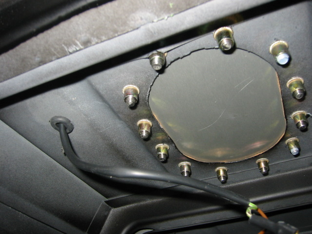

Holy crap there's something I didn't take apart, well maybe next time. You migh want to pull the sending unit and see if the arm isn't bent correctly.
The sending unit is under the oval cover just inside the right hand door. The last picture is a picture of the underside of the oval panel and shows the wire to the sending unit.

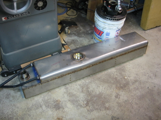

richard, i dont have to drop the tank, do i? i just pop that oval cover and look for what exactly? i wouldnt be able to tell if the arm was perfect or messed up.

Mike, when I calibrated my fuel sender unit I filled my tanks with just over 4 five gallon cans, I think I put 22 gallons, then pumped them out with the electric pump till it ran dry. I only could get about 17.5 gallons out of the tanks, this means we all have fuel in the tanks when empty just can't get it out because of the angle of the tanks and the outlets are above the bottom. I have purchased a capacitor type fuel quantity sender unit, they are stable and accurate. Just haven't gotten around to changing it out. Mike Trusty put one in his car and I liked how accurate it was.

Dave, ebay for $24 plus shipping. Mike, Mike Trustys system works great, I installed it. :) He has two sender units, one in each tank with only one gauge and a swtich for left and right. He only uses the tank on the passenger side for fuel feed to the engine BUT has a transfer pump on the drivers side so he can take longer trips and transfer fuel via small fuel pump to the main tank. The capacitive system is what is used in all aviation and most larger boats. The sender units are cut to length by the installer. The bottom of the sender unit must be just at the bottom of the tank but not touching the tank. Try this link.

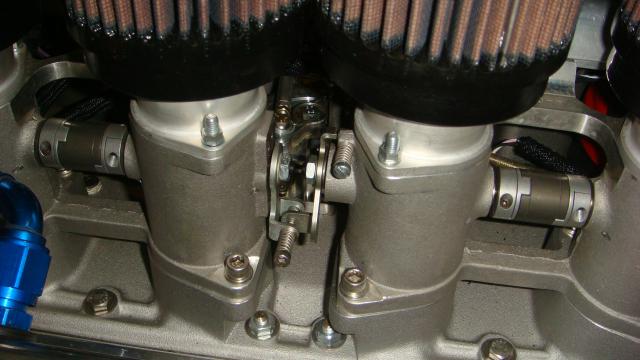

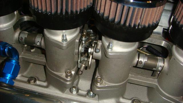

heres a few pics of the fuel injection linkage.....
paul at olthoffs said perhaps adjusting the 2 bars coming off the circular thing might help....other than that he didnt have any other suggestion other than perhaps a spring on the linkage itself.
havent heard back from thor motorsports on if or where those springs are.
its hard to photo the linkage as it all hides behind the fuel rails and such, but here goes....

You have the exact set up as I do, I will figure out how to take some measurements of pressure to articulate the foot pedal. Maybe a scale and stick will work. Mine seems to be very easy. I have been in Mike Trustys car with his TWM throttle bodies and they are the same as mine. You may have a kink in your cable someplace.

yep, thats it......
if you work the throttle by moving the linkage right there behind the adjustment screw, is it still hard to move or easy?
also, do you have an IAC motor on your setup? mine doesnt have an iac motor so there is no adjustment for cold idle etc...
thanks
Mike,
I have the TWM setup which is identical down to the bolts to yours. We just hooked up all the electronics and fired the engine last week. I couldn't drive it at Road America due to a misplaced crossover fuel line discovered on the last day before we trailered to Wisconsin. Mine was the Grey and Copper 40 there. My pedal is tight or stiff as well. I have a few routing issues to work out and an adjustment for the pedal itself. One thing to consider with your pedal is, is the fulcrum of the clevis located before the top of the arc that it goes through when you depress the throttle. These have to be located just before the top of the arc or the cable will bind on its entry/exit to the sheath. Mine is too far ahead of the arc and I will have to alter the rod ends to get it closer to the top of the arc. My setup uses a push pull setup(see DRB#5). Also, I measured the lenght of the cable as it unwinds from the round device on the intake manifold. It measures nearly 3 inches. If you lenghten the shaft at the pedal, the down side is the pedal will need to go further to reach WOT. Three inches is about as long as you want to use. Gets tough on the ankle. The good news is that the work required is less(basic geometry). The other less easily done thing is to increase the radius of the mount on the intake manifold.
I have noticed that to open the throttle bodies at the intake manifold, requires a tremendous effort. Either the springs on the ends of the adjustment rods(idle set screw area) is too stiff or the mechanism that links the throttle bodies is too tight. I will contact TWM today or tomorrow(on call today and tonight) and get their thoughts as they shouold have delt with this before. They are the company that furnished the FI setups to the Roush motors. How do I know? That is what held them up for two weeks when I ordered mine. If they aren't able to help us, then I will contact Roush to see if they experienced this problem and how they handled it. If your is a Roush setup, give them a call and post the response here.
