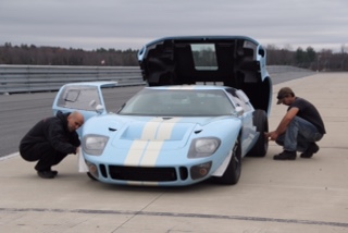

Latest problem is the right front bearing loosend after 500 miles and is shot, will see if hub survived. Imo its a result of poor qc in SA.

I can slo say that at 550 miles the right front bearing started to loosen, or I should say the retaing bolt did and the wheel was on its way to departing the car, the damage we will asess soon, possibly the hub.. Once again I have to say lackadasical QC in SA.
One of my friend had the very same recurrent issue with his SPF, on front and rear bearings...
He had some sleeves machined, installed them on the hubs. This needed a change in the size of the wheel bearings (larger). Problem solved. Not a so heavy job, if you have a good machinist (PM me if you want his contact details, to get more info...)
ad some sleeves machined, installed them on the hubs. This needed a change in the size of the wheel bearings (larger). Problem solved. Not a so heavy job, if you have a good machinist (PM me if you want his contact details, to get more info...)[/quote]
Pm sent
Sean
Sean,
Your problem sounds like the bearing retaining ring came loose. It is held by 2 small allen head screws. I would not jump to having the hubs machined with larger bearings unless the bearing fit to hub is truly too loose. The loose retaining ring would have affected your braking. I do agree we could use bigger brakes for track days, but it will never be like the 1400 lb. Lotus Europa I also track.
Dave
Thanks for the advice. Any other info you may have on track runnign one of these cars would be greatly appreciated. No need to reinvent the wheel.

Holman Moody machined sleeves for my hubs. Why Superformance didn't do that at the factory is a head scratcher.
Dave
Ok our solution is a new locking collar that can be scverewed on before but with a small bolt in it so it can be clamped to the spindle, then we are also machining some bearing retaining rings out of better materials.
The locking collar loosened because the tab in the retaining ring failed.
So now the bearing should be held in place both by a locking collar, and a stronger retaining ring.
The question is why otherwise retained bearings come loose at all.
