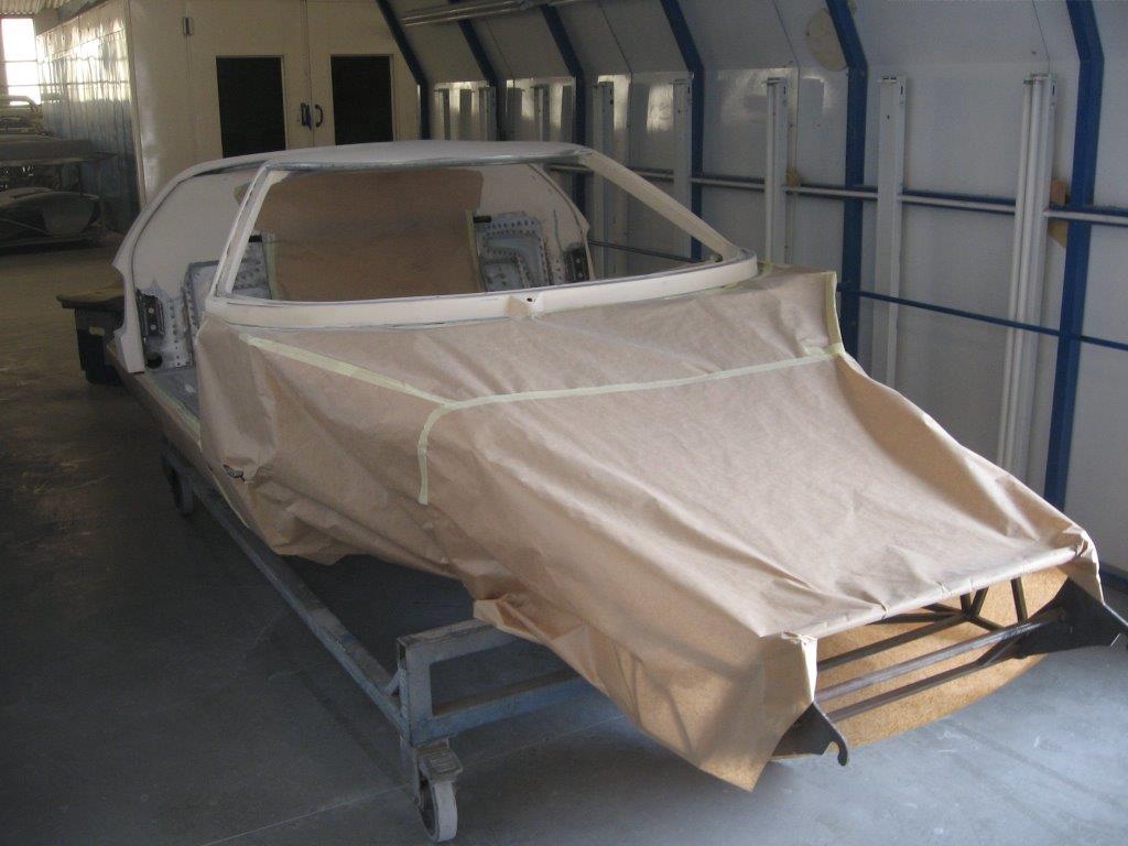

Pre paint today.
Gt40

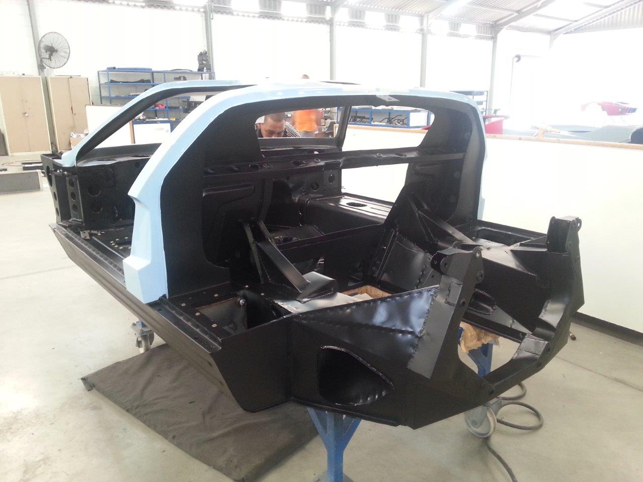

More progress
  • GT40238panels(2).zip

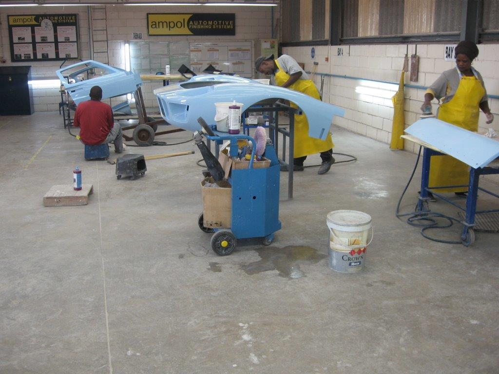

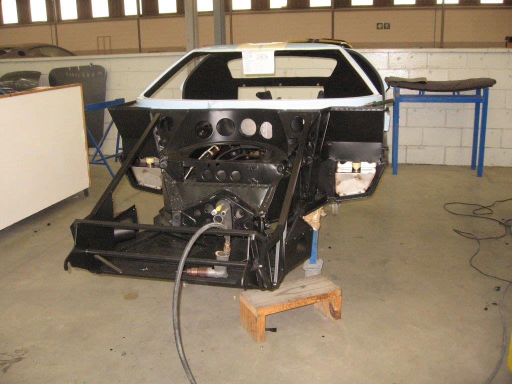

More pics of the day, getting closer

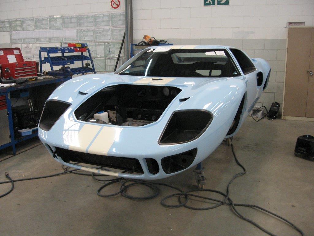

Very exciting Sean! I received basically this same photo of my car on Feb 12. Within two weeks of that, photos of a complete car waiting for a container. I'm hoping mine has already found it's way into a container....or will soon.
- Jeffrey

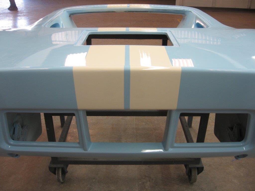

Pic of the day, apparently shipping is by month end and 5 weeks, all things being equal I could be driving by mid June.
