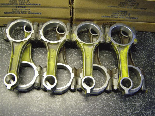

Do you know where these fit in the chronological order of things??
Being shorter and 3/8 bolts they look somewhat standard and are no relation to the SK rods that we have discussed in the past. What would make these special. Materials, design,????.
JimmyMac
Peter,
I partly agree and these rods look like the same forgings as my HiPo / Boss rods.
The HiPo rod however was stronger than the standard and was broached with oval "football" heads on the bolts and distinct from the weaker specification of the time.

Slight correction James. 289 Hi Po had broached bolt head face on rod with rectangular bolt head while Boss 302 was spot faced and football bolt head. Not sure where the Ebay item fits in the order of things myself, but noted the oil squirt hole drilled into the web of the beam as opposed to the outside position used on the stock rods. Ford used the XE marking freely on this stuff and without some inside knowledge is a bit hard to trace. We have a forum member who was posting some ' inside' pics a while back that may be able to help.

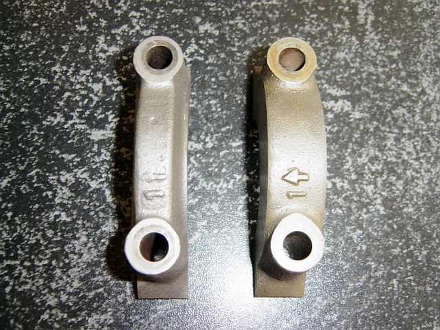

Here is a comparison of the two bolt main caps from a standard block and the heavier HiPo / C6FE.

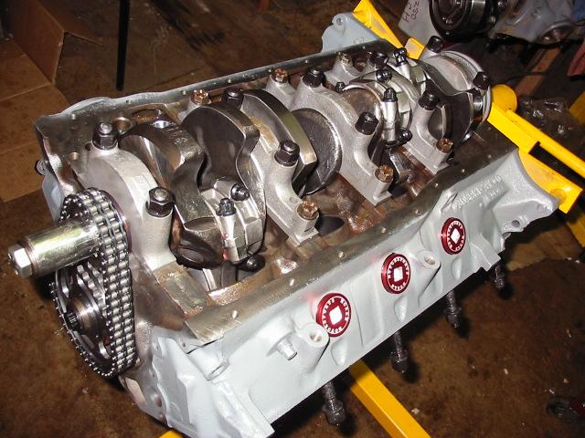

The other shot is the underside of my four bolt XE showing the dowel holes

Aha, that brings back fond memories, although I did not have the fancy core plugs, make sure your cam thrust plate doesnt foul on the back of the roller chain cam sprocket.
