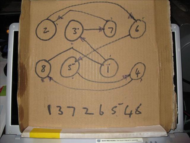

Hi Dave
The picture is a bit rough on a bit of card as my car is , but shows the collectors with the number cylinder in the circles the link lines are the sequence.
The right hand set of four run clockwise however the left don't and run in a Z, if I swapped 5&8 they would run anticlockwise. Don't know if it makes any difference!
Steve
Its the two center cyl that crossover on each bank regardless of firing order, but as doug points out you should endeavour to make them fit in each collector in a circular firing order, this require a bit of pre planning to get the most suitable layout. So for:
13726548 its ..1-7-6-4..RHS set and 3-2-5-8...LHS set.
15426378 its ..1-4-6-7..RHS set and 5-2-3-8...LHS set
Now when you look hard at those numbers you find that the circular sequence works for either firing order as the only thing that really changes is the direction of rotation at the collector and that is not an issue .
