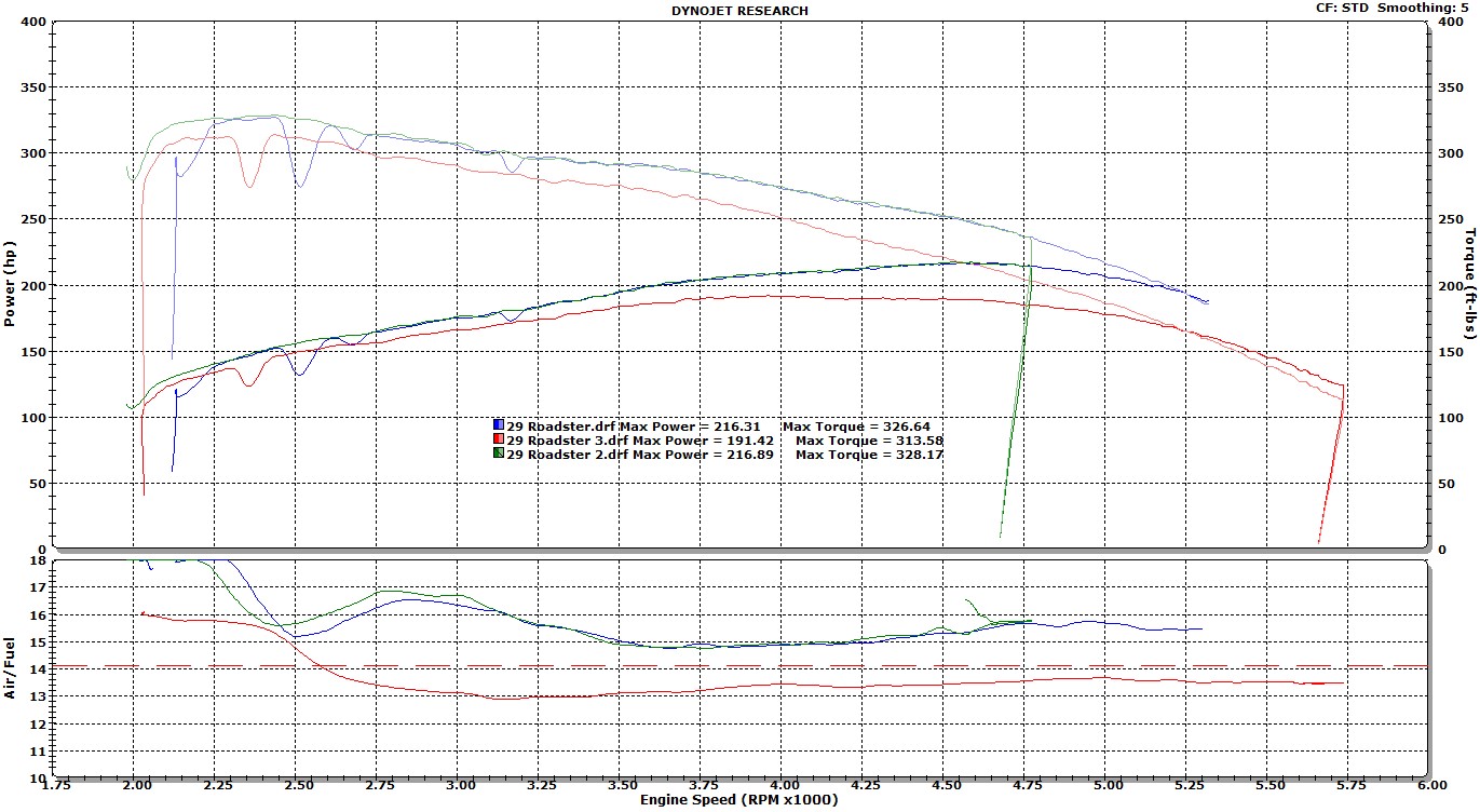

Well the jury is back and the numbers are 215hp and 325ftlbs of torque at 5100rpm I guess time to get new heads and cam shaft bigger venturis my curve is nice and my afr on the main circuit is perfect my idle circuit is rich as hell we did 6 pulls consistent with the same numbers give or take a hp or ft lbs I will upload the data later when I'm near my computer

Yah I think where the ftlbs is coming in at 2500 and pulls to 5100 on the curve my top speed was 140mph I think it is what it is and I'm sure with bigger venturis full rollers and new heads I can pick up some decent gains I was planning on putting new heads on anyways this winter I'm looking at maybe getting those raptor venturis the dyno shop I went to my buddy was running the dyno but if they do a half off dyno day somewhere I'll pop in and get another base pull done and see the difference then average the three I guess but he also dynoed a 383 tbi and it only put 290hp 320ftlbs so I guess I'm not that far off from a stock 383 however my horsepower to torque ratio was much higher then that one I guess that accounts for the nice jack rabbit starts from a stand still
here is the dyno graph
Air fuel ratio is horrible for two of the runs, and not all that good for the other. I target around 12.8ish @ WOT. But sadly a better A/F isn't going to magically create 150 hp.
Your correct on that on no it's not but I can get that air fuel ratio under controls free the winter but no point in doing anything with that until after I change heads cams and venturis
The heads you have should support power north of 350hp, with the webers a bit more , something is holding it back. I think you need to double check what you have in the way of compression ratio and swap in a cam that will allow those extra inches to breathe.
