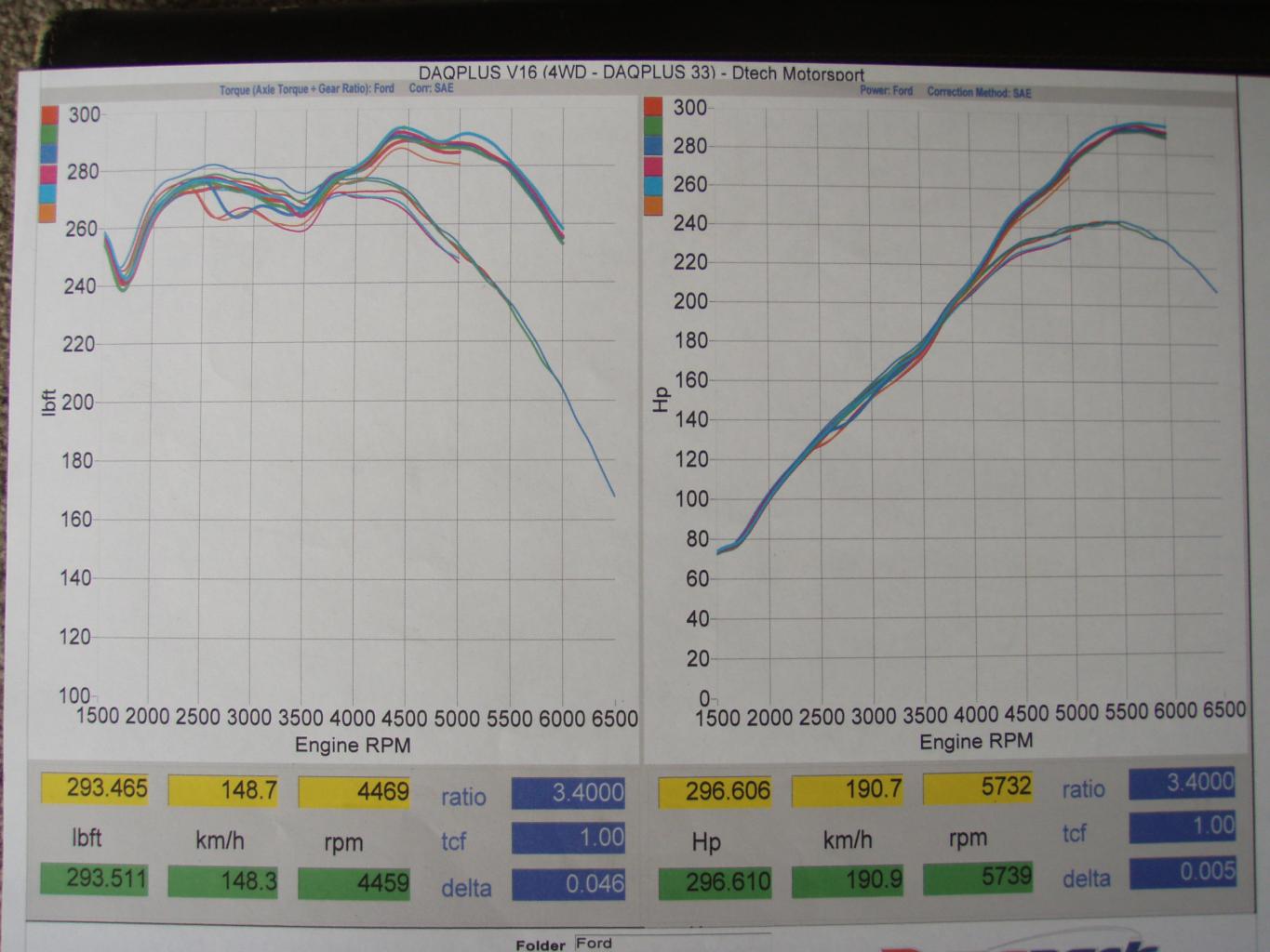

i have just had my 4.6dohc(linclon mk8) engine dynoed with what think are not too bad
results 293ftlbs and 296hp at the wheels.only mods areeight stack throttle bodies,28lb injectors and crossover exhaust system.how does this compare with a windsor.

hi jim, the only figure i know of is the 285hp which i assume is at the flywheel dont know torque.
so i figure my mods were worth 100hp which i thought would be the losses thru trans but i am not
sure of the percentages.the torque starts at around 260ftlbs @1500rpm thru to 293ftlbs@5000rpm which i put down to auto trans type engine.anyway im really happy with what
i have should be easy to drive.

the dyno sheet
