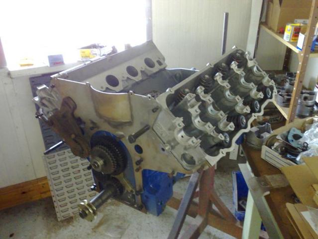

427 cammer?
Somebody told me that this engine is a "427 cammer" wossat then?
FE with Single overhead cam per bank, row of rockers for both intake/exh valves-rockers have rollers on camshaft end. Virtual 'Hemi' chambers, both cams driven by one long chain from a short 'jackshaft' in the original cam position in block which in turn is driven by an original type chain setup.
