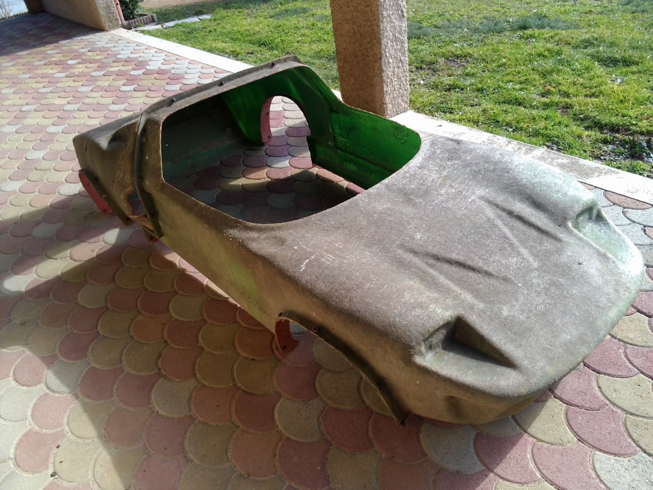

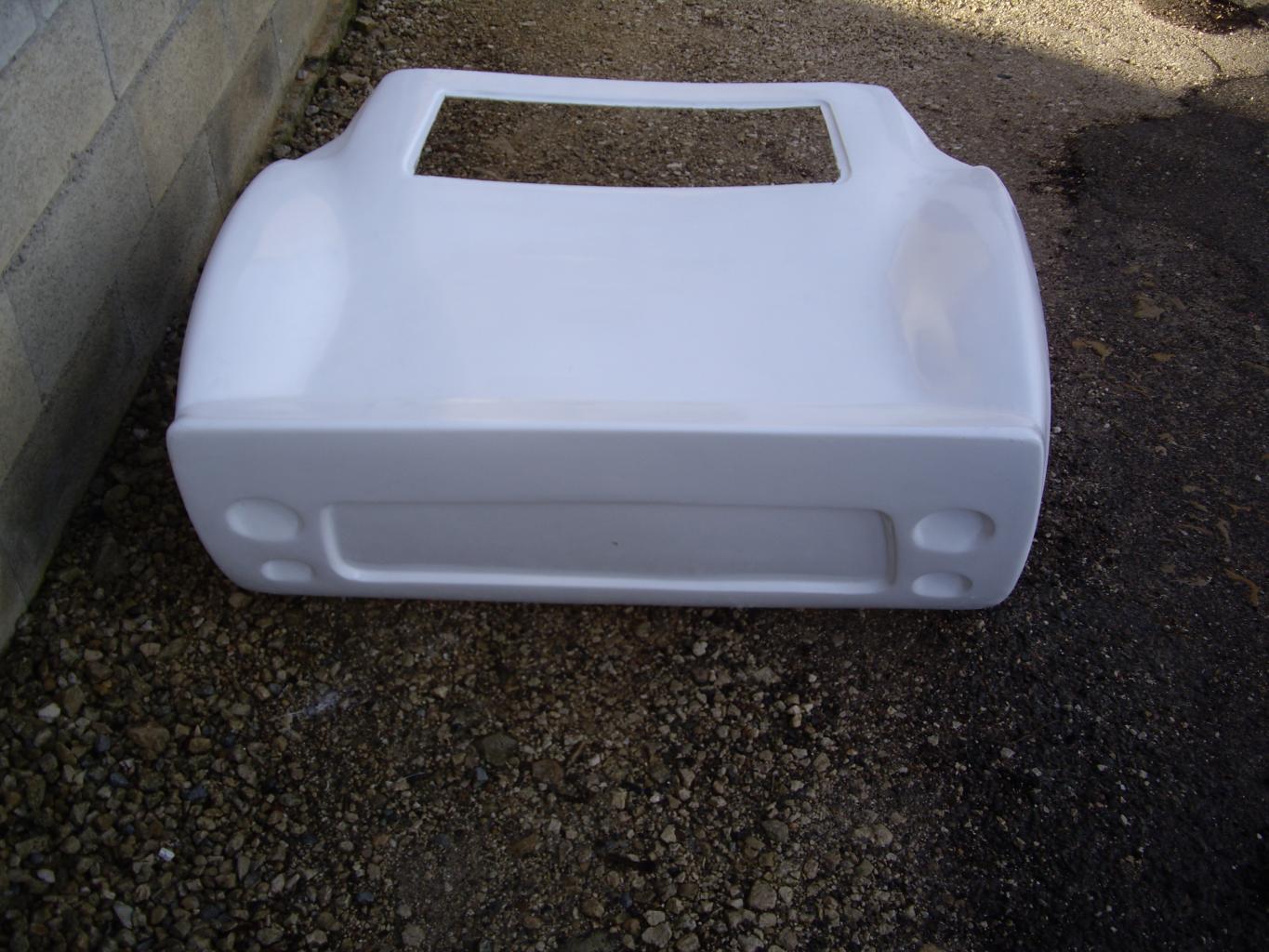

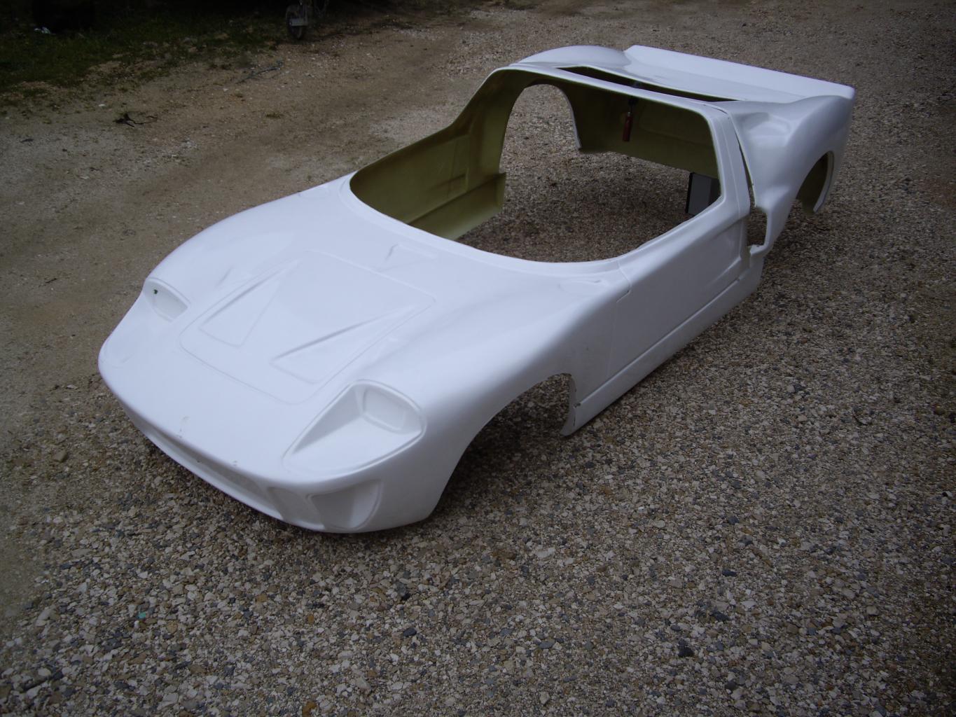

Hi, i posted on here briefly when i had the vx220/elise gt40. I have an old french childs gt40 mould and want to make a chassis for the body. It measures 260cm long when done. i am a competent welder but need advice on a scaled down chassis. Has anyone on her hever built one? have any ideas?

wonderfull to see this scale-body,.....first you must think about what you want or Need,...a full Suspension Chassis??, a scale-down-original Chassis, a nearly correct tube-frame-Chassis??,...or do you want an easy, not so expensive way to build, a cart-frame with some modifications, or a custom tubeframe,....what engine you want inside ?, fuel or electric??,....
so first must be a conzept what should be the result of all this work, if you know the direction you want to go, than think about Chassis, all variants can be done, some cheep, some for Money, and some for bigmoney

If it were me I might consider buying a used go-kart frame that was close and already had all the spindles and things. Then retrofit to the body, would save a lot of time; not that go-karts are that complicated.

At 2.60m long it's is fair bit longer than a kart frame. I'm prepared to spend a fair bit of money at this build, it will have all new parts. Engine wise we are probably look at a Honda gx series with torque converter and a forward reverse box.
