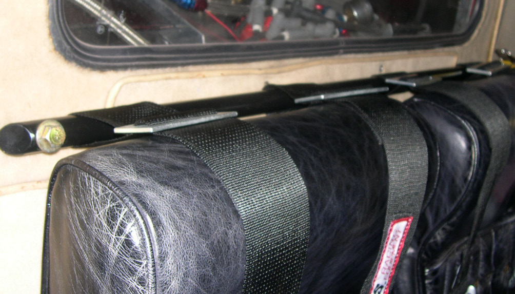

The GTD has a treaded shoulder strap mounting point on each side of the car. I had a 4130 bar fabricated to tie into those points and utilize wrap around shoulder belts. Waist belts should have an attchment point already. Submarine belts usually just attache thru the floor with some re-inforcement around the hole.
