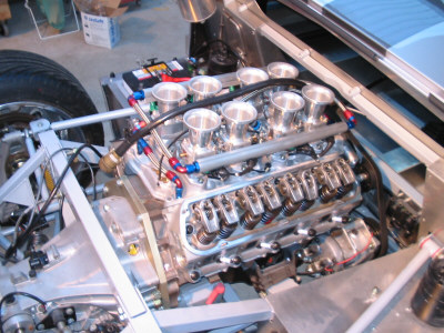

8 barrel, trumpets and no air filter
Just wondering if anybody has had any real experience with running these units without air filters. My options are to either leave it open as is, or use "tea strainers" for dust protection.
I figure that, even if the engine only lasts 50,000 km (30,000 miles) without filters, thats still almost 10 years between rebuilds given the amount of driving it'll get. Am I kidding myself?

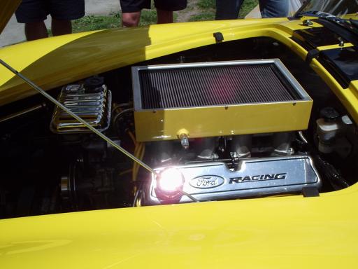

So far, this is the best air filter I've seen for weber type injection. It's on a cobra. The filter is off a diesel car of some kind.
I noticed speedway motors makes a K&N based filter setup similar to the one shown by hersh for the sprint cars. The differences are that it has a K&N in the top and all around the sides and has a carbon fiber base and high price. I thought if I ever went this route I would try to by just the filter elements (for significantly reduced cost) and make my own base from aluminum.
