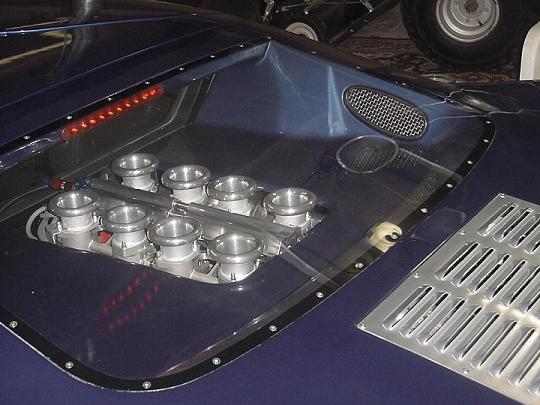

Like you, I was reluctant to add stack filters for aesthetic reasons, but I was a bit concerned with foreign particles working their way into the trumpets, so I added filters and screens to the intake holes in the rear clip, among other places.
I fashioned the filters out of 3 layers of household A/C filter media(dyed black with ink), The screen is gasketed with a piece of 1/4" vacuum hose with a slit running it's length(fit around the edge of the screen), and glued in place with black weatherstrip adhesive.
The filters are held in by vacuum only, but are a fairly snug fit. It's far better than nothing, and the "look" is still there. I'm planning on adding a cold air box to seal the trumpets from the engine bay, but haven't gotten around to it yet.
Total cost for filter media-$8. Ink-$2.50 Vacuum Hose-
$1 Weatherstrip adhesive-$5 Screen-$10+or-. Total-$26.50
There's a previous thread, with photos of the screens.
Attached is a shot of an intake screen. They seem to do the
job pretty well, 'cause each time I rinse them out, "ugly
stuff" appears at the bottom of the bucket!

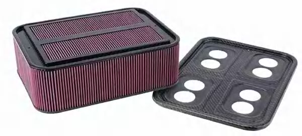

ITG makes filters that fit on Weber IDFs. They might fit
IDAs as well. Not cheap, but probably worth looking into.
Basically, you would have 1 filter per pair of trumpets.
http://www.itgairfilters.com/
Look for maxflow JC20, JC40, JC50 and maybe JC90 or
raceair JC10, JC70 and JC71.

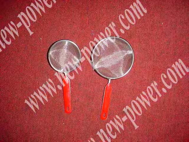

I wish someone would make the old tea stainer type inserts like they used in the fifties. Guys used to tape real tea strainer baskets to the tops of the trumpets to keep out large contaninates. Those that Inglese' sells do not fit my trumpets. Besides, they are flat and I would like the domed strainers. Maybe someone does make them. Anybody know what I'm refering to?
This language barrier can be a real pain sometimes. /ubbthreads/images/graemlins/grin.gif
I think we are talking about the samething. Here is a picture.

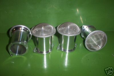

Here is an interesting approach. Maybe this can be modified to work.
Hey Tim! That's it !

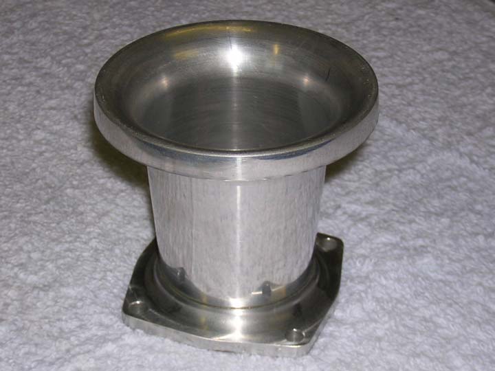

I wish there were some of those that would fit my Trumpets.
My trumpets are 3 1/8" diameter at the top with a 1/4" rim.
They also have a 4 bolt attachment base.
I would still like to have a set of what you have. I think I might be able to come up with a way to secure them to mine.
Tim Kay
Sorry Hersh, I just provided a picture of the velocity stacks for this thread. I bought a similar set on ebay which the seller shipped out of japan.
To get the picture posted above I did a search on ebay for 'weber velocity stacks' and checked the 'past items' box.
Frankly they look a bit nicer than the ones I purchased in addition to having a tighter weave than mine.
