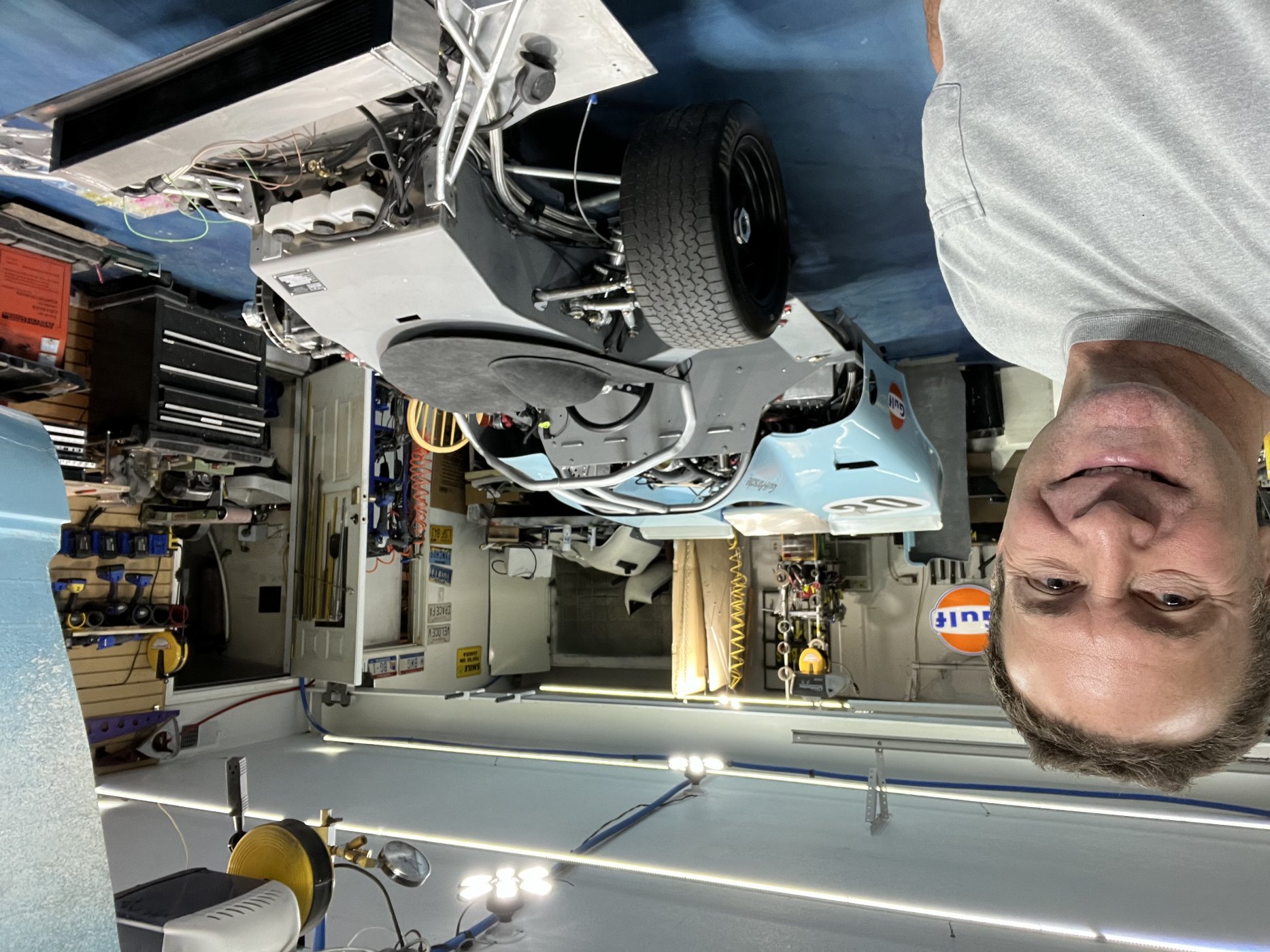

I have nearly every switch, light and accessory ordered or received, now for the cake to be baked... I'm ready to decorate! Anyone have an opinion regarding upgrading to a LSD on the transaxle IF Fran has one available before shipping my kit out?
Update for May 15, 2023. Things are progressing, still waiting on the steering rack which is preventing me from installing the AC evaporator, pedals and front bodywork, but I am about 85% done with the electrical, the ‘traverse driveways’ braces, pallet Jack wheels go on after the front bodywork, things are looking good for hitting the road in another 6-8 weeks! Center wing, adjustable spoilers, all kinds of custom made bits ready for paint. Truly enjoyable build!
