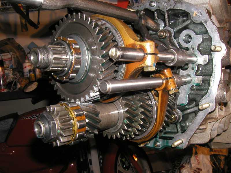

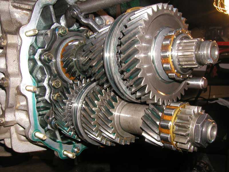

Here a a couple of images of the inside of a 930 before build...
Hard to get a scale on things, but looks like gears are meaty (subjective I guess).
I also got off the phone with Roger at PowerhausII and asked if he has seen a failed (due to blown R&P or gears) 930 trans and said no. The only one he has seen blown was due to a clutch explosion that cracked the bell, FWIW. He did mention that it is a very stout trans with all shafts supported. Most repairs were sliders/syncros.

Hopefully will have the car by year end and can get to work on it. Most of the hard stuff will be done, but will still have a load of wiring and plumbing to get it ready. I would love to see the guts of a ZF, and a 5052 for comparison. The 930 R&P section of the gear box looks huge compared to the other, not sure if it is all that, but I'm guessing it will be ok. But being paranoid I have a spare ;-)

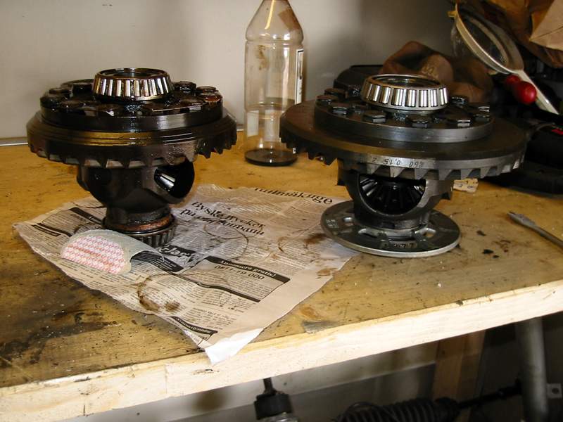

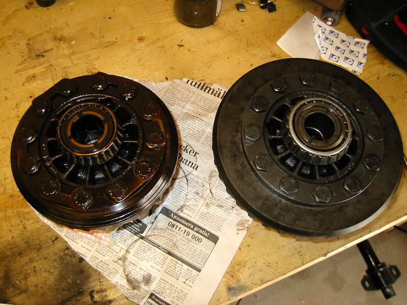

Here are 2 pict's of a 930 diff w/ring gear vs G31 (same as 915) The side bearings are larger too. I seem to remembet that the 930 gear dia. is 9"
Interesting to note the two diff units in the picture.
Heres my observation. I assume the 930 diff unit is on the right, because you said it has a larger crownwheel gear. Correct me here if Im wrong ...
The side bearings may be bigger, that the ones on the left, (915), but there are more rollers on the left side ones. This would give a greater surface contact, reducing the load per roller.
The diameter spacing of the crownwheel bolts is also larger on the left side (915). Would this not give a greater holding torque?
Also of note is the side gear axle diameter. The left unit (915) caters for a larger axle unit than the 930 (rhs).
I also see only 2 spider gears in both the diffs. Obviously this is all that is required but I would have thought there would be 4.
So for me, just from looking, I see that the 915 box could be quite a heavy duty unit. I would guess that its just the crownwheel/pinion size that created issues in the gearboxes that required an enlargement for the 930.
