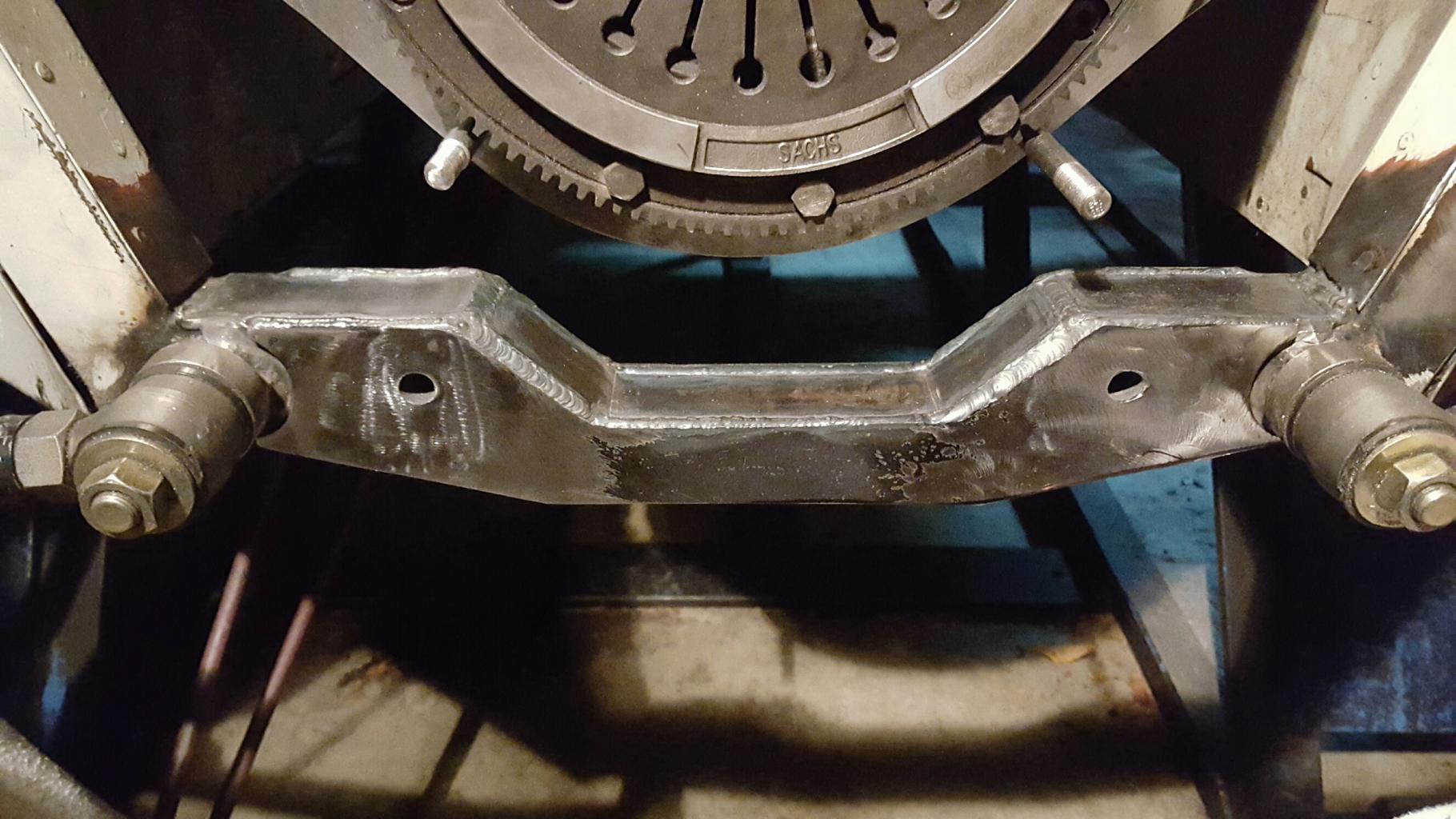

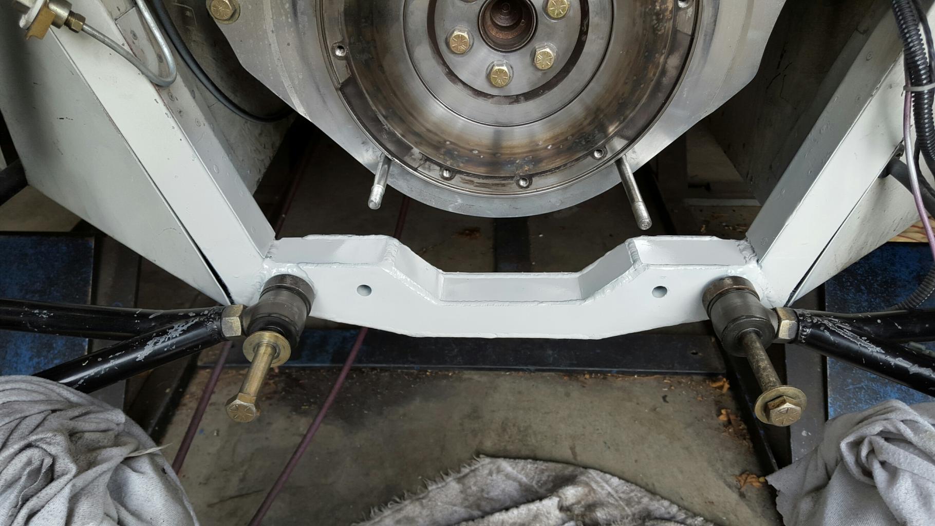

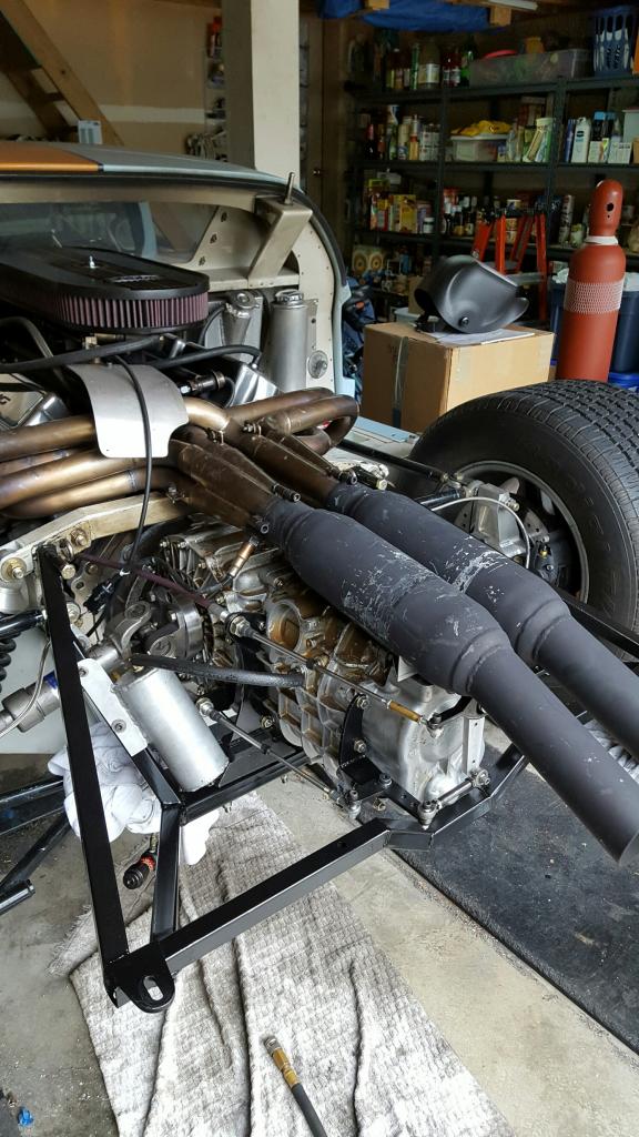

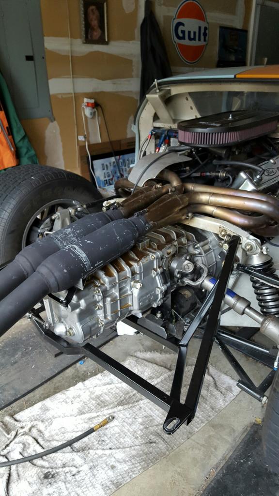

Just a quick update. The modification on the chassis is almost complete and the G50/50 fits nicely. Just some finish welding and some mods to the rear sub frame and I'm in business.

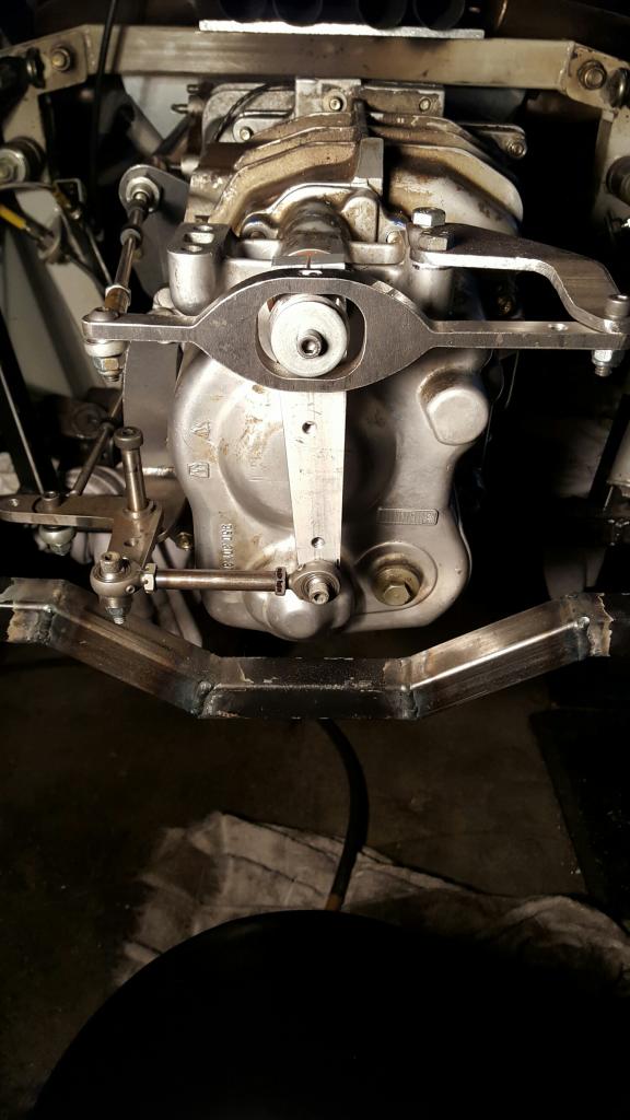

I finally got a chance to work on the GT. I was able to finish the rear sub frame modifications as well as the right transaxle mount. Hope to finish the left mount and shifting mechanism this next week.

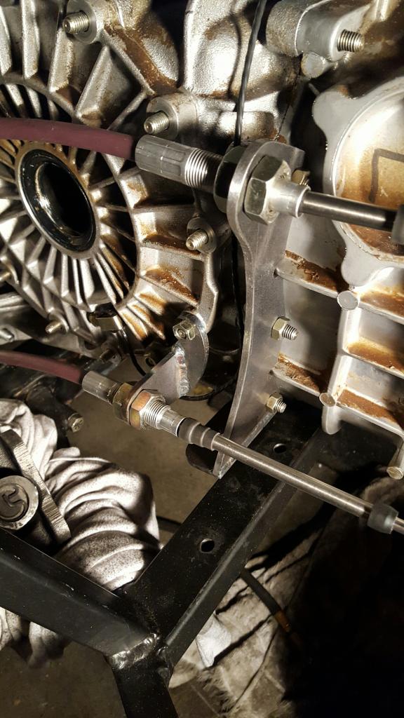

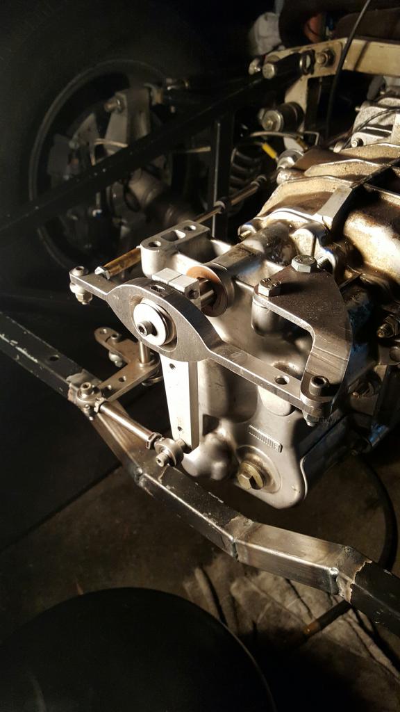

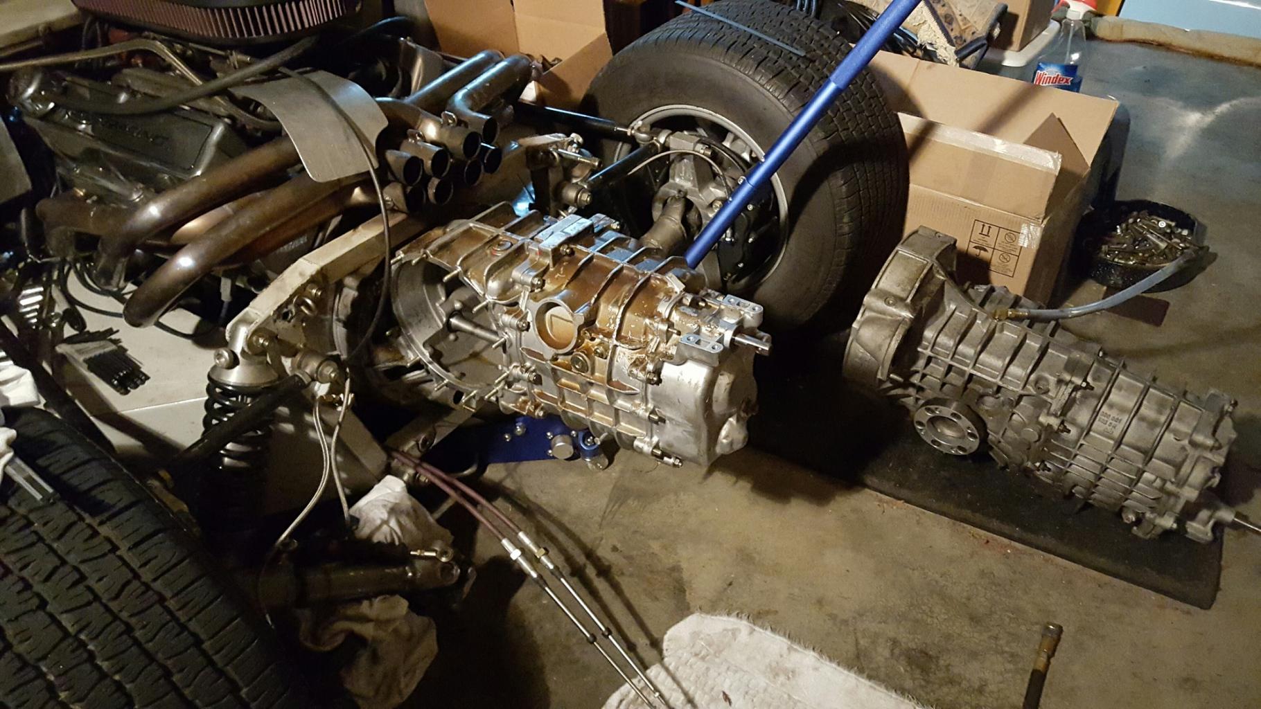

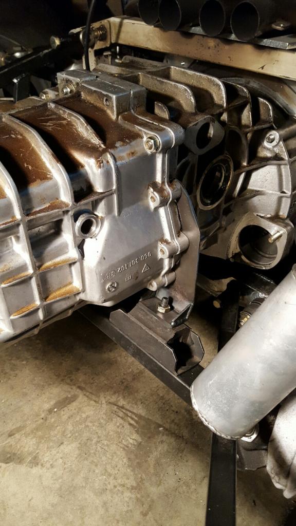

Finally got all the brackets and shifting parts done! Everything works fine and it shifts so much easier than the 930 tranny. Now I'll dissemble everything and paint it and put it all back together.

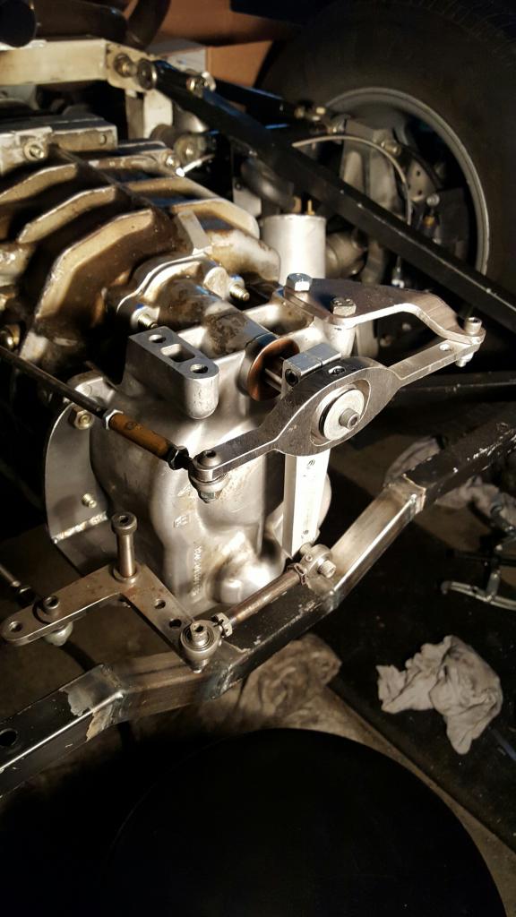

Just an update, I have installed the transaxle with all the shifting mechanism and mounts. I'm waiting for the AN adapter for the slave cylinder, it will be here next week. The transaxle shifts through the gears very smoothly, I can't wait to drive it. Hopefully next weekend.
