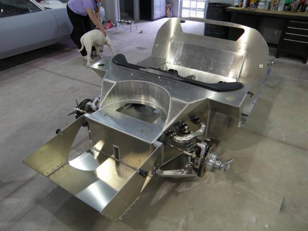

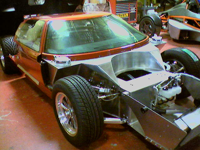

It's been a long process at RCR but finally very close. Fran and the crew have incorporated many of the RCR updates and even some unique methods developed by Forum members as they sought to improve the breed. I can't take any credit for the nuts and bolts build but want to share the pics, some of which have already been posted but will now be organized here.
This is a street machine and will have the standard rear clip.

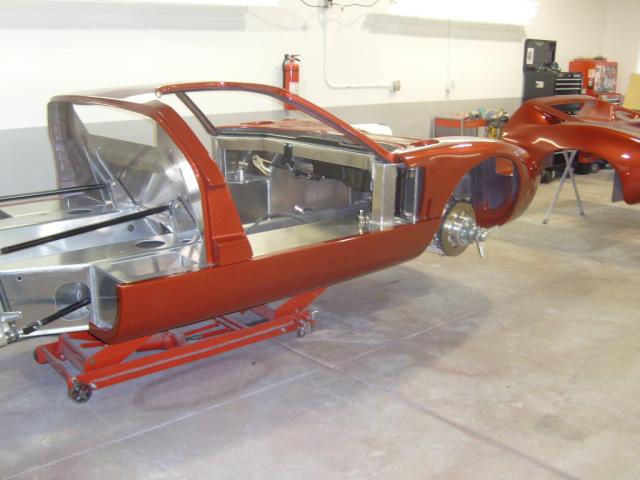

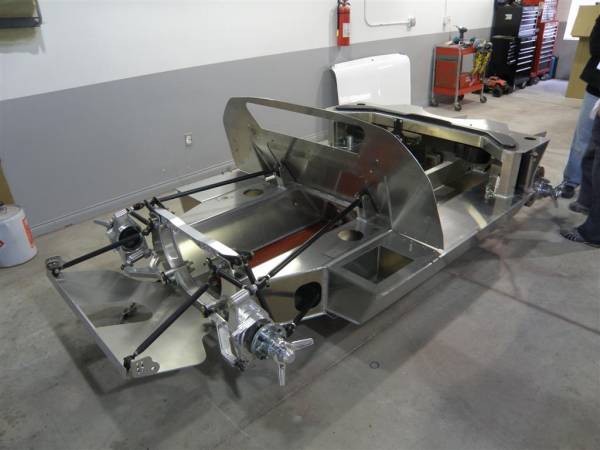

Delivery is still not finalized but Fran has indicated it will be shipped at the end of this week, 8/27-8/28. I'm excited at the prospect of getting the car home and completing the final steps. The following photos are from the earlier build process:

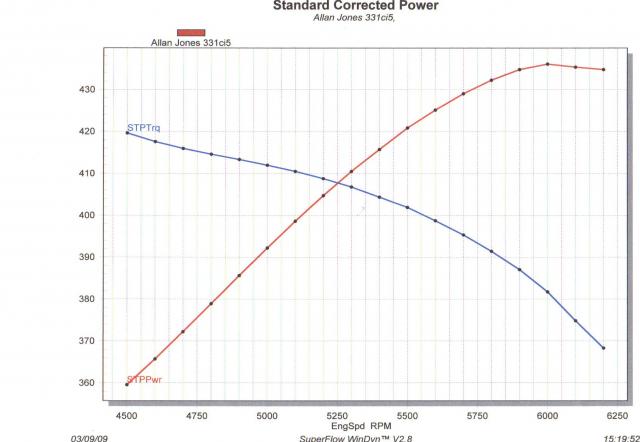

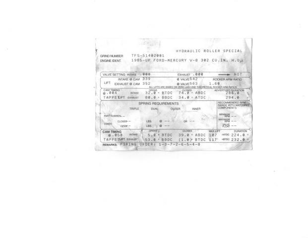

Brian Hamilton
Decent lift and the split duration of that cam is going to sound GOOOOOOOOOOOD!!!! Nice power you have too, looks like the torque is there instantly and pretty nice curve. The HP curve is really nice too, very linear. This thing is going to be a blast to drive man!! Can't wait to hear the test driving experiences.

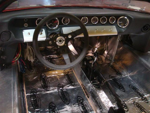

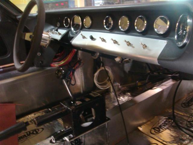

A.J. Congratulations on nearing completion, By the way I used the Dynamat in my Cobra build. The stuff is great! Does RCR use Dynamat underlayment on all of the turn key builds? I never thought to ask him about insulation.
Al,
I am impressed with the color choice! And, the engine-work is not too shabby for a little V8 (ref: your jab at the Viper V10 :drunk:). You inspired me to start my build log thread.....
Allen - It's not a turn key,but with additions,is pretty close. I've got a bunch of stuff on the way from Summit Racing which should tie up the loose ends. As for the Dynamat, I asked Fran for the insulation in the cabin,it's not 'standard',nothing is. There's basic stuff but each order differs. He said he had some stuff that he used on the SEMA car that was very effective and would use that. Additionally, Mark used a heavier material on the floor of the wheel well area to deaden stone noise. A.J.

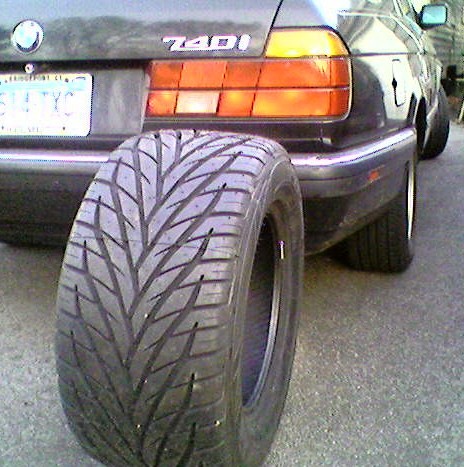

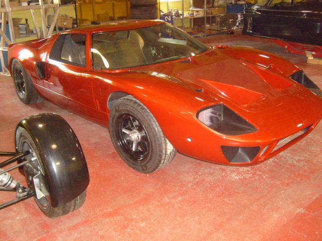

Thanks Scott! The tires are Toyo Proxes's. Fronts are TPT's 225/60-15 and rears are ST's 295/50 -15. I plan on going to T1R's or similar(better bite and matching tread pattern) after I go through registration. You won't find the rear tires anywhere at this point unless you run across an isolated dealer with a couple. I had an agent scour the country for remaining stock and now have the last spare ones in my basement. I may even go to Avon's or Hoosier's later,but these will do for the street while I sort out the car. This area sees a lot of rain(don't want to drive in the rain? -don't go out.) and I liked the dry/wet performance of the TPT's on my BMW. One of the first things I will be doing is to try to minimize water intrusion. I know you can't prevent all, just most.

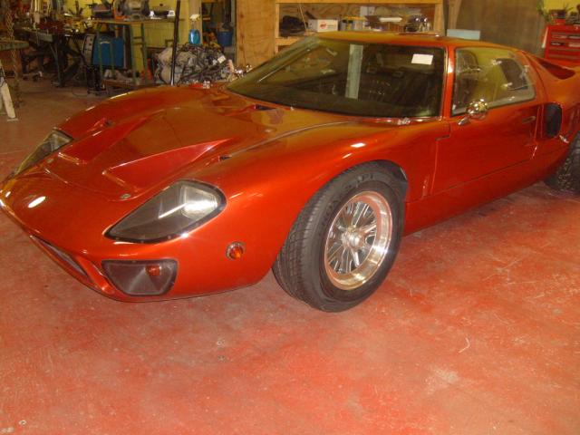

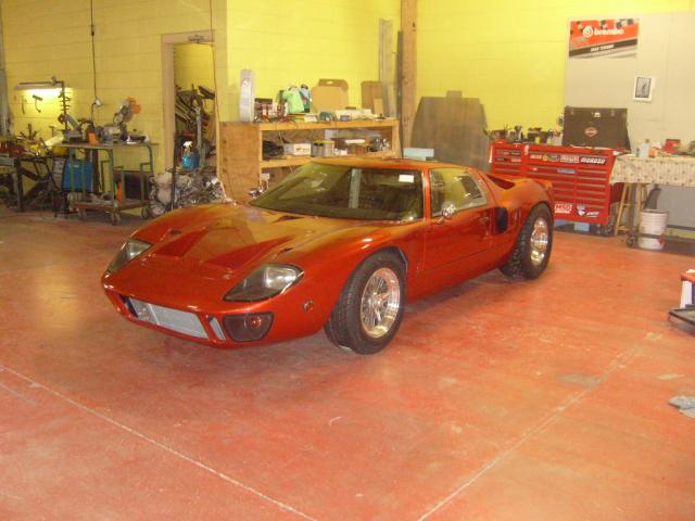

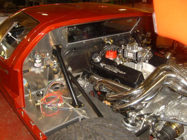

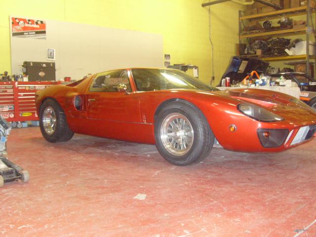

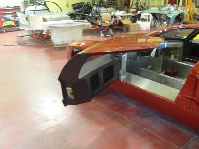

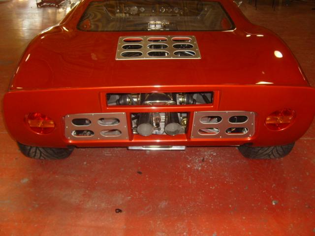

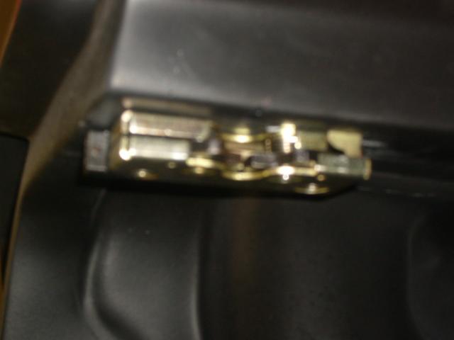

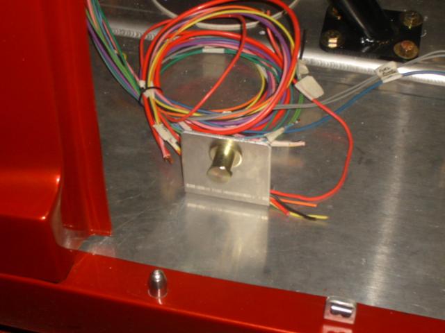

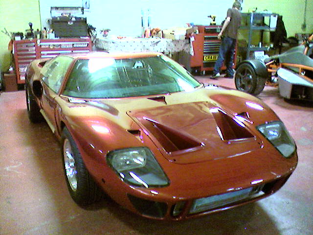

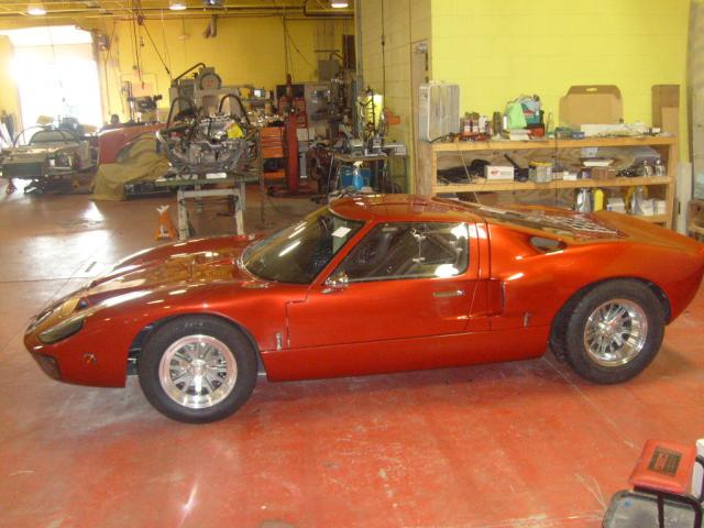

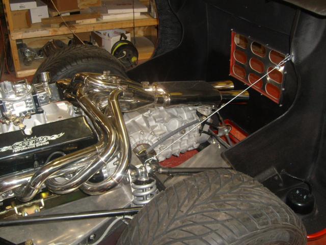

Here are some recent photos. RCR came up with an innovative safety latch for the rear clip,accessed through the driver's side air duct. It eliminates the exterior top pins. I will post more later.

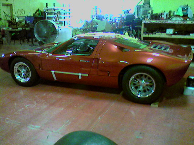

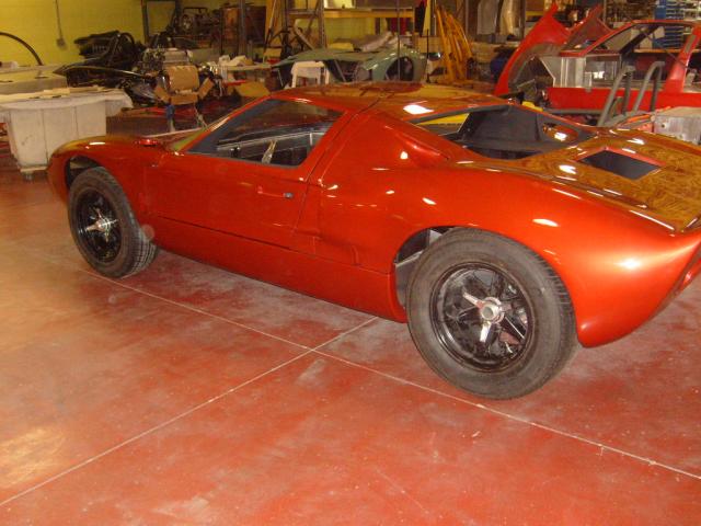

Thanks Tim. Waiting on the shipper at this point, not RCR. Fran will not let them have the car until they're ready to go so it doesn't sit somewhere in a trailer or ?(thanks Fran). Right now it looks like the shipper is going to take about 10 or 11 days from departure to destination. Arrival could be 9/17-18. Fran and the crew have paid considerable attention to some remaining details and it looks like I can finish up the final items fairly quickly.

Wow A.J. the car looks great! How are you sleeping these days? Knowing that you are just days away from getting the car home has got to be exciting. The Talbot mirrors are a nice touch to the street car look too. The exhaust looks great, and you will like the sound from them. When I was at Dutton’s he fired his car up so I could hear his car. It was music to my ears....
