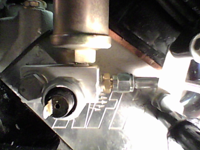

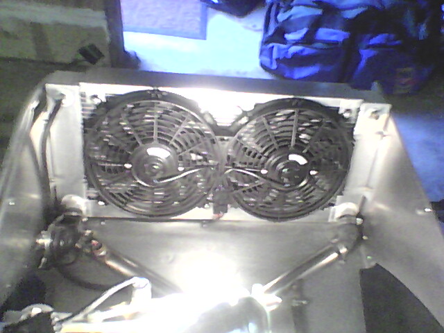

Al - It's getting close. There was quite a bit of work to get it where I wanted it. I haven't had the opportunity to work on it on a constant basis due to weather and other commitments until this year. Add to that the head-on accident at Thanksgiving which limits what I can do. I have a good friend, Andrei, working with me to get to the items I can't physically do. He's also a long time car nut and builder with excellent fabrication skills which made the task(s) easier for me. I'm making a concentrated effort to get all the systems working; fuel, coolant, steering, brakes and several other items. Along the way we've come up with a few additions and rework that will make the car reliable and easier to service. Even little things. For example, instead of having the oil pressure and warning sensors hanging on a long extension from the block, we ran a stainless line up to the front of the cyl head to a junction block so all the sensors could go into the same harness. I didn't want heavy sensors hanging off a 6" pipe nipple in the block. See pic. Attached is a pic of the new radiator fan mounts as well. I'll try to get a better photo soon. More as I get time to post photos of the different systems.

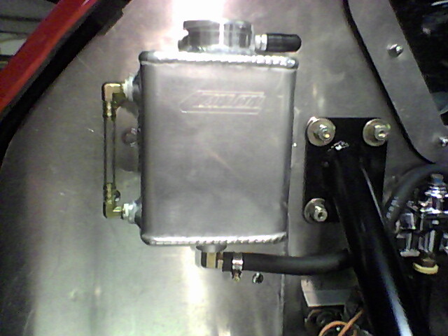

Almost forgot - this is one you won't find in the catalog. The folks at Canton have been most helpful. A special thanks to 'Junior' at Canton for the tank pictured. It's the short length tank with the sight tube addition found on the longer tank, modified by Canton for use as a catch tank. These (surge and catch tanks) weren't supplied by RCR. Since the fuel pumps, filters and lines were mounted right in the middle of the available space, we had to strip off the fuel system to mount the tanks, then re-mount the fuel system components in a different location. As a bonus, the pumps are now lower and closer to the fuel tanks, and, we made up vibration reducing mounts - eliminating some of the electric pump noise. RCR covered the firewall and cockpit floor/doors with Dyna-mat which should also help the niose issue in the cabin. As previously mentioned, the Dyna-mat is not standard issue with the T-K minus. Pics of fuel system are coming.
Hi Al,
the connection to the engine on the catch tank, needs to be at the top, or it's potential contents will drain back into the engine. The bottom connector is the tank drain.
Andy

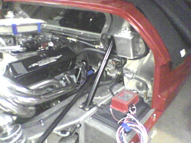

Terminology,sorry - maybe better labeled as expansion and overflow tanks. This one is vented and returns fluid to the expansion tank so the plumbing is correct. The attached pic shows the feed to this tank from the upper outlet (right side top) of the expansion tank on the right side bulkhead. Top left (as you view it)of that tank is the radiator air bleed. Not all 'plumbing' was in place for that photo. The overflow tank outlet plug is temporary during construction. It would require a catch can here for track use.
