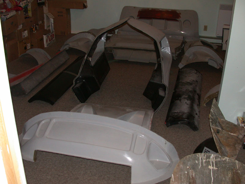

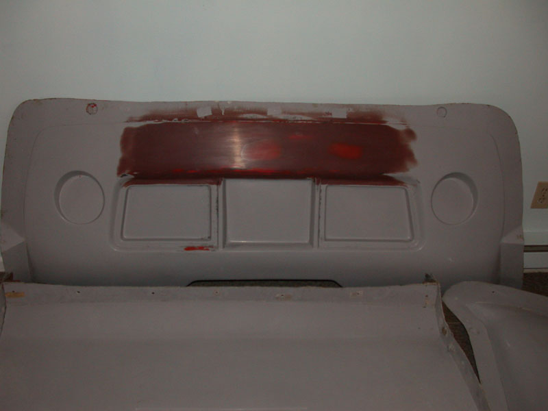

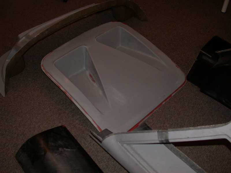

I thought I'd share with my fellow forum members what I just picked up last night, sometimes you just have to go for it, and the price was very reasonable...

Interesting. I'm a bit confused as to what you have there, is it a set of body panels, is it a set of body moulds or is it (as it looks to my totaly untrained eye) a set of moulds to make a set of body moulds?
Whatever it is....nice one !
Simon
Hi Simon, to answer your question, they are male body panels with flanges installed to produce female molds. A little cosmetic work here and there (in storage for a few years in a barn) but basically all the pieces required for a Mk I.
Rick
So let me ask this... these items are "plugs" for the mold to be made from.... is that correct?
Interesting... are you gonna start producing body panels?
Looks like a tremedous amount of effort went into producing these parts... not to mention the tremdous amount of effort required to make a complete body shell.. Wow!... Very nice.

I really didn't have any plans per se in regards to producing body panels, my intention at this time is to just build the car from scratch with a monocoque tub.
The first thing on the agenda is to start making female molds, followed by a trial body for fit and finish. I'll definitely keep everyone updated with my progress complete with pictures...

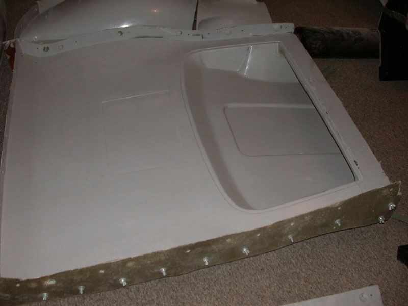

Rick, nice find, however I do have an observation which may be totally wrong. First let me say that it is after midnite and it's been a long day. Second be advised that I have very limited knowledge of mold making and may have read your post wrong. You advise that the parts are "males" which would imply that to make a mold of same you would be glassing the outside, grey colored fiberglass. If that is the case, and these parts are dimensional accurate now as a body, won't making a mold of the parts with those flanges affixed throw off the dimensions of the body by the thickness of the flanges? To my knowledge, molds are generally female, (I know some molds can be male) bolted together and then the parts are pulled from the inside. You may have to assemble the molds, glass over the joints on the inside and then grind down the flanges. You would then be left with an accurate body in which to pull a mold. Again, just an observation and I could be totally wrong. It's just something to think about. You havent't provided any pictures of the other side of the body parts. Are they raw fiberglass or is it a smooth finish in which to pull a body? I know there are fiberglass experts on the forum who can comment better then me. Good luck in you undertaking.
F3L, This is what I do for a living; make moulds and FRP parts from the moulds. I'm right in the middle of making moulds right now of the GT40 MKI & MKII. It's a lot of work. What you have there is male moulds made from female moulds captureing the flanges of the female moulds. You will have to layup pieces in these moulds to make your female moulds. All the hard work has been done for you. Making the flanges so moulds can be bolted together is where most of the work is. Knowing what materials to use is the most important part of the process along with surface preparation. I call these type of pieces "master moulds" Not many people take the time to make these. They are good to have incase the layup moulds get damaged. If you need any help in finding material supplies send me an email.
Thanks Bill, I'll take you up on that offer. First thing after the excitement dies down a bit is to categorize everything including making note of any spots to touch up prior to female mold fabrication.
Have you heard of Chavant's Rayite MDM Model Duplicating Media before being used for female mold production?
