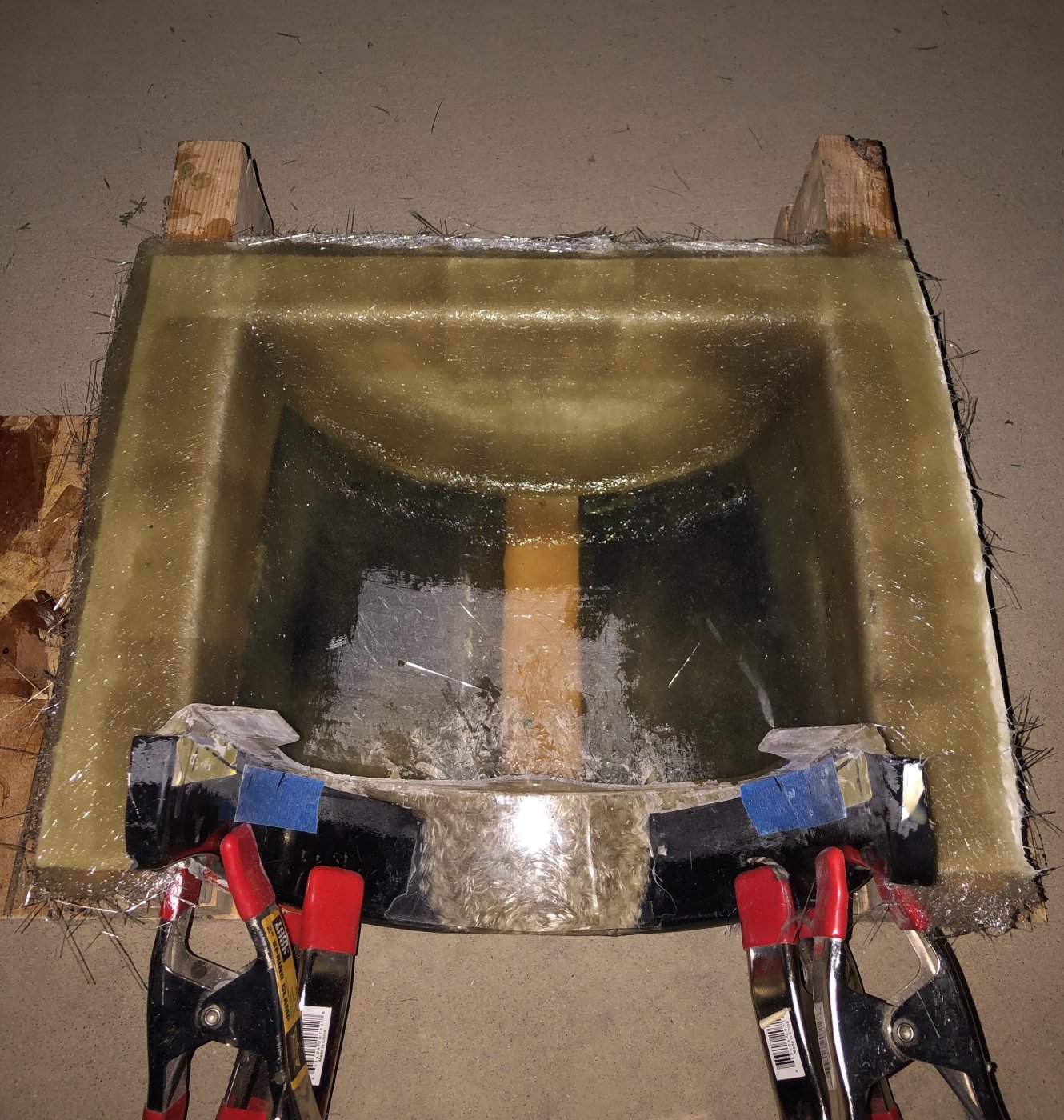

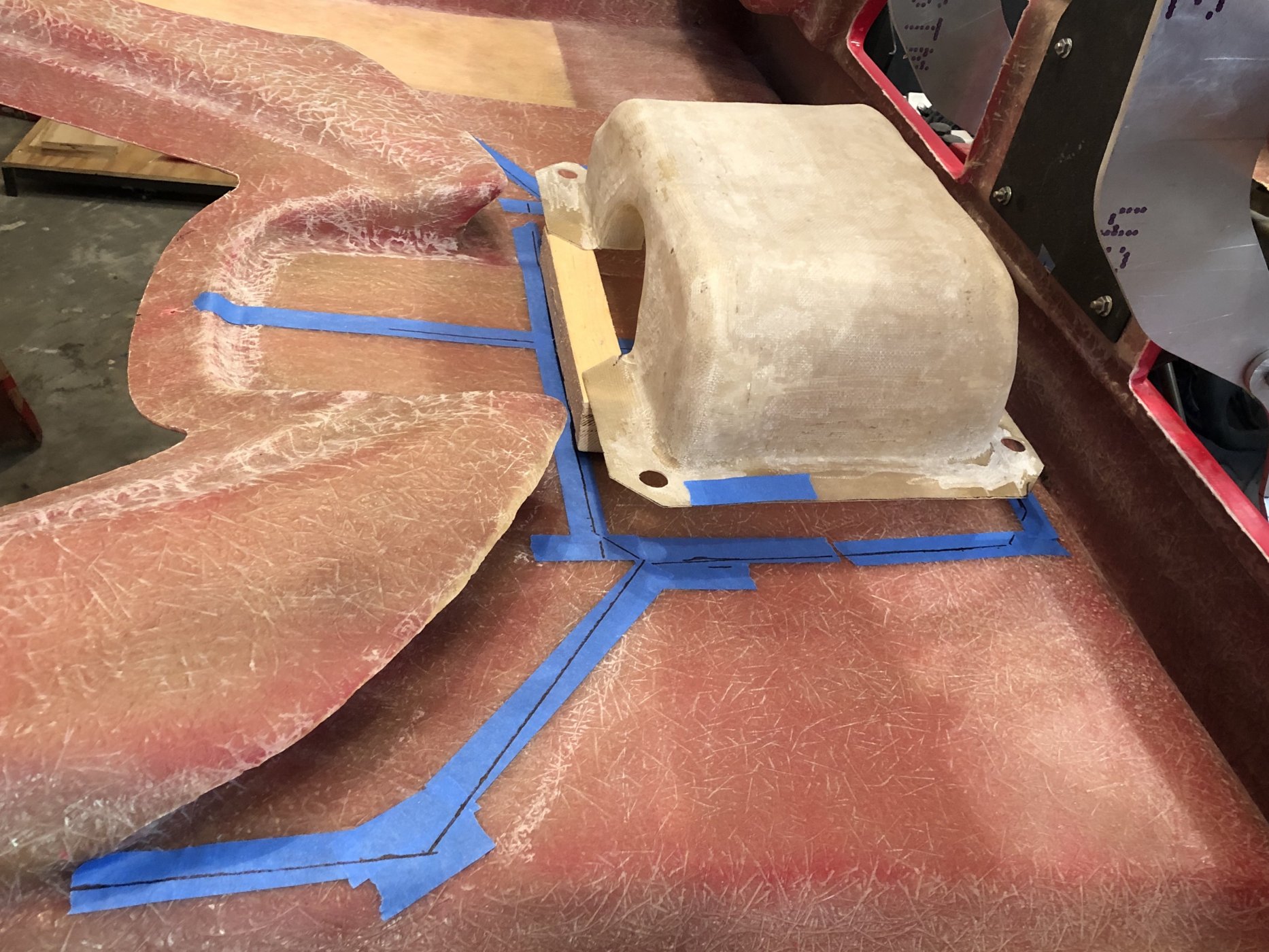

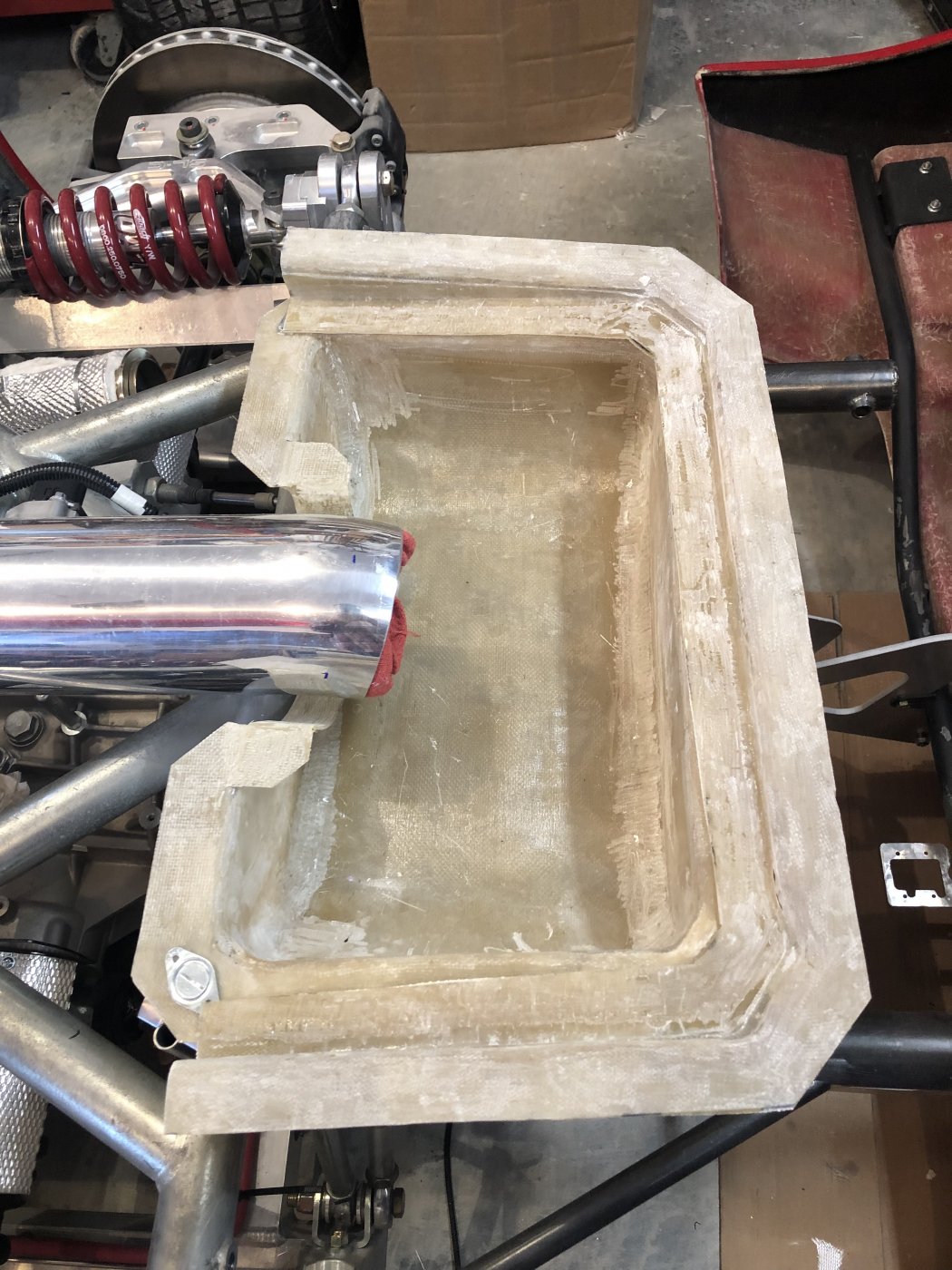

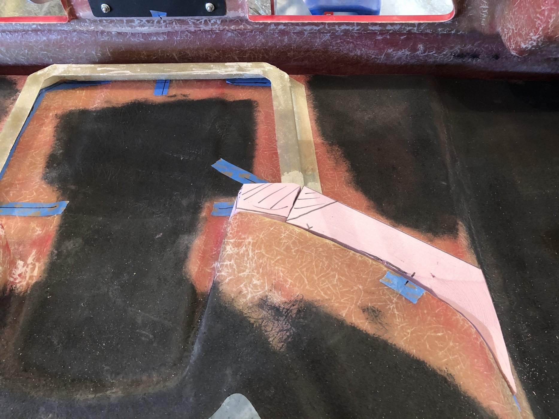

Starting the cold air inlet for the rear clamshell. I’m planning to create a fiberglass ledge with a foam seal that funnels cold air into the air box.

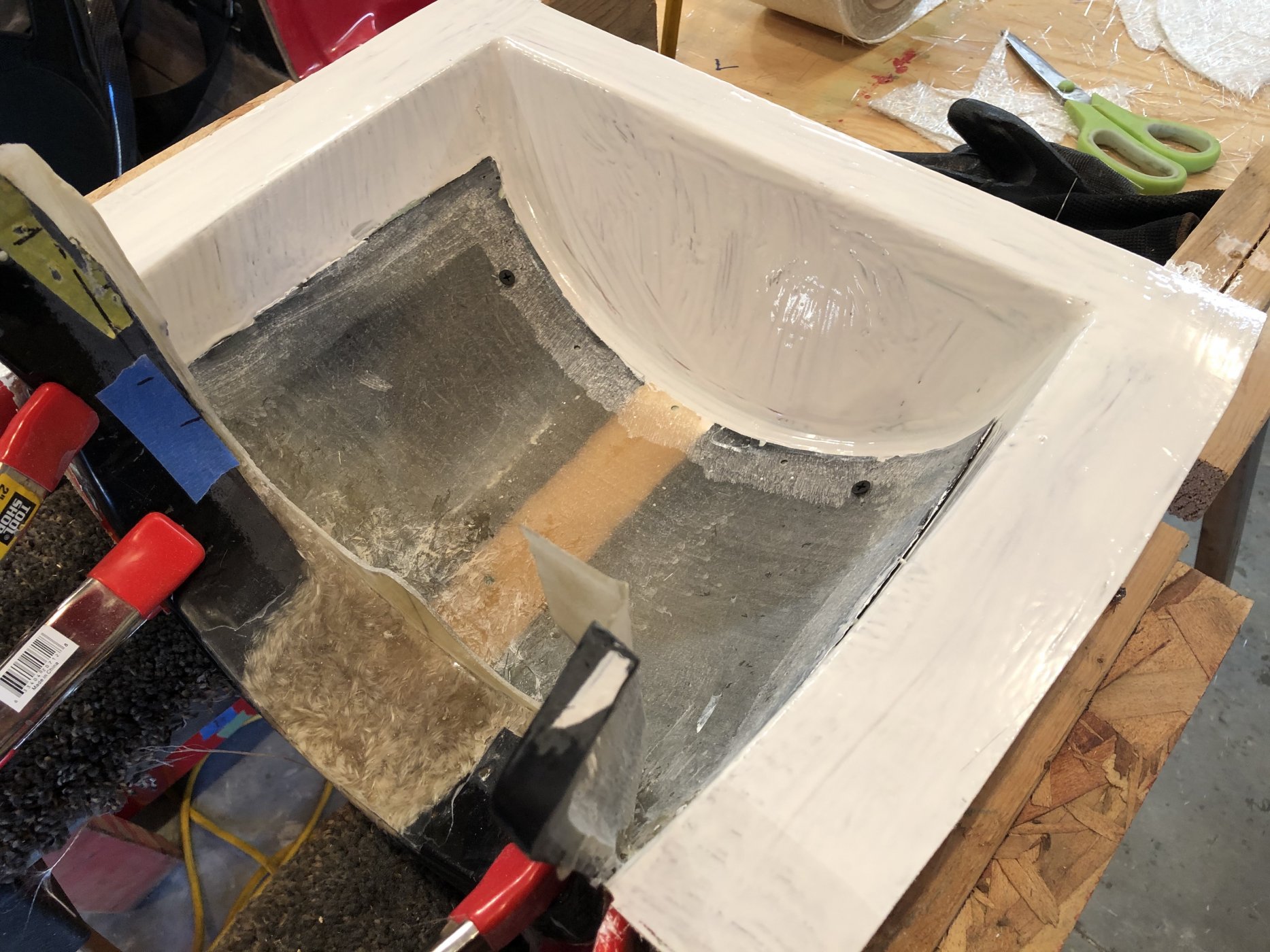

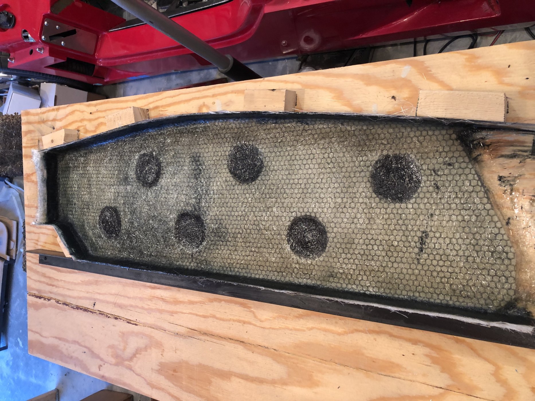

Making glass today...

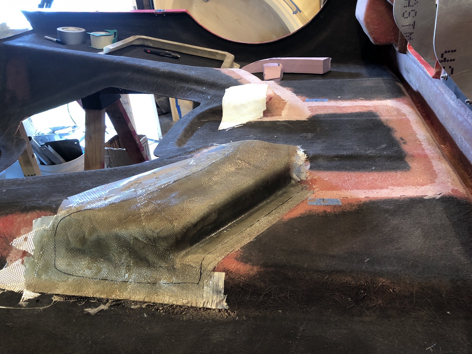

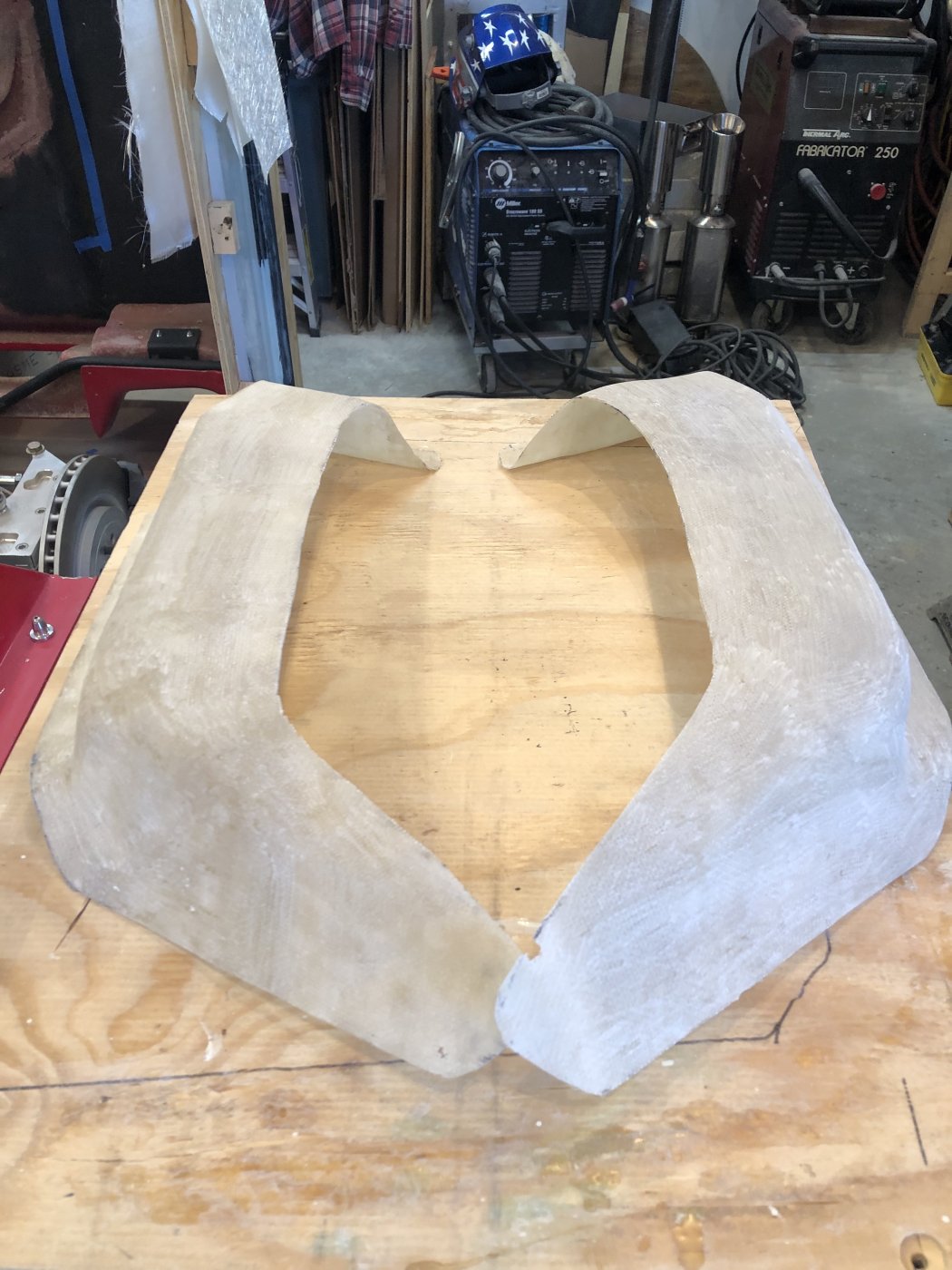

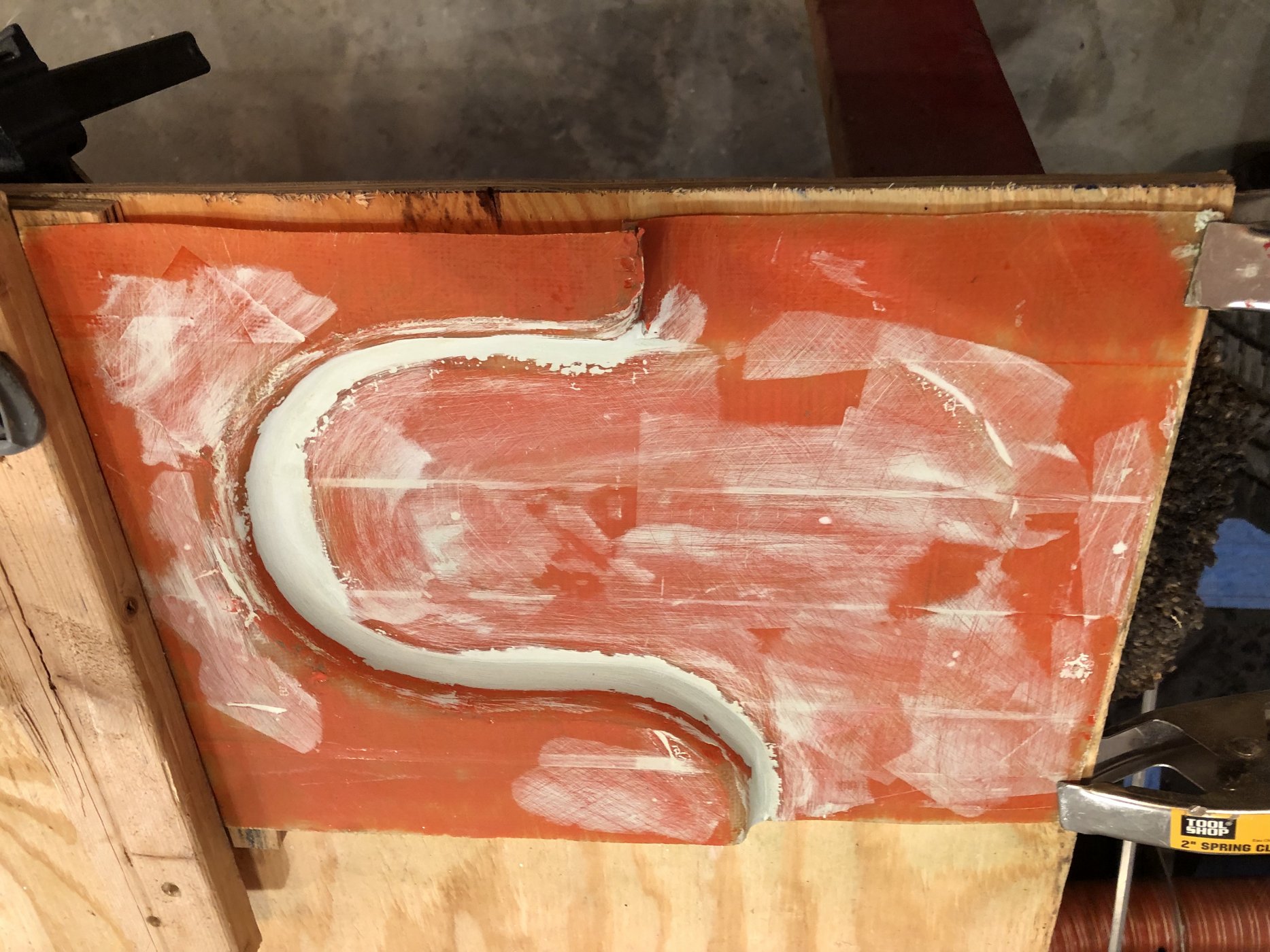

Connecting the rear ducts..

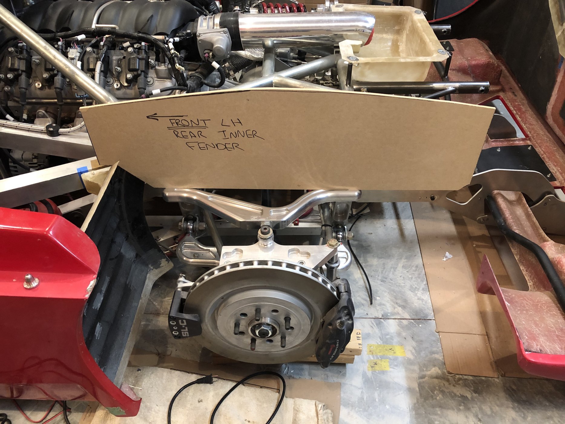

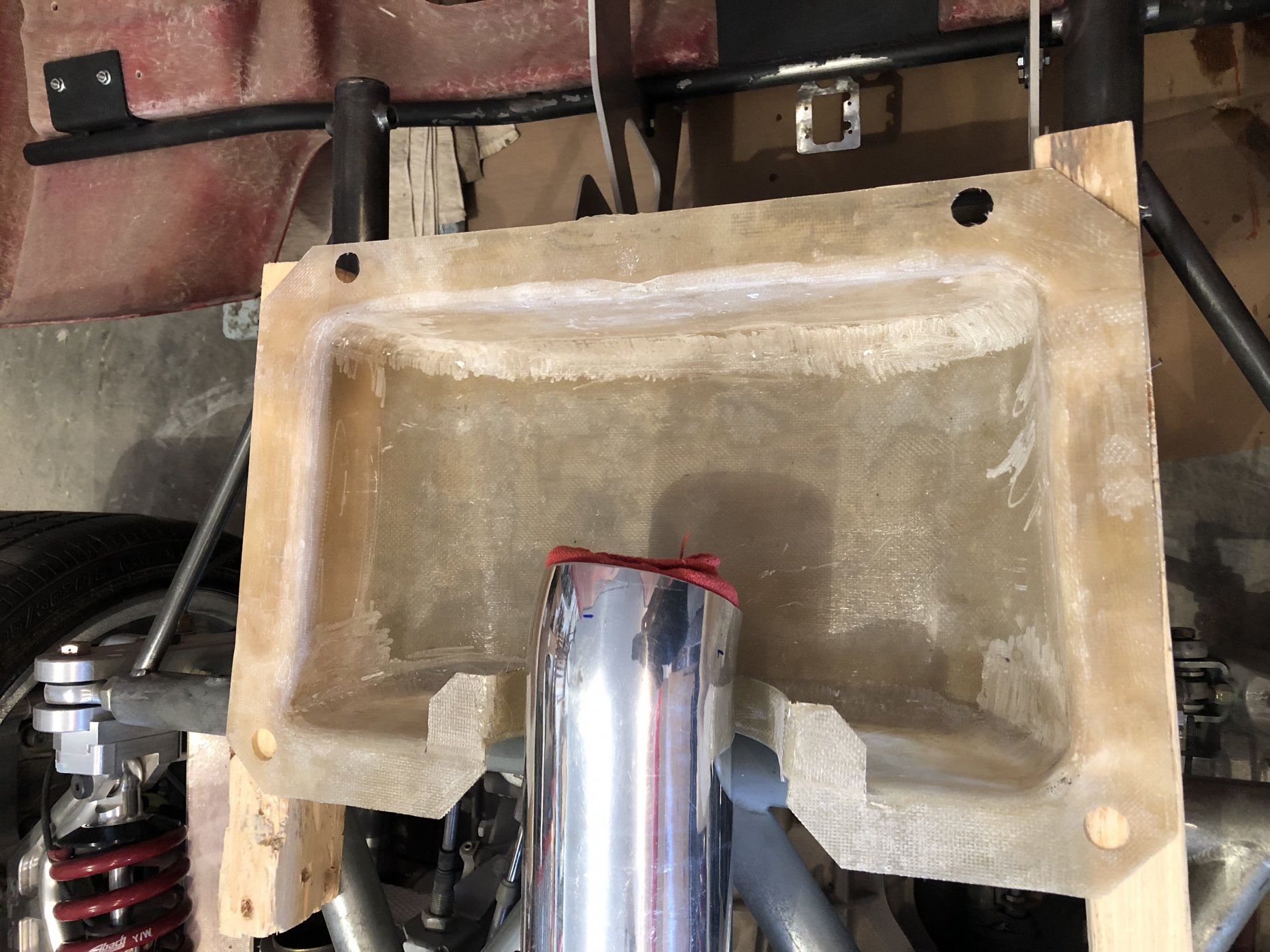

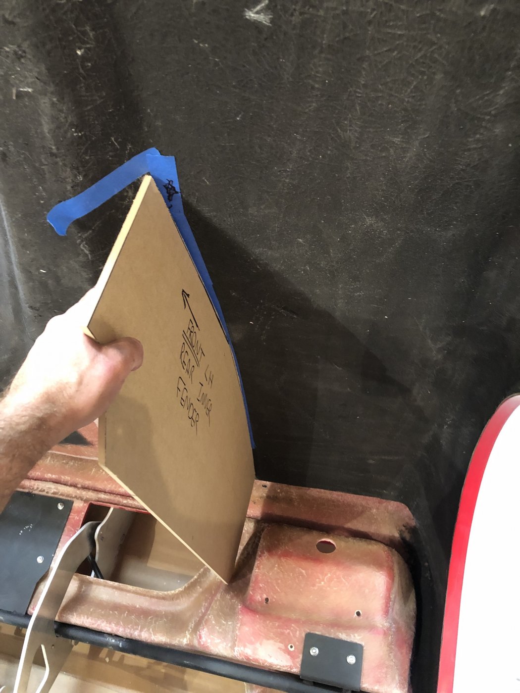

Rear inner fenders anyone...

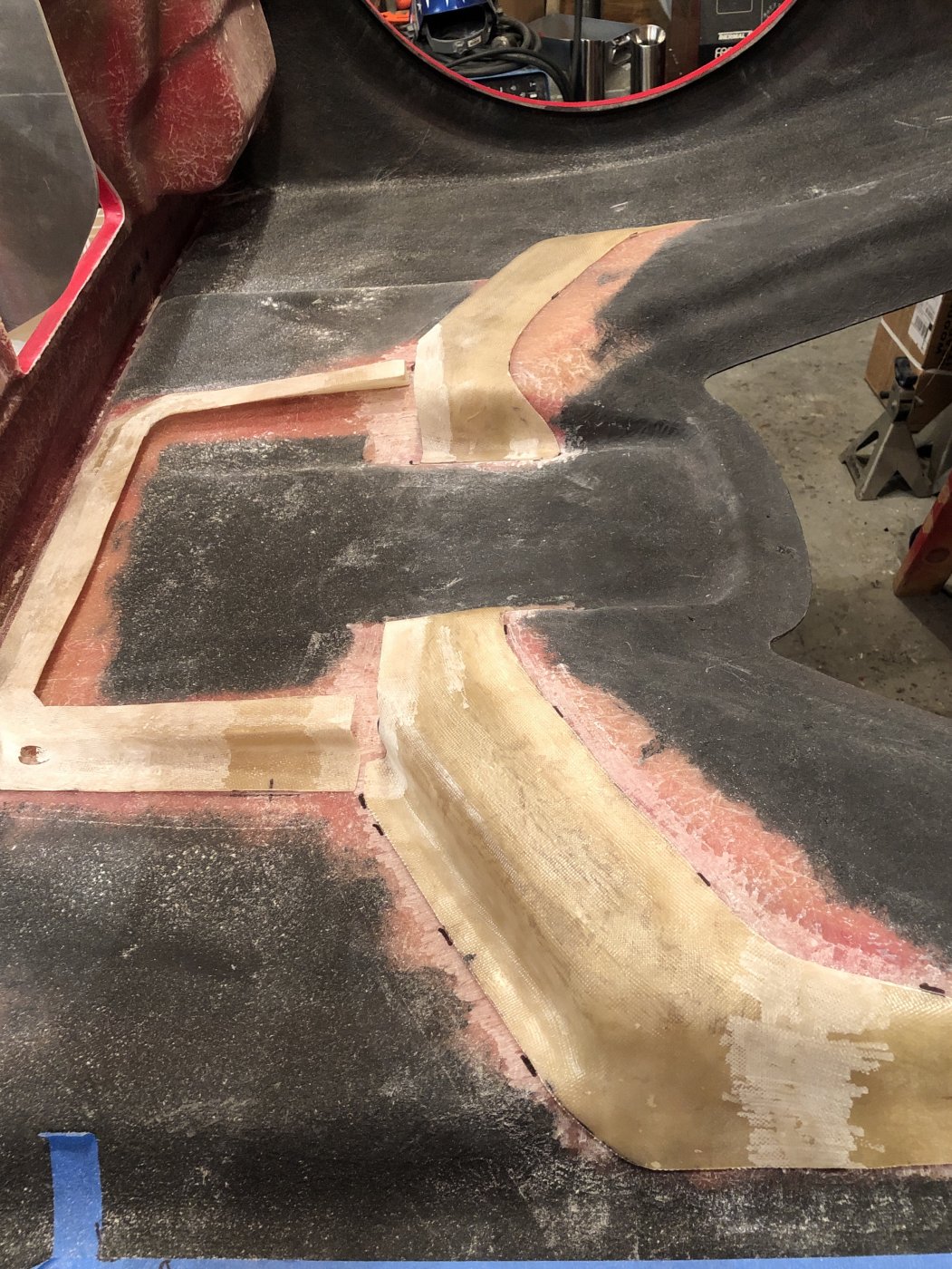

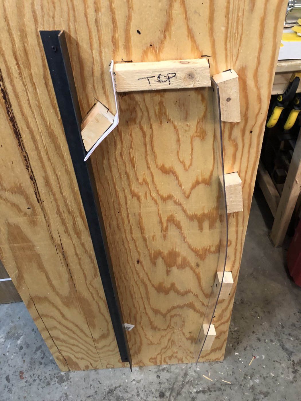

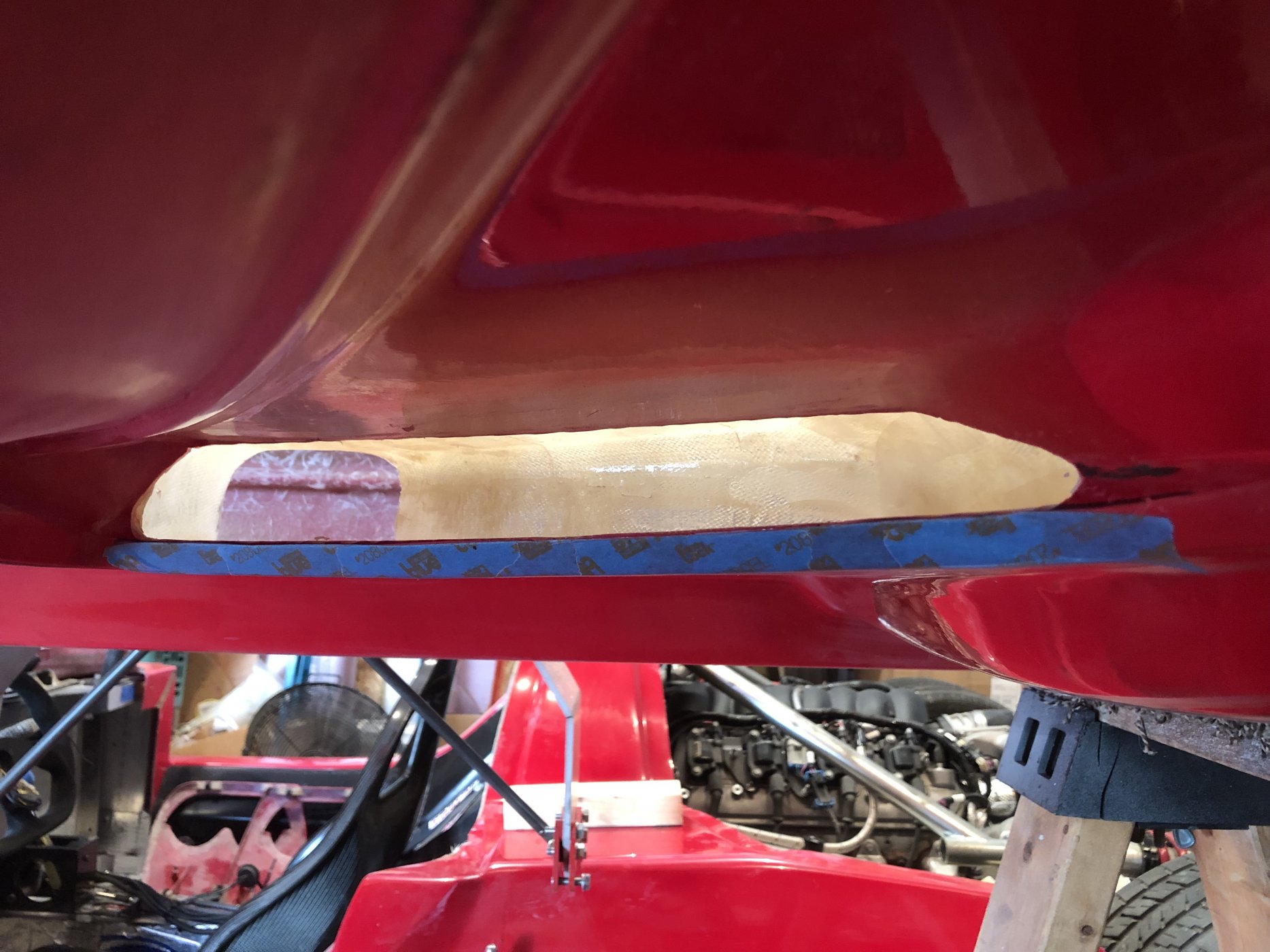

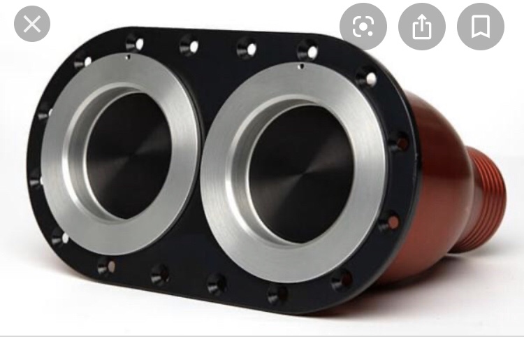

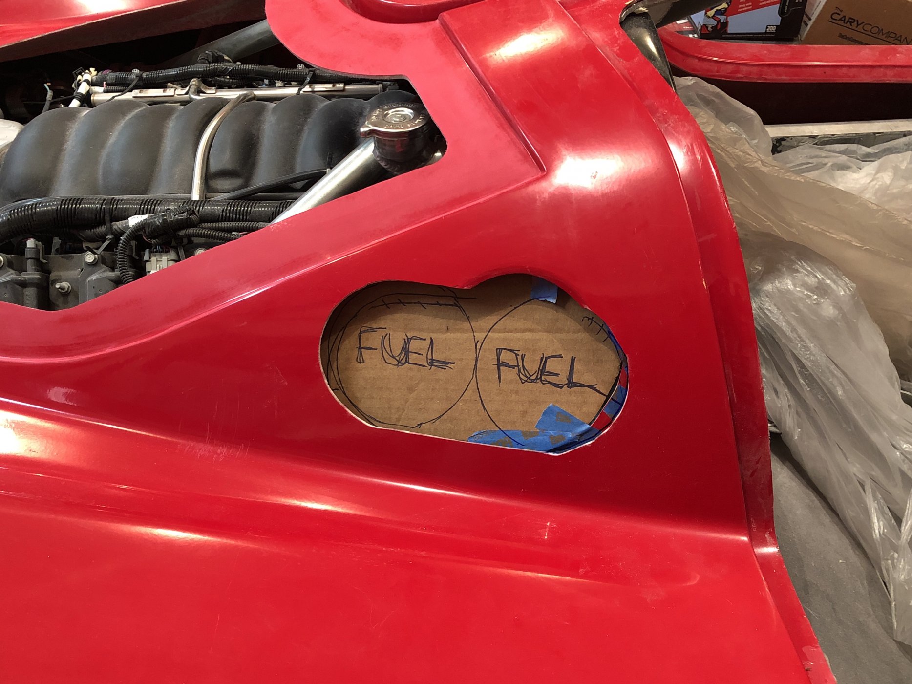

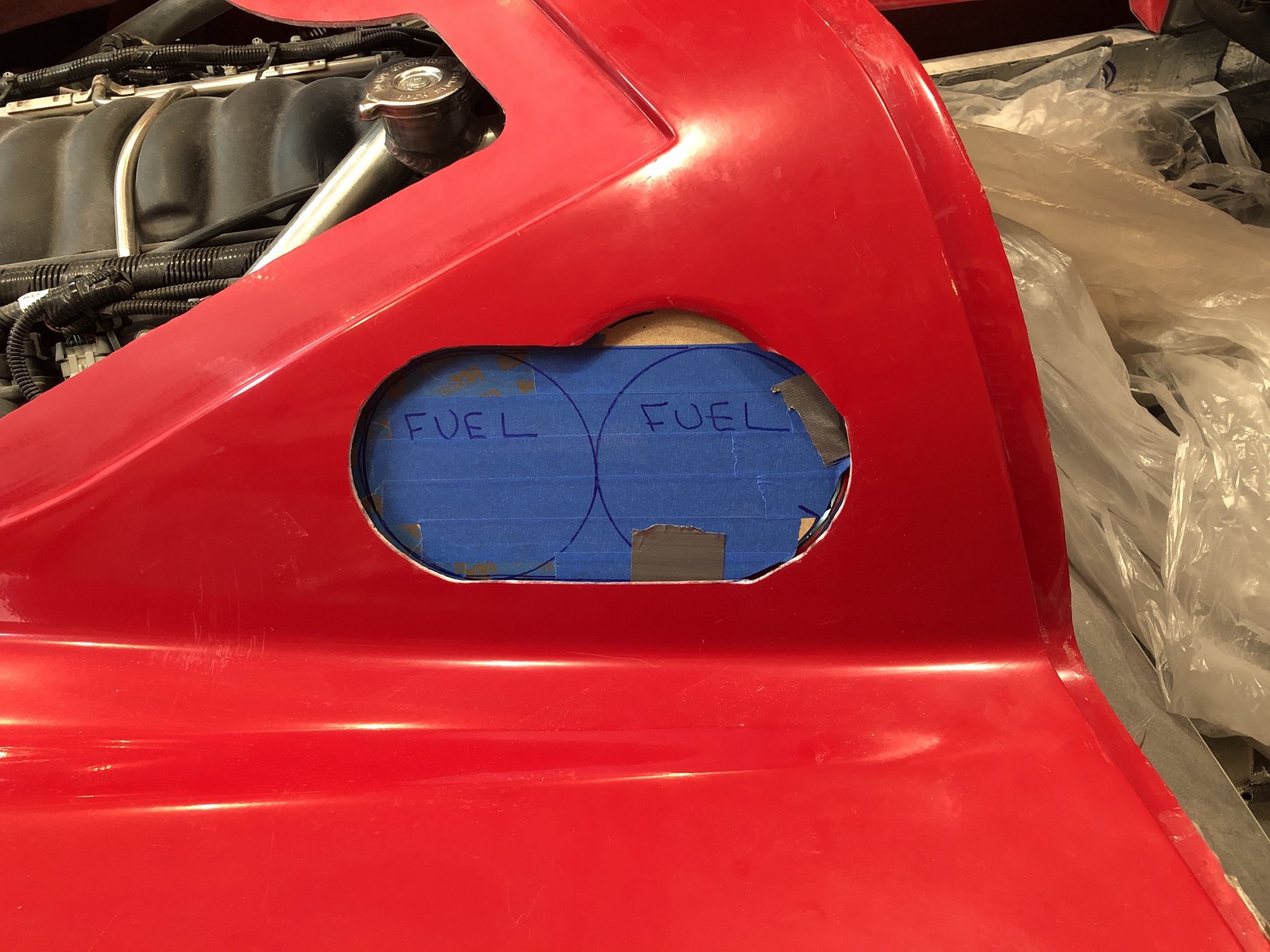

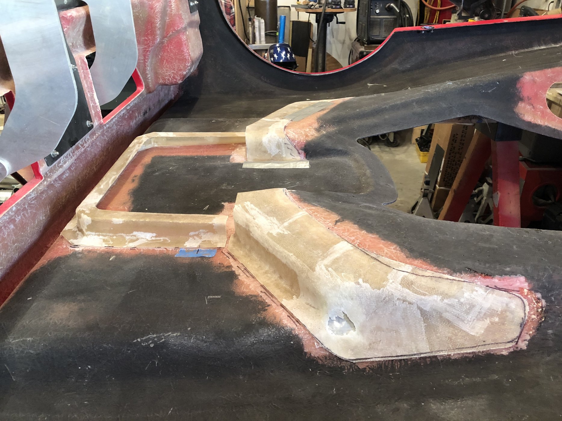

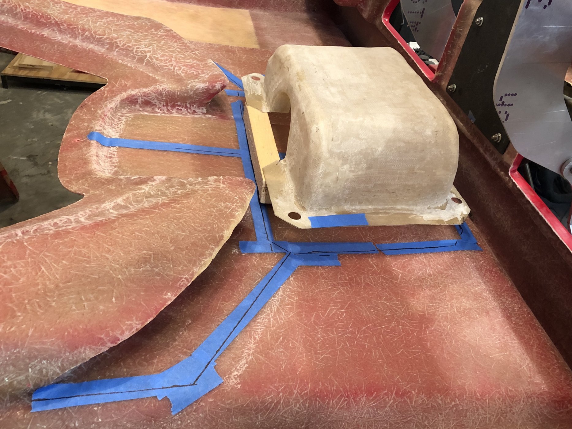

Soo... I want a dry-break appearing fuel inlet. This requires a modification of the main body as well as the rear clamshell. I created a mold in order to extend the main body.

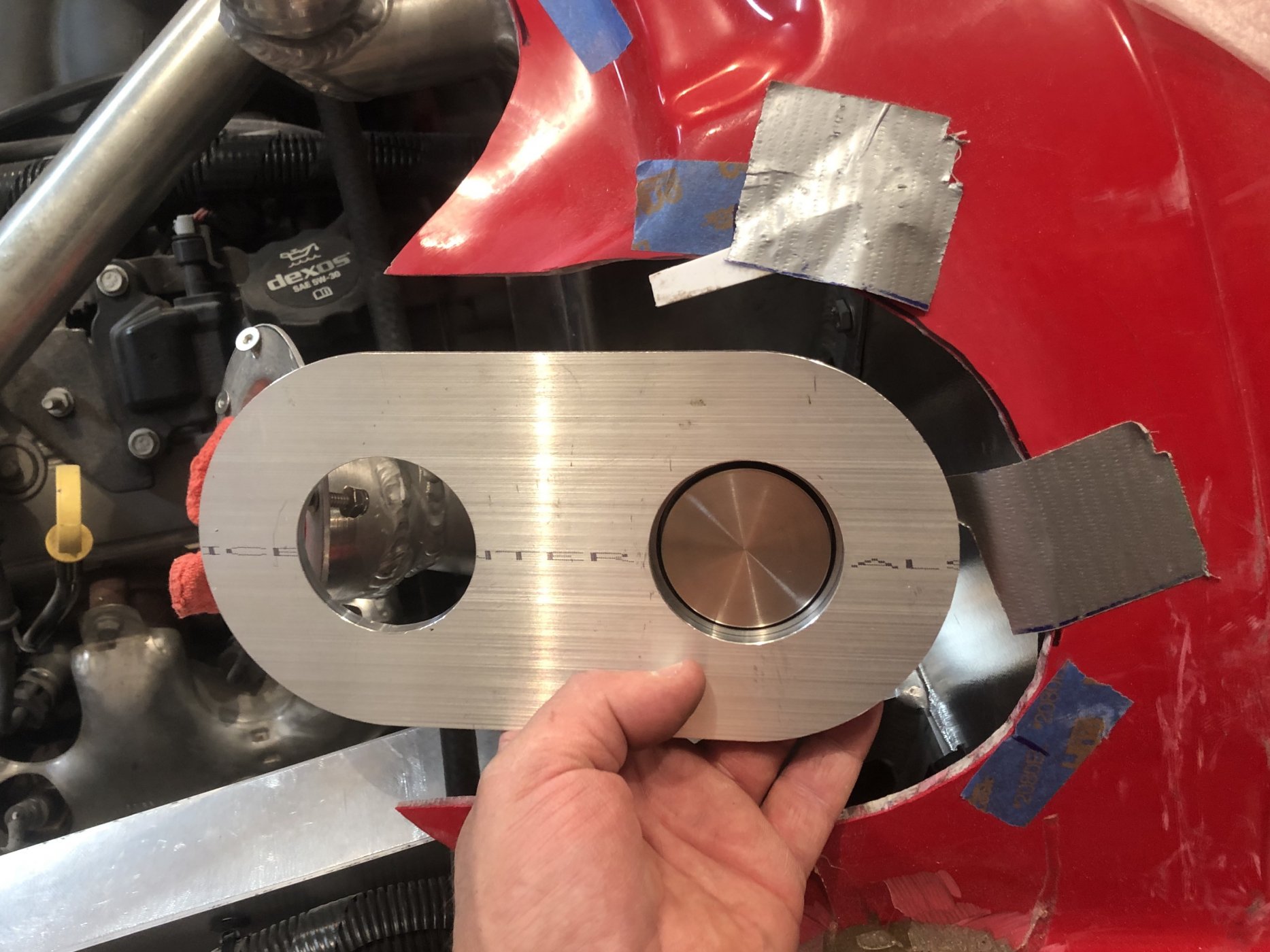

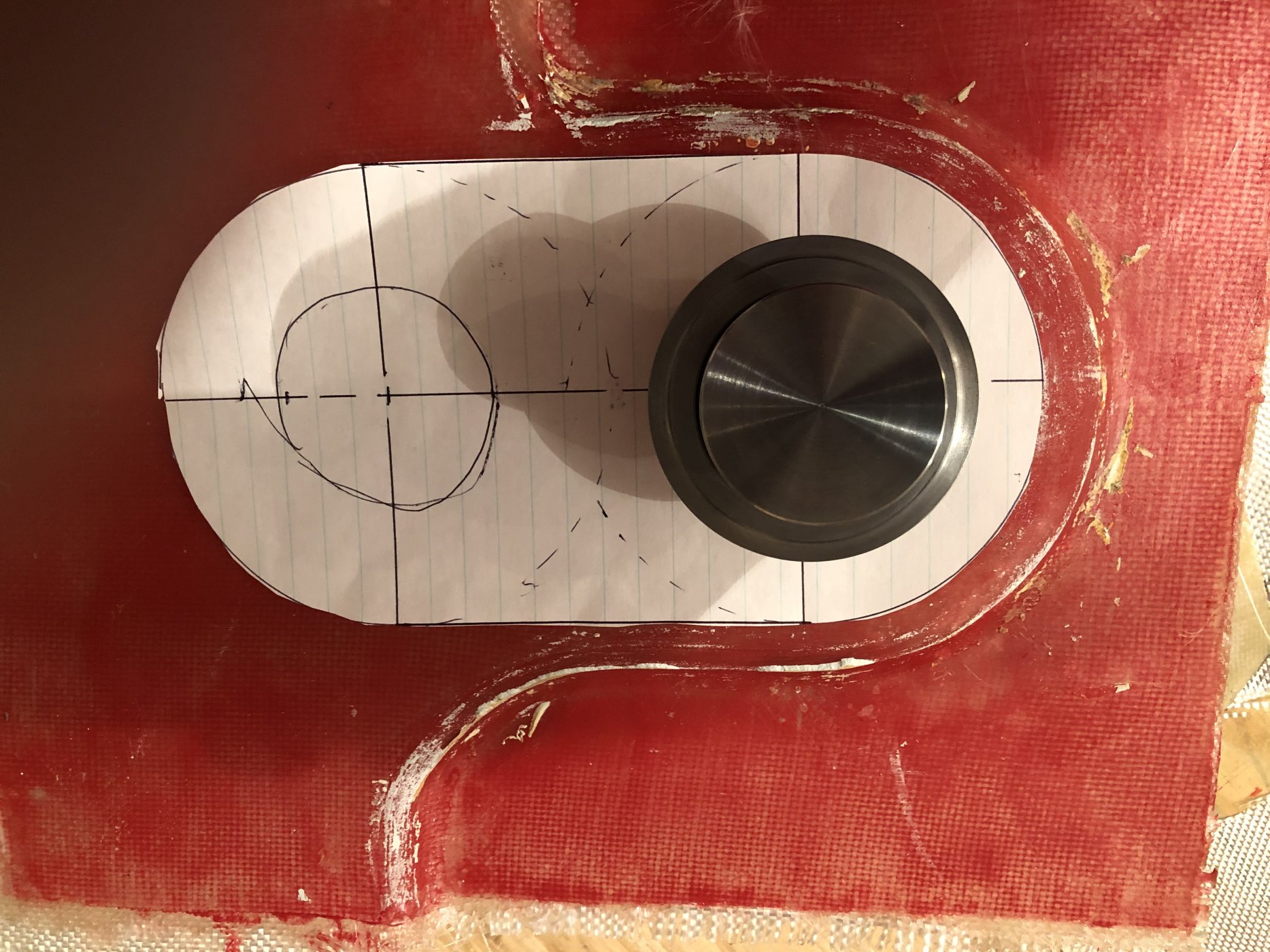

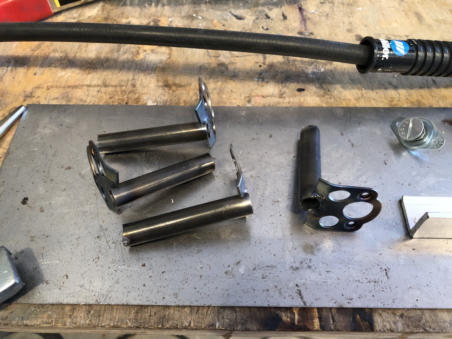

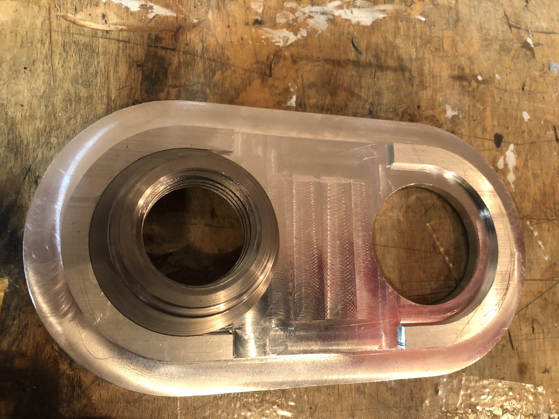

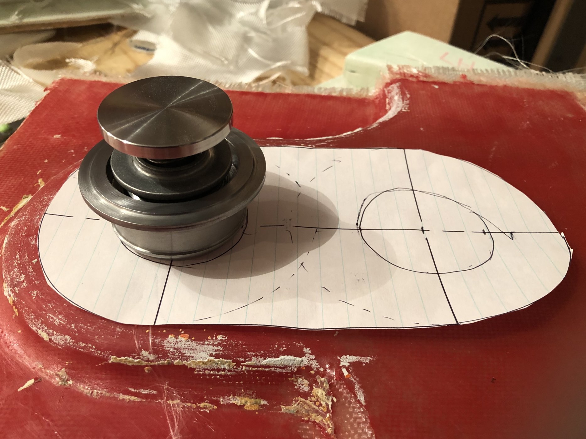

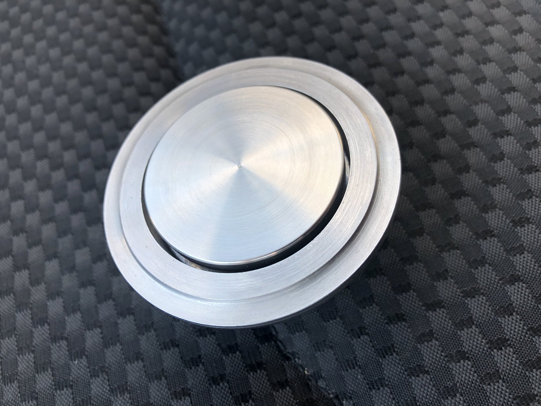

I’m collecting parts and making the aluminum face panel.. I’m using a flush mounted fuel filler for a motorcycle application.

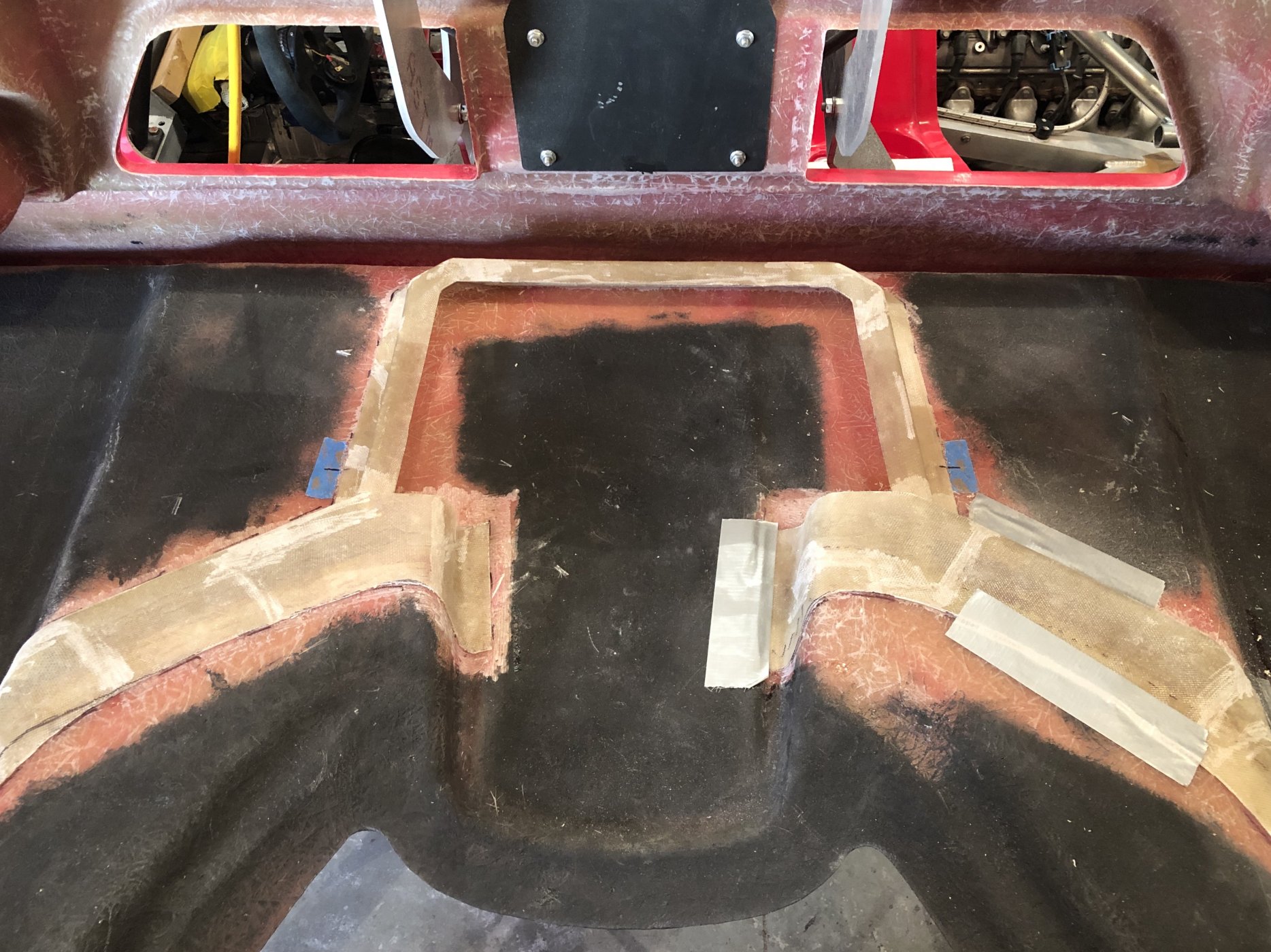

I’m back on the SL-C.. My home projects are all caught up and I’ve been building parts for the car.. The rear inner fender panels are made and ready to bond to the body. Today I was working on smoothing out the front of the doors where the hinges mount. If you look back in my build log I created inserts for the front portion of the doors to thicken them and make them more rigid. I hope to go on the maiden drive yet this fall...
I've been knee deep in fiberglass every evening.. I want to thank everyone else that can feel my pain. o_O Maybe Fran will ask for the communities opinions on SL-C changes and updates? I know that we all have a list that we can provide to him if he asks...

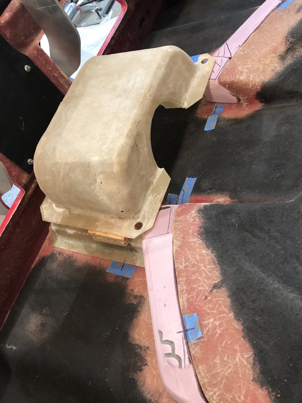

I test fit the rear inner fender panels that I've created and I plan to bond them into the rear clam very soon. I finished the fiberglass on the air box and I'm thinking of gel coating it on both the inner and outer surface. The dual fuel inlet main body mod is all prepped and ready for final fiberglass. I'm still planning a drive in August or September.
