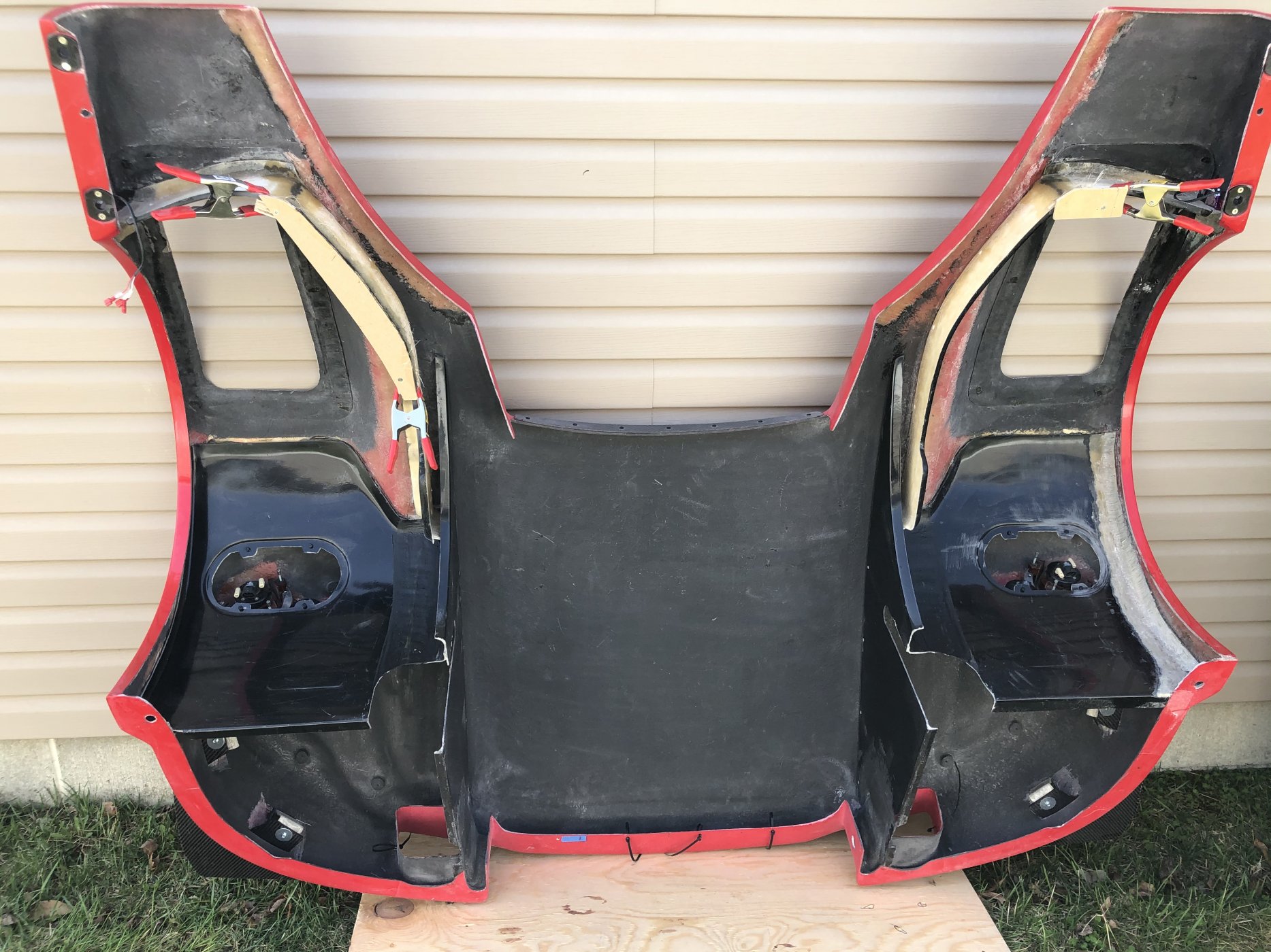

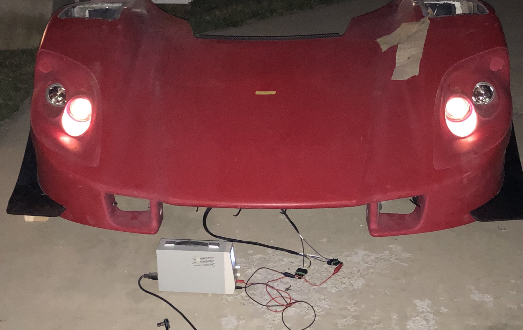

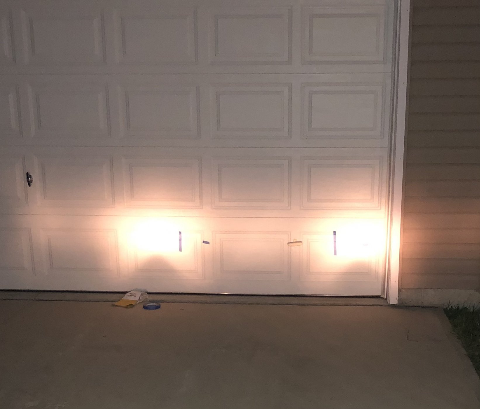

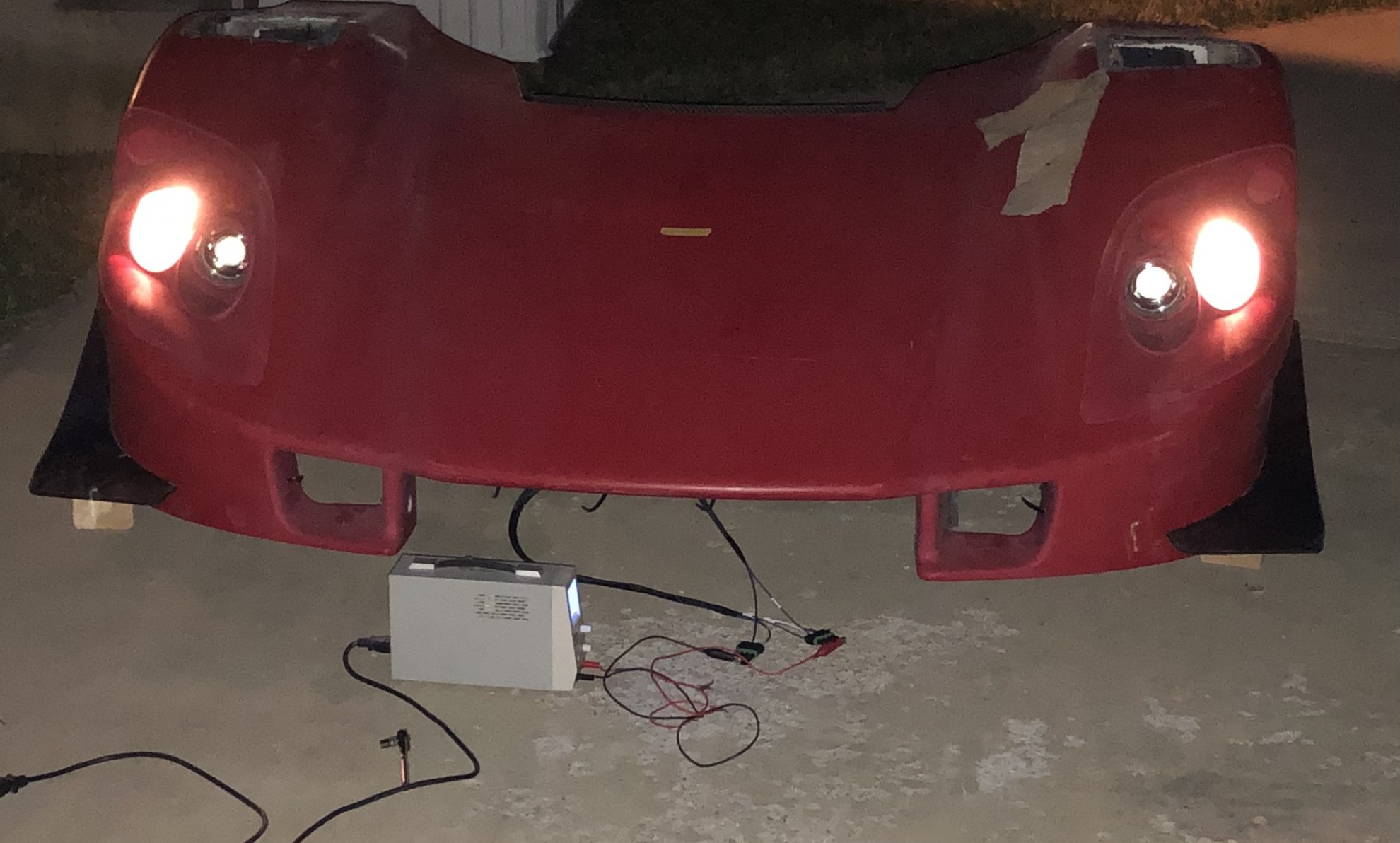

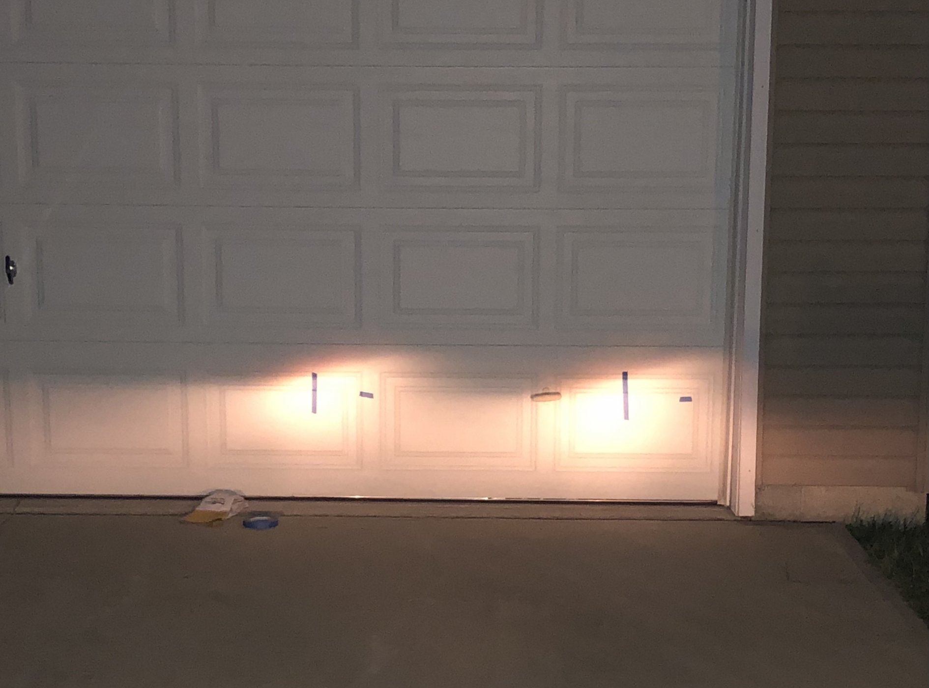

Kyle.. I haven’t really shared the specifics of my headlight mounts. I created aluminum mounts that pinch the factory RCR fiberglass headlight mounting flanges. Basically mounting the headlight adjusters into the fiberglass mounts is not a long life solution. that’s going to provide you with a good long-term result. I plan to drive mine all of the time including at night..
Nice upgrade. Looks like a part that could be 3d printed in ABS, perhaps with some mild beefing up.

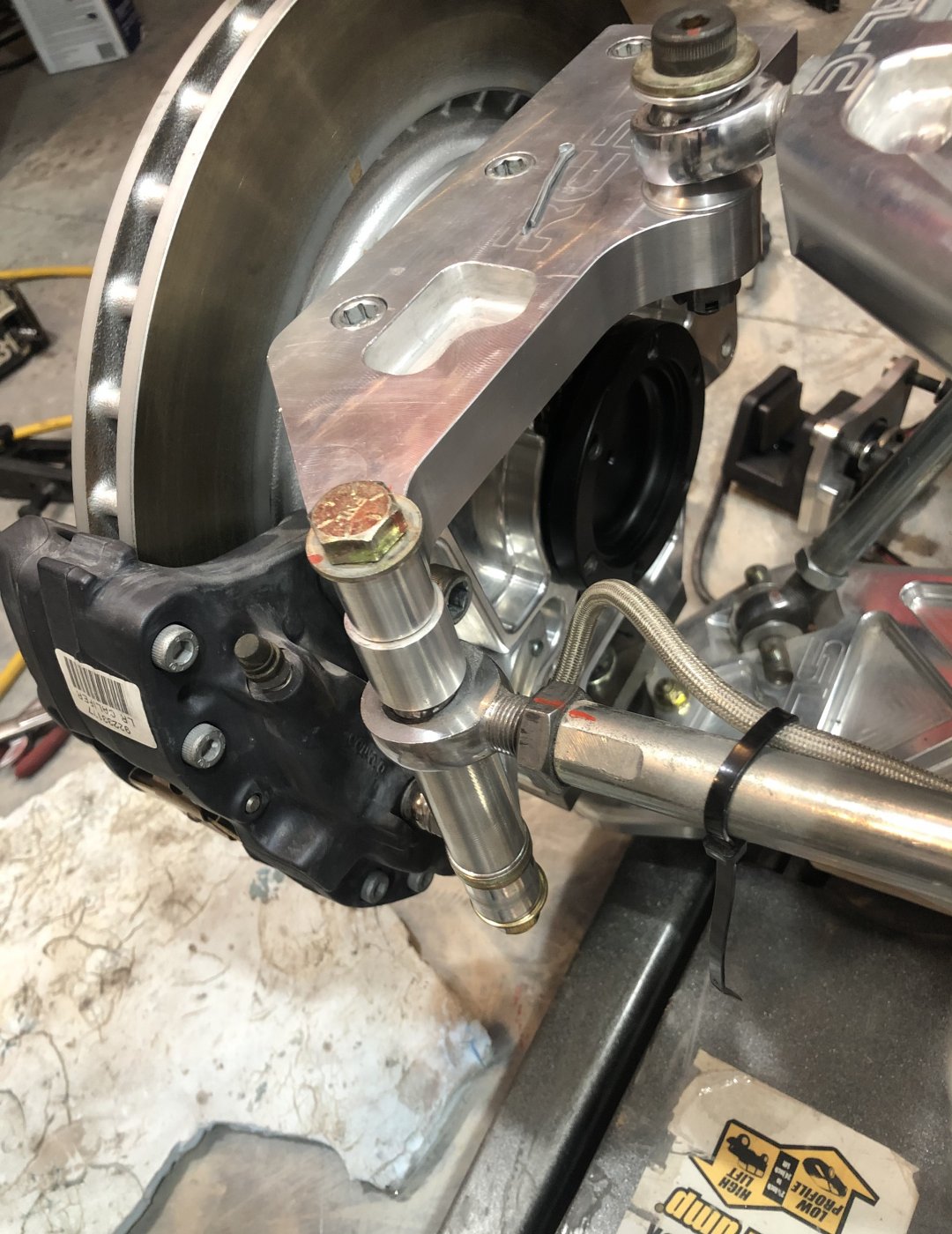

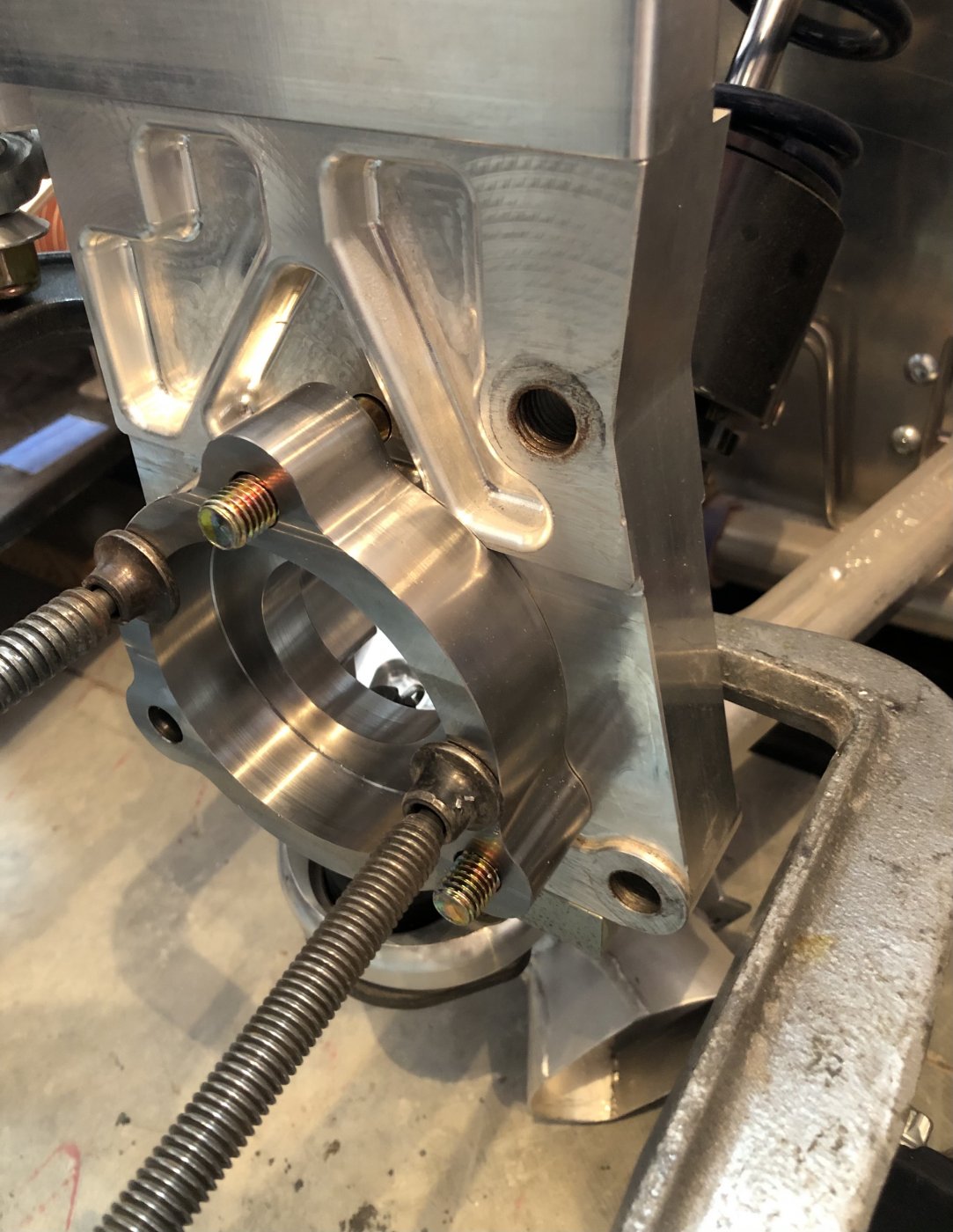

I received my C7 front hub adaptors yesterday and worked on installing those parts.
Howard Jones
Aaron, would you please post the above pictures and your adapter source link on:
I am trying to keep all this information in one place, Thanks!

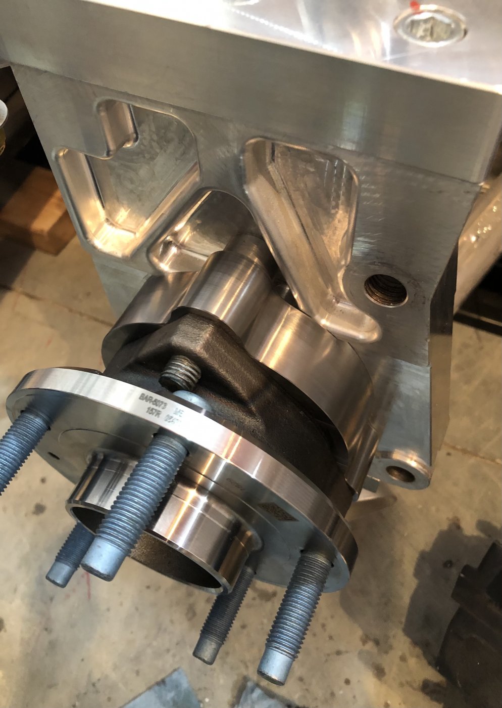

I’m making spacers for the rear C7 hubs. I plan to have the C7 hubs installed this weekend..

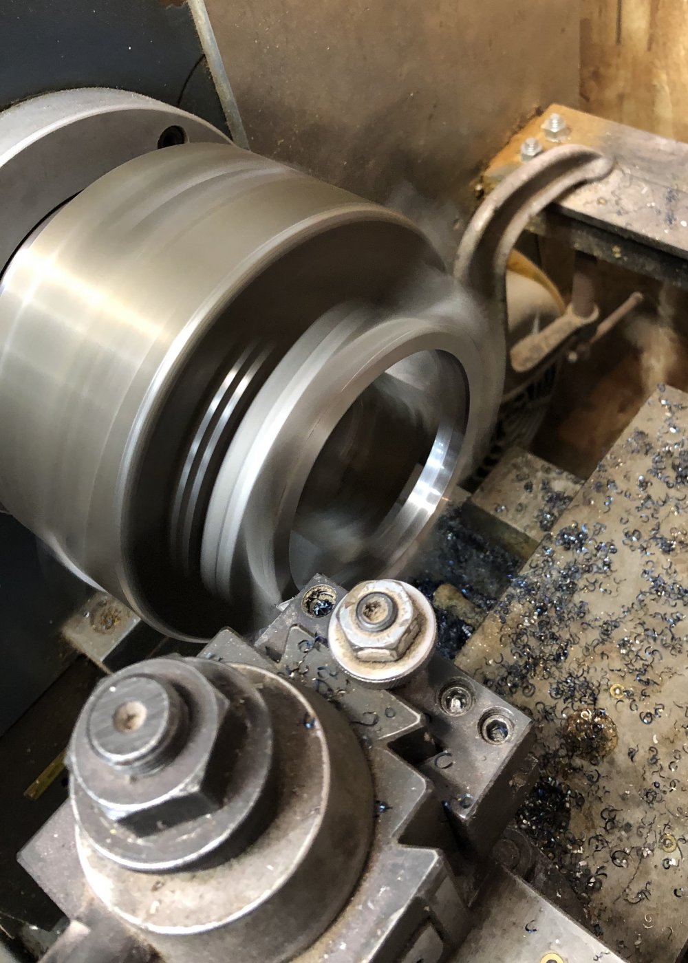

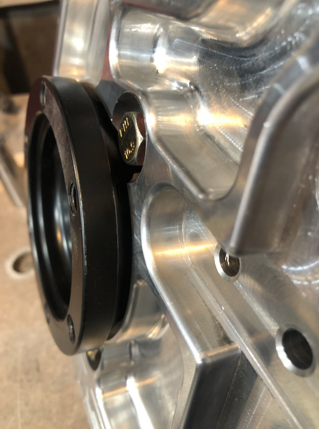

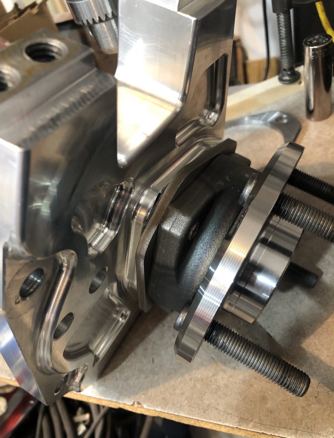

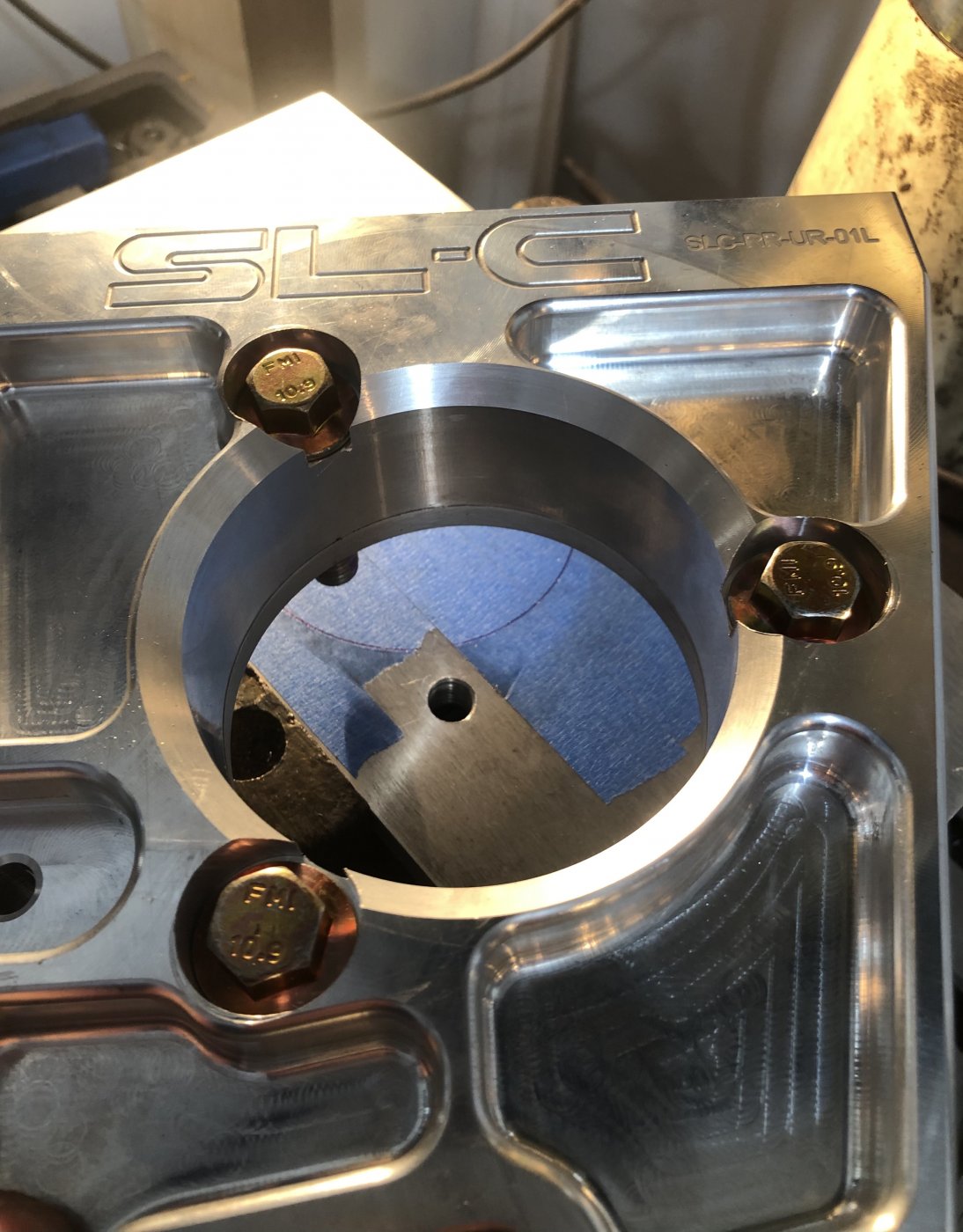

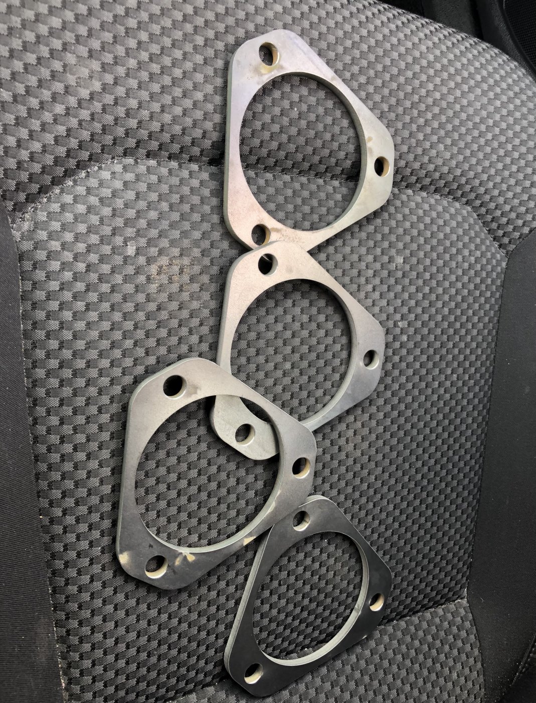

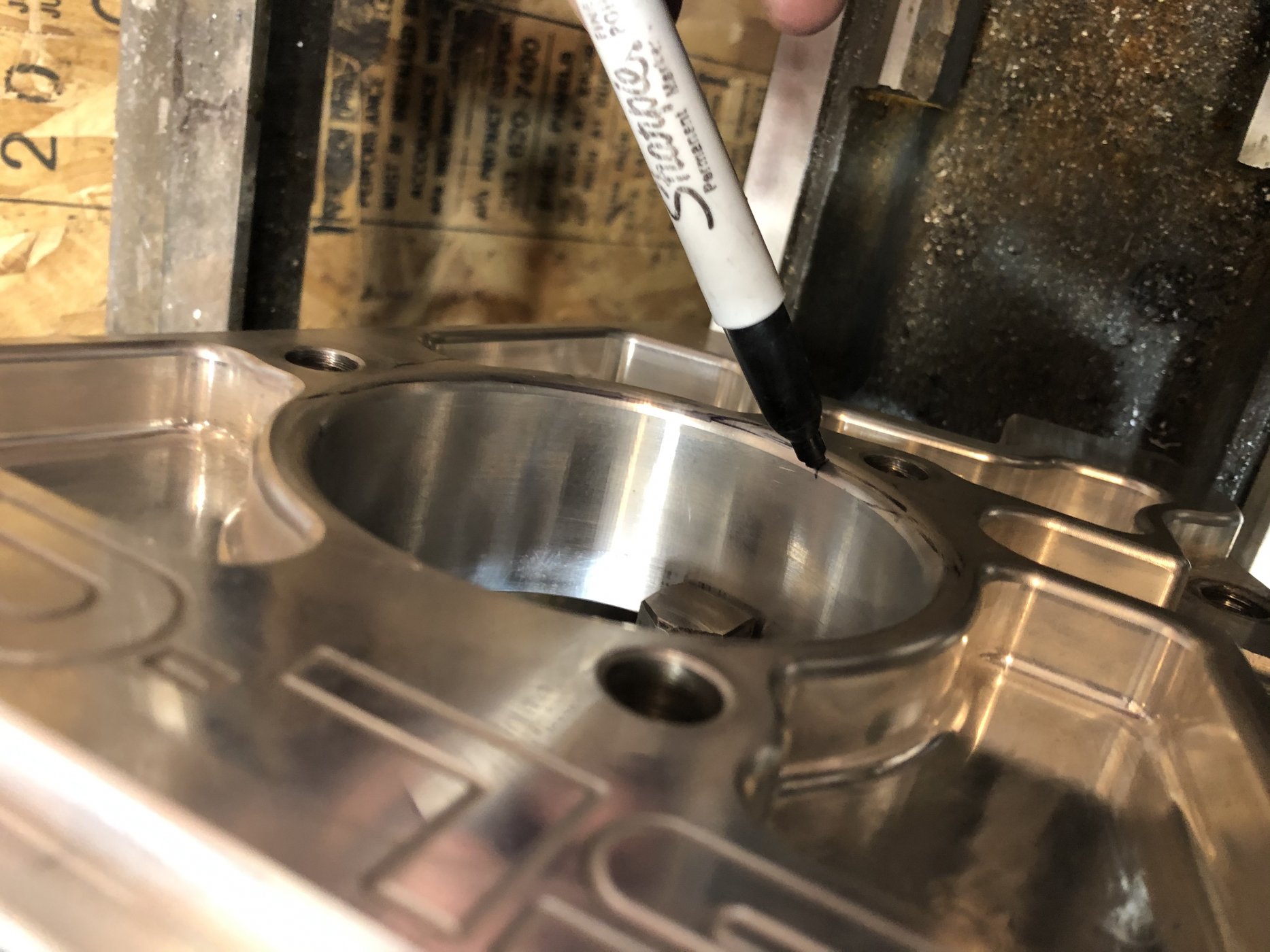

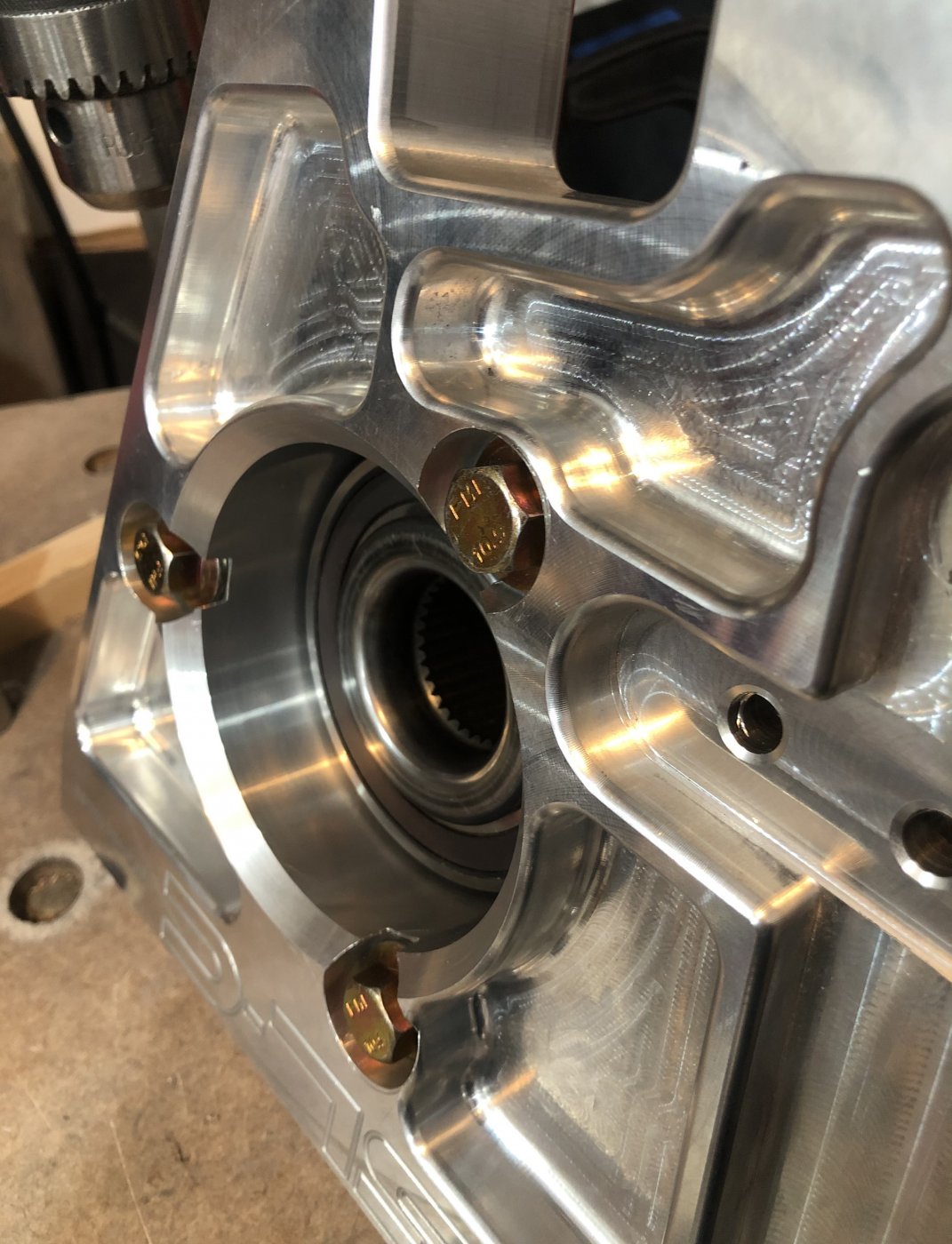

As promised I’m going to go through the modification to the rear uprights to convert to C7 hubs. Modifying the rear uprights is actually more labor-intensive than the conversion for the front suspension.
I’m using SKF X-Tracker C7 style hubs with driveshaft shop 33 spline stub axles.
Keep in mind that your axle shaft assemblies will be roughly an inch too short after this modification and you’ll have to order new axle shafts...
1). The rear uprights must be removed so that the backside can be chamfered to clear the new stub axle’s. I did this in my lathe.
2). Additionally the hole pattern for attaching the C7 hub to the upright is a smaller diameter so new holes need to be milled.
3). I milled out a 1“ x 5/16“ deep counterbore for the flange head M12 x 55 mm long bolts.
4). I also created 0.205” thick spacers. The spacers are needed to correctly match the C7 hub offset so that the brake rotor lines up with the caliper.
Everything fits and the complete modification for the rear hubs plus installation took me 16 hours. This time included disassembly and reassembly along with making a fixture plate so that I can modify other uprights in the future if you guys want this modification.
