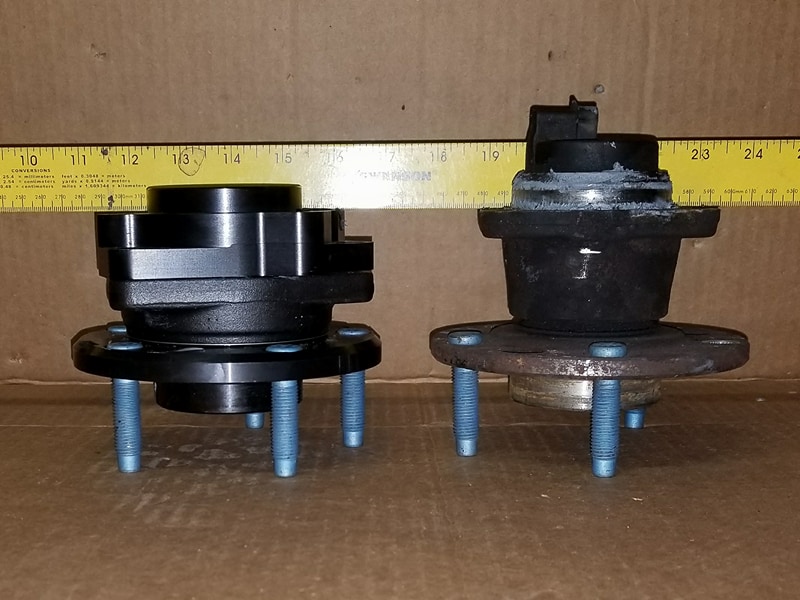

The fronts are from a C4 Corvette. There is no heavy duty version available in a C4 Corvette size. You can use a C5/C6 wheel bearing in the front with a chromoly adapter. The adapters are very expensive. I am using them with SKF X Tracker C5/C6 hubs. These are the same hubs that were developed for the ZR1 by SKF. They now make them for C5 and C6 Corvettes as well. The ZR1 hubs have a 33 spline count and use a active sensor. SKF then came out with a 30 spline count hub with a passive sensor to accommodate track enthusiasts with early C5s and C6s up to early 2009. Hoosier Performance was selling a rebuildable heavy duty replacement setup for the front hubs but they closed their doors in January. Scott Swartz is using them.

The SKF X Tracker hubs will help solve the front hub problem. It's an expensive initial price but it can aid in keeping you and your car out of harms way. I just bought a whole complete second set for my next RCR car. The Chromoly adapters are about $470 for the pair and the X Tracker C6 hubs are about $720 for the pair.
The enthusiasts tracking their cars with them say you go from changing the hubs out from 2 to 3 times per season to once every two or three seasons. There is noticeable less pad knock back as well.

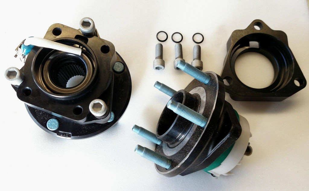

Ken, so I found these guys. Same thing right. They sell the whole deal all together here:
Strano Performance Parts - Part Details
So that would solve the fronts. At least to a point, something like bearing change once a season.
So 5 track weekends @ 10 days @ 200 miles per day = 2000 miles a year. The X Trackers can be found for a bit over $350 each now or $1400 a year. Basically another set of tires, more or less in annual cost. That would be OK for me.
Now we need to figure out how to get them on the rear. I thinking we need a updated upright, stub-shaft (correct spline count), and the bearing per side. Right?

I have no experience with these adapters from Strano. They are approximately the same price for the pair. He copied the design from the guy who sells/manufactures the ones I'm using. From the pictures I see an issue with his design on our uprights (see my post #592 in my build log). The Strano adapter has a more pronounced curve in this area and would require the SLC upright to have more material removed to compensate. Stick with the ones I talk about in post #591 of my build thread. https://www.gt40s.com/threads/kens-slc-build-thread.38446/page-30#post-50859

The SKF X Tracker hubs are available in two models. They both have splined drives in them for use on the rear as well as the front. The C5/C6 model up to early 09 uses a 30 spline hub with a passive sensor. The later 09 and up C6 use a 33 spline drive and active sensor. The later C6 Corvettes switched to a Bosch style active ABS setup and better axles. If you don't care about using the built in speed sensors whether passive or active then your cheapest option might be to buy a OEM GM part number ZR1 front or rear hub. They are the SKF X tracker hub that started it all. I believe I saw them being sold on Rock Auto for much less than the $370 version we are discussing.
If I had to choose I would go with the model with the passive sensor in case you upgrade to some kind of traction control in the future. That is unless you are going to run some kind of aftermarket standalone ABS system like the Bosch which uses a active sensor or some type of engine control system that uses a active sensor for built in traction control like Motec.
If none of this is a concern than order any one of the two. Just cut the wires off the hubs.
