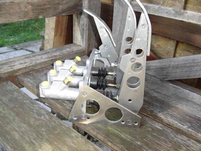

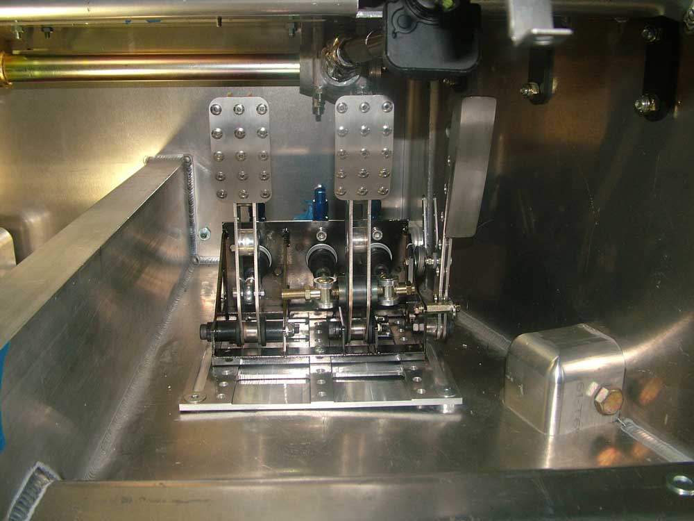

This is the "home made" pedal box I installed in my scratchbuilt GT40 , with some adjustment capability ; not very friendly adjustable ....but may give some ideas ....
Rene

Thanks but what I was looking to do was move the whole pedal box approximately 100 mm closer to the driver in various amounts
The GT40 cockpit is not very big and moving the driver closer to the front 100 mm doesn't look like a good option.
I'd prefer to have the seat position fixed at the rear and have the steering wheel (already sorted) and the pedal box come closer to the driver.
This car will see mostly road driving so it must be a good engineering solution for engineering approval to get it registered.
regards
Kevin B

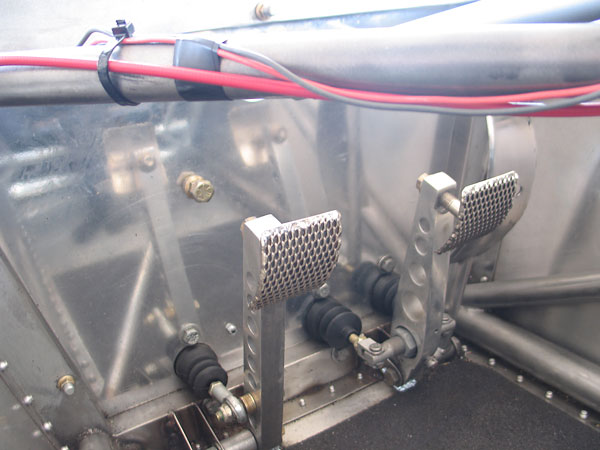

Just my 2c worth but have you considered adjustable pads on the pedals? The technique is described in the great Carroll Smiths books.
Making the whole pedal assembly slide may prove to be quite complex, as opposed to simply winding the pad in & out as required. You won't need to worry about complex plumbing & cabling & you won't affect the pedal ratio's either. I found an example photo on Paul Dudiak's McKee Mk12c Formula A / Formula 5000 Racecar
I hope this helps?

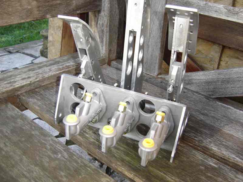

The attached pictures are from Jason Ferraro's build.
I like the concept but would like to develop it further so rather than removing bolts to shift the pedal box assembly, maybe some other mechanism could be used to shift and lock the pedal assembly.
In my case I will not be only one driving and I'm not keen on having to crawl into foot well every time I want to adjust the position.
I have also followed Jason's idea of using an adjustable column from a late model FG falcon (ADR compliant)
For the uninitiated ADR is Australian Design Rules (new vehicle compliance) alias Australian Dopey Rules.
regards
KevinB
